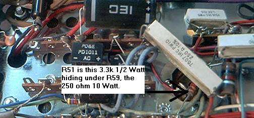

Loss of mike audio from a failed mode selector usually starts with a burned resistor R51.
The contacts are placed so close together on the insulating wafer that the insulation will break down and leak high voltage into low-voltage circuits causing mayhem.
And if your R51 has bright, shiny orange-orange-red color bands, it's not part of the problem.
It's the most common failure we see caused by the inevitable breakdown of the brown bakelite insulation on the mode selector. Might not be causing your fault. Worth a look.

Thank you very much for that comment I wondered how the mode switch actually broke down now I understand how by your comment, now I know even if there is continuity where there should be there can still be voltage leaking in that shouldn't be ! And I will also look at R51 closely and see
