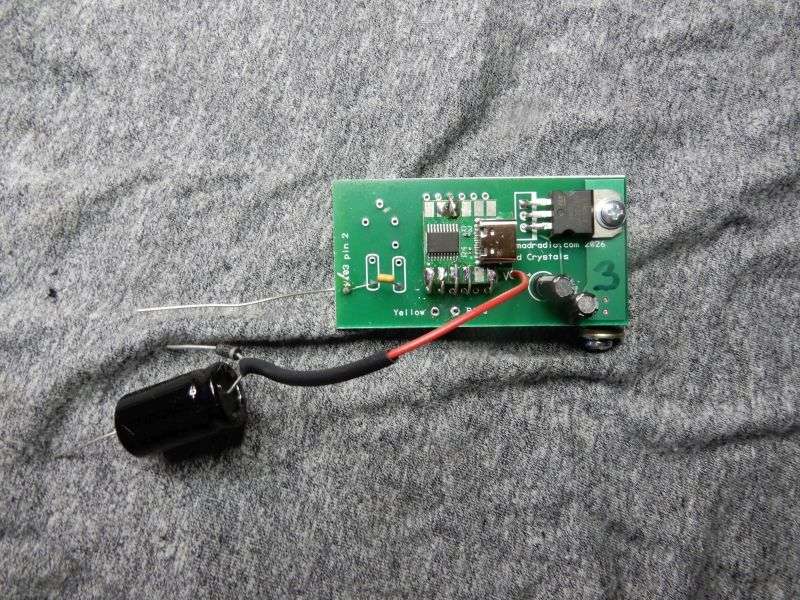

Adapting the ProgRock module to the Browning Mark 3 receiver is a bit more involved than the Mark 4A receiver. To start, it needs to rectify and filter its own source of DC power. Not a big deal, the rectifier diode taps the 6.3 Volt AC heater power. The filter cap gets the negative lead grounded.
It mounts in one of the vent holes in the deck. Flat washers keep the nut from falling through the hole.

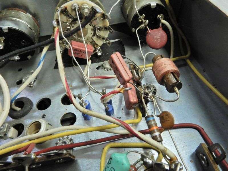

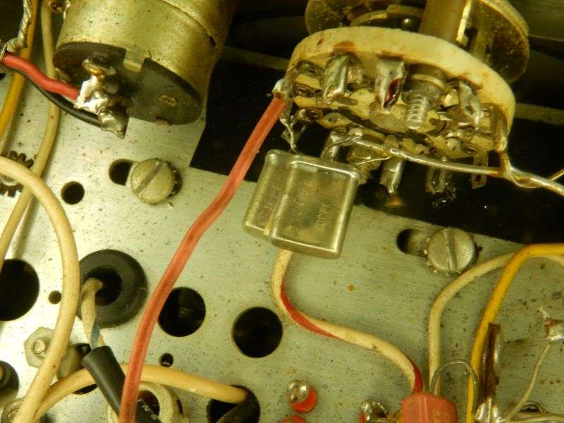

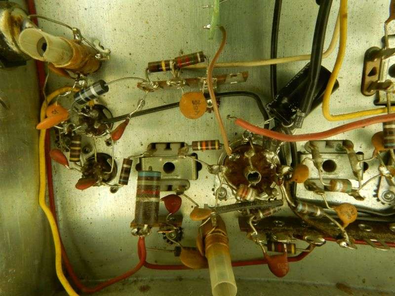

There are two molded-mica capacitors on the rear of the CB/Xtal switch. They are C51A and C52B. They get switched out of circuit for crystals, and switched into the circuit for a tuneable band.
We need to remove them from the selector and hard-wire the circuit for three tuneable bands. Here's the before pic.
C52B is the easy one, it has one lead connected to the ground lug of the tie strip to the right of the selector. C52B gets unhooked from the selector. There is a white/red wire leading to the rear-most lug of the adjacent tie strip. The wire gets unhooked from the tie strip, and the loose end of C52B gets soldered to the lug in place of the white/red wire. This places it directly in parallel with L6, the fat 1 mHy RF choke.

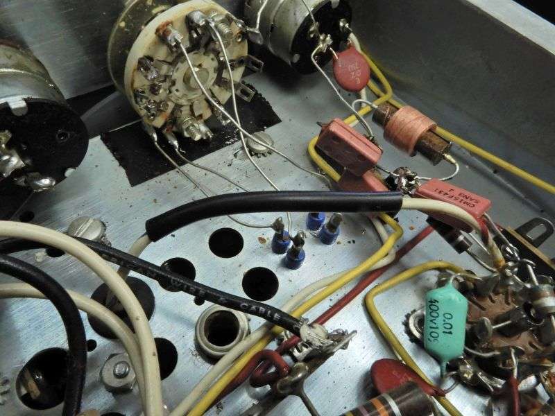

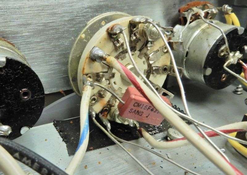

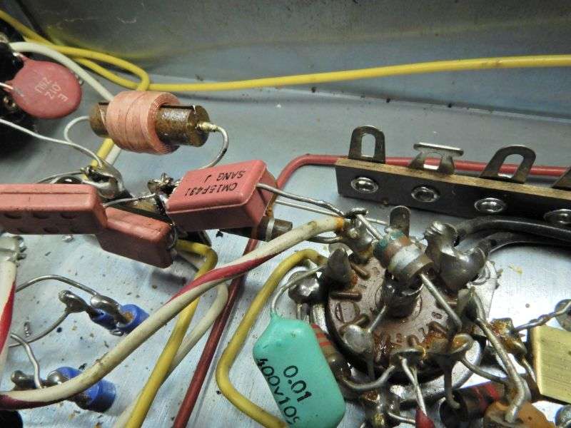

The next part is a it more fiddly. C51A has to come loose from the selector. Doing this without breaking off a lead wire is easier said than done.
Assuming it came away in one piece, solder one end of C51A to the rear-most end of the 3-terminal tie strip next to V4.
Solder the other end of C51A to pin 2 of V4. There's another white/red wire also on that pin of V4.

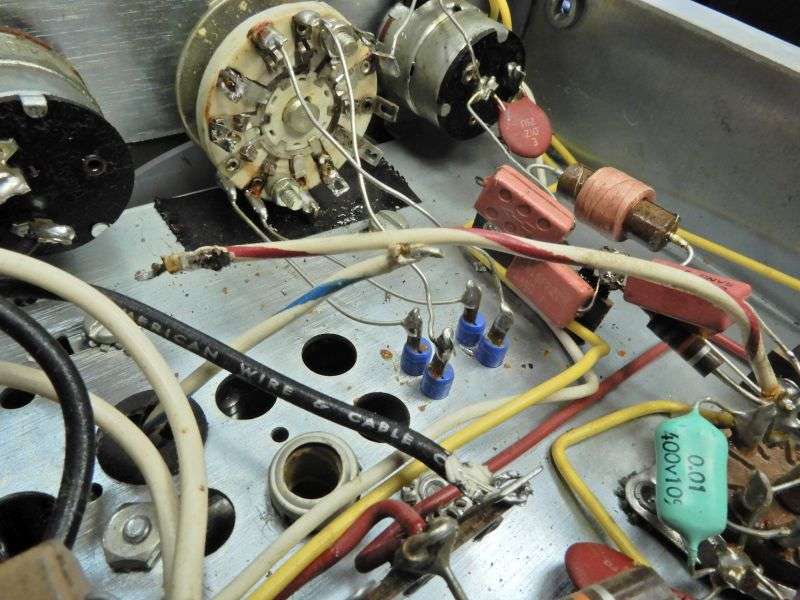

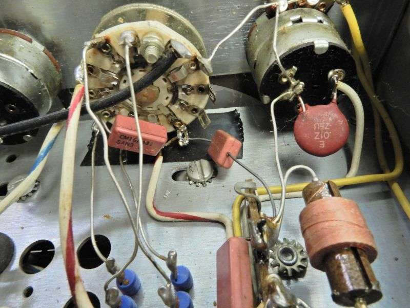

I'll be packing a 430pf silver-mica cap with the kit for this mod. Dial calibration will be thrown off less by using the original capacitor. And if a leg breaks off, including a 430pf cap in the kit will prevent tragedy.

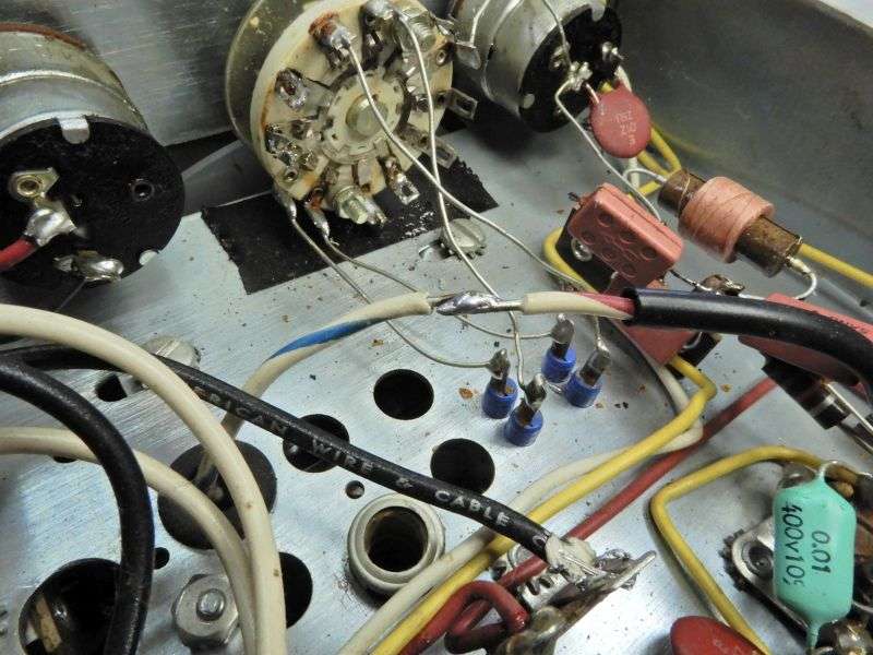

The white/red wire from V4 pin 2 gets cut loose from the selector. It was unsoldered in the pic, but clipping it next to the selector is easier. The white/blue wire leading to the slug-tuned coil L5 on the top side of the chassis also gets cut.
They get shortened and stripped to get lap-soldered together. This is why you don't need to unsolder them from the selector. You'll have plenty of length just clipping them loose.
Naturally the splice should get insulated.

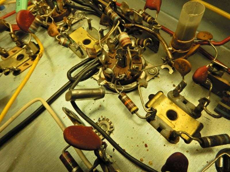

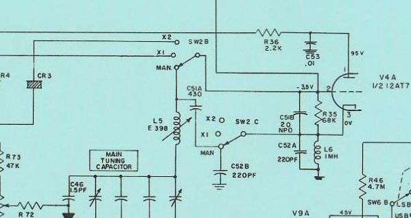

Oddly enough the schematic calls this 31.4 MHz crystal "CR".
It comes completely loose from V3 pin 2.

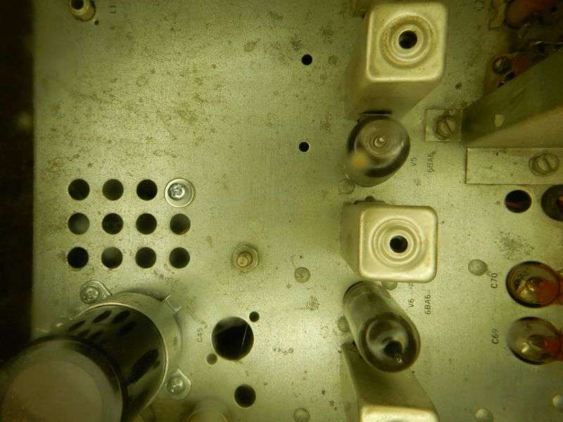

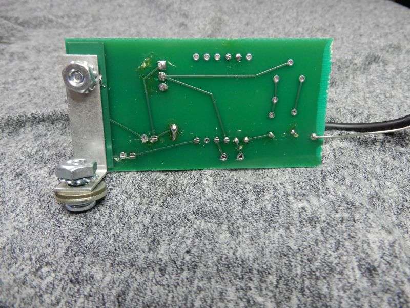

The module gets bolted to the underside of the chassis in the front-outer side vent hole.

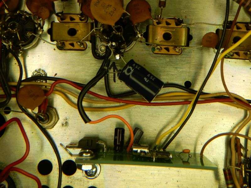

The ProgRock board gets mounted in a single vent hole, with a flat washer on top and bottom side of the chassis. This pic shows the red power lead with the rectifier on pin 3 of V5 and the filter cap grounded to the tube's mount saddle.
This vent hole.

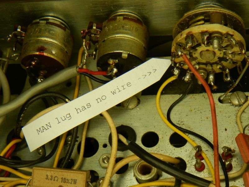

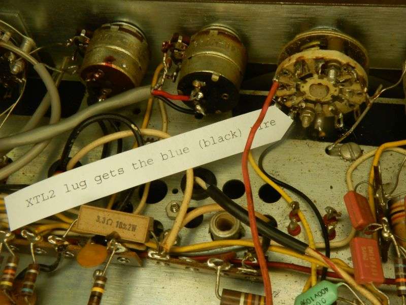

If your receiver is the old one, and never was converted to hear above channel 26, you won't have this long wire from the selector back to V3 pin 2. If so, you need to add a ground wire from the common lug seen here with the red wire on it.
This also demonstrates that an adapter board that selects three output frequencies only needs two wires to do this. The switch contact for the "Tun" or "CB" position of the switch has no connection on it.

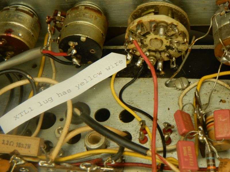

There should be a yellow and a blue wire on the module that will reach to the front panel, and this switch. The yellow wire serves to select the "HF" or "XT1" center position of the switch. This will now cover channels 28 to 59.
The lower channels are on the far-right click of the selector. A black wire serves in place of a blue wire today. I misplaced the spool of blue hookup wire.
