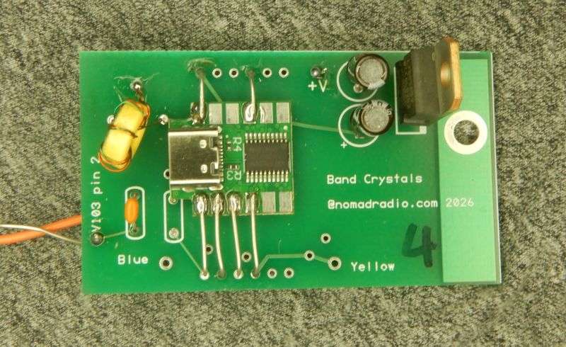

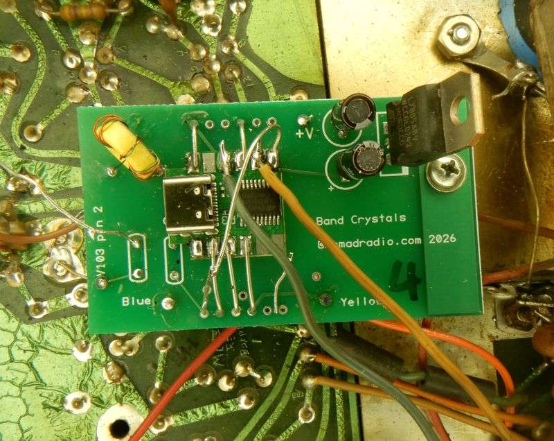

That's how this prototype played out. First, I wanted to mount it with the right-angle header pins, like on the perf board.
First problem. I made the 12 holes too small for the header pins.
Well, no big deal. I'll just use wire jumpers. Only needs six for my application.
Just one problem. I decided that the USB socket would be blocked by the voltage regulator, so I turned it the other way. And screwed up which side gets which connections.
So the connections got kluged to where they should have gone.
Good news is that it works.
But the two-to-one output-voltage step-up doesn't. Core is T38-6. It has five turns twisted to make it a transmission-line transformer. RF voltage into the tube grid is slightly less than a direct connection.
At least it's not "cut four times".
Decided I like the jumper wires better than the header pins after all. They take up less space, so the next version can be smaller.
Some time betwen now and when the next iteration arrives I should try it in a Mark 3 receiver. And maybe figure out why the toroid didn't get me a drive-voltage step up.
The TO-220 voltage regulator looks like overkill, but the tiny TO-92 regulator I used at first was getting too warm for my tastes. Putting the covers on the radio would probably have pushed it from "warm" to "too hot". These days, the price is typically the same for either size regulator.
Bact to the drawing board.

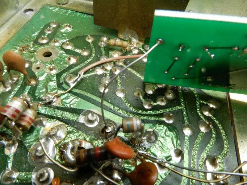

Hookup to the mixer tube is just a wire jumper now. No more flying capacitor.

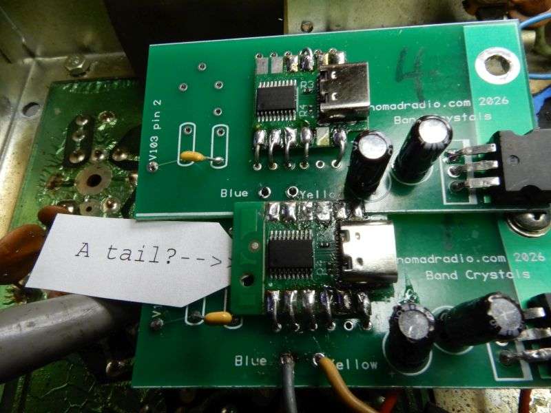

Did discover an odd quirk in the next batch of the ProgRock modules I bought. The one on the top is from the first batch. The one below it has an odd "tail" on the left, not on the upper specimen. Won't affect how I use it, but this might make cramming it inside a HC/6U crystal can a bit cramped. Not an issue for me.

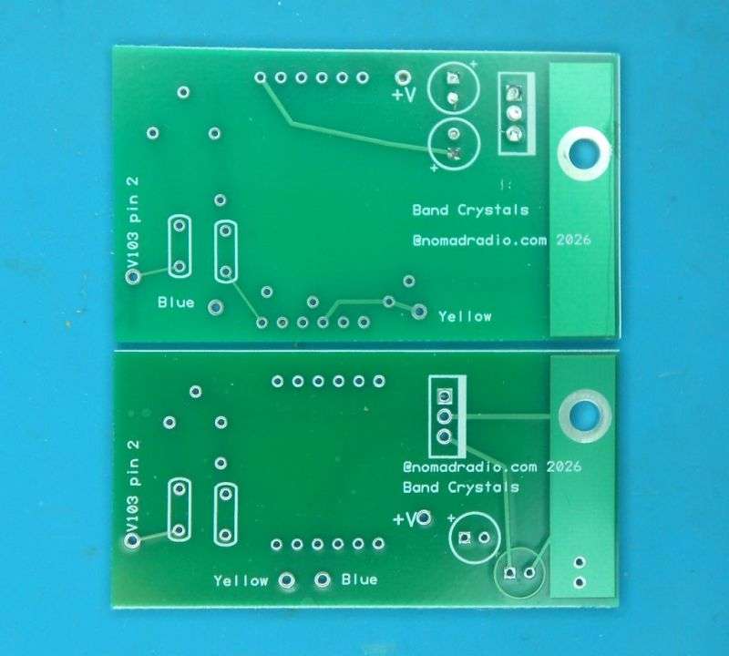

They say third time is charm. Figured version 3 would be refined enough to sell. Top one is version two. Lower is V3. Decided the 7805T regulator ran a bit too hot with no heat sink. Moved it around so it can be bolted to the pc board surface in the same hole used to mount the board and the bracket needed for the Mark 3 receiver. Not much of a heat sink but probably enough. Besides, I had labeled the wire colors for a Mark 4A receiver backwards.

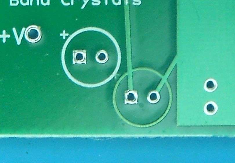

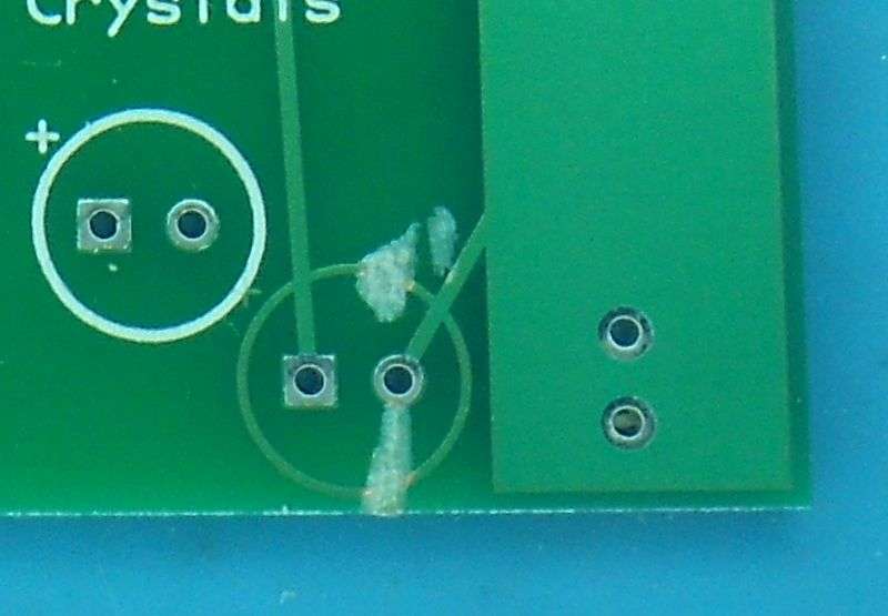

Just one problem. Have a squint at the lower-right of the two electrolytic caps. The outline should be printed in white screen-print ink, right?
What's wrong with this picture? I moved the two electrolytic caps from where the version two board had them. But the screen-print outline is foil, not ink.
Oops. In all fairness, this is the second bona-fide booboo I have gotten from Express PCB in 27 years. An excellent record in that sense, but I'll try to get them to re-spin this order done right. In the meantime, the Dremel fixed this issue just fine.

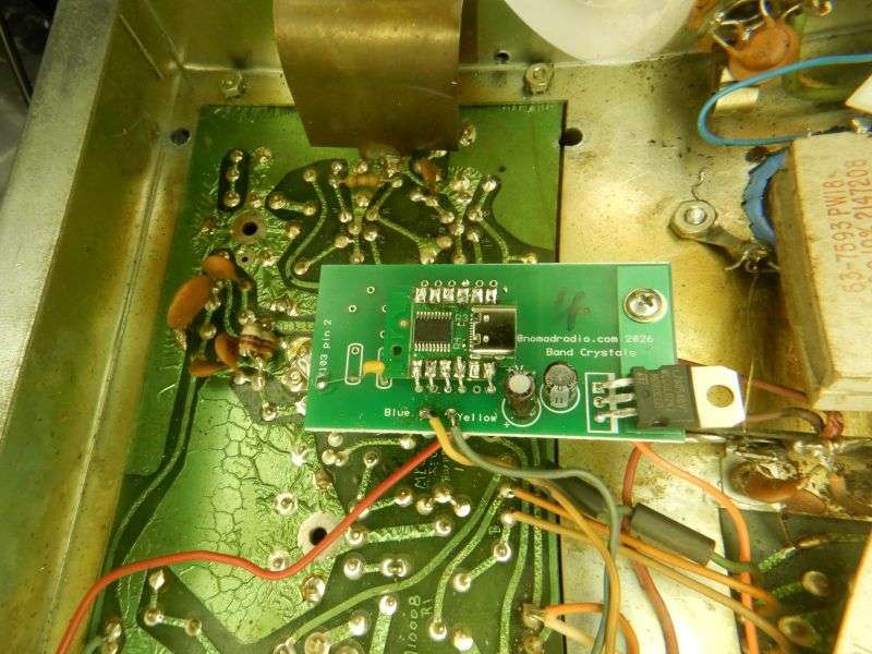

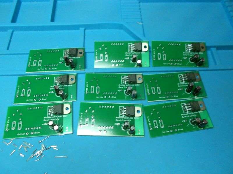

Tonight's evening shift was short, but it's progress. Got regulator and caps on all 9 prototype boards.
Told some folks about using it in a Browning receiver. So far some of them are sold before they're built. At least it's an incentive.
The Uniden SSB carrier crystal trick will have to wait until these are built. Can't wait too long, got one radio here that needs it.

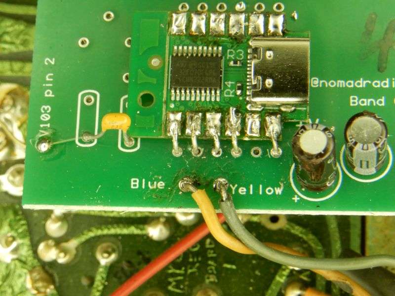

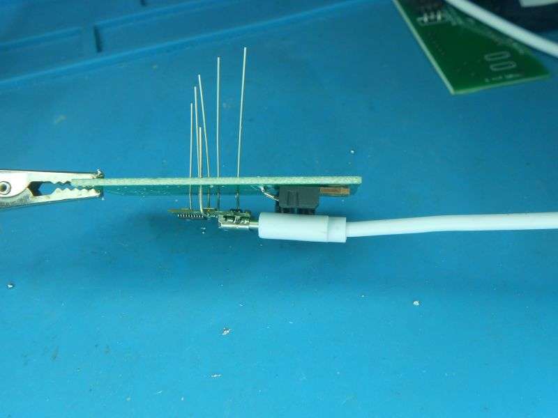

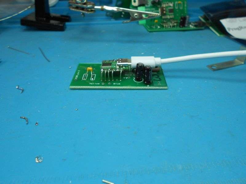

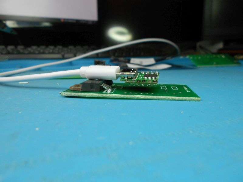

Another short late shift. But I did get the first one of them built.

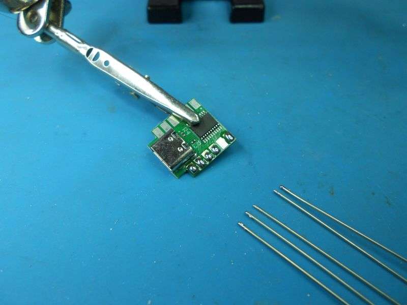

Helps to tin both the solder pads on the ProgRock and the wires connecting it to the pcb.
Turns out that when I moved the voltage regulator it's now in the way of the ProgRock's USB-C socket.
Oops. But not a show stopper. Just need to stand it up above the main board about a quarter inch.

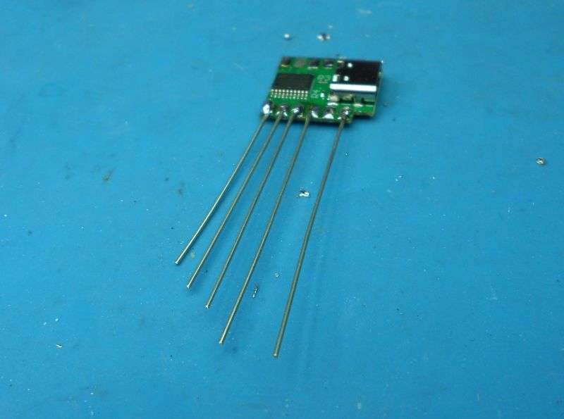

Making five wires all line up with the pcb holes is easier if the lengths are staggered. They can be inserted one at a time this way.
A gap of about a quarter inch between the pc boards makes the USB-C socket accessible.
It did occur to me that the components on the 'bottom' face of the ProgRock board will dissipate some heat. They will probably be more comfortable this way than they would plastered directly against the surface of my pcb. Wouldn't have thought of this on my own, but some air circulation is probably healthy, especially inside a tube-type radio.
Now to put it into a Mark 3 receiver, get pics of the process and put together directions to get it installed.
