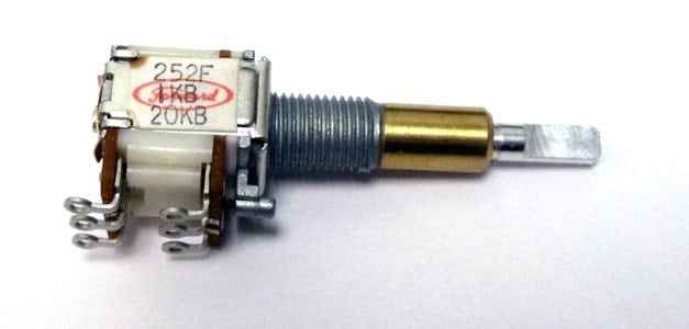

As more luck would have it, I also ran across this write up on the mod. I actually found this years ago, but I forgot about it until I re-discovered it.
The write-up does caution about finding the 1k/20k pot. Apparently it was nearly impossible to find it back when whoever wrote this mod and it's not much easier today. I have NOT been able to find an Alps pot as it suggests, but I DID find something at CB World that I think will work. It is for a Galaxy DX88HL, but it looks like it should work for what I want to do.
Get the pot here:
The 10-turn pot will really smooth out fine tuning. Best I can recall, a 10-turn dial for it costs several times the price of the multiturn pot. No trick to see where a single-turn pot is positioned. All you need is a pointer on the knob. A pointer by itself won't tell you how many turns from one end you have spun it. And if the radio has a frequency display that follows the clarifier you probably don't need a dial that shows where you are.
Not every radio's face plate had room for the turns-counting dial.
Reactions: walterjn and NZ8N
Yes, the 10-turn does work well and I have one in my base station. The problem (imo) with a 10-turn in a mobile is that it can be difficult to find center frequency again. A frequency counter would certainly help, but I don't have one in my truck. And as you know, spinning the pot several times can get tedious.
I thought about a 3 or 5 turn pot. That might be ideal for a mobile precision pot, but they aren't easy to find, or at least I haven't had much luck. Thus the reason I thought of my old 148GTL-DX. The course/fine was awesome.
I'm old school like a lot of you. It's hard to get rid of our old rigs as they're too much fun to tinker with. I'm going to upgrade one of these days and get a true 10 meter export radio. I'm not sure which one yet as I've been out of the loop for years. I'm leaning towards a Galaxy though.
Its hard to find a good export anymore, gone are the daus of the galaxy 88/99 and the silver face president jackson, for some reason the new ranger made radios have dropped fm like the ric 99 and galaxy98hp. I ended up going with a lincoln 2+, but my cobra 138xlr is in the mobile until fall because I know it can handle the 110° heat.
Reactions: ShakyMcQuiver
You can get a '3590' 20k 10-turn pot for less than $10 on average. Or at least a Chinese model. No the greatest quality, but they work. You can get them even cheaper if you're willing to wait for them across the pond.
I'd like to try a 3 or 5 turn for the mobile. I bet they'd work good too. Expensive though. Not a lot of sources for them.
