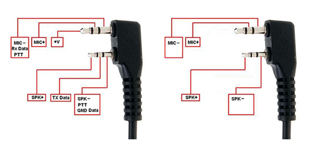

This link seems to suggest a standard TRS cable is not wired correctly. Maybe that is the problem?
Reactions: AudioShockwav
The cables are shorting the ptt line and putting the radio into transmit as soon as you put them in.
You need to find the cable used in the video you posted then use VOX to trigger the transmit.
Yes this shows why it is keying the radio when plugged in.
