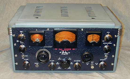

A project on the back burner. The Hallicrafters has been salvaged, savaged and striped for parts beyond repair.
The 148 was in a fire but still works.
Marriage made in hell you think ? :)
