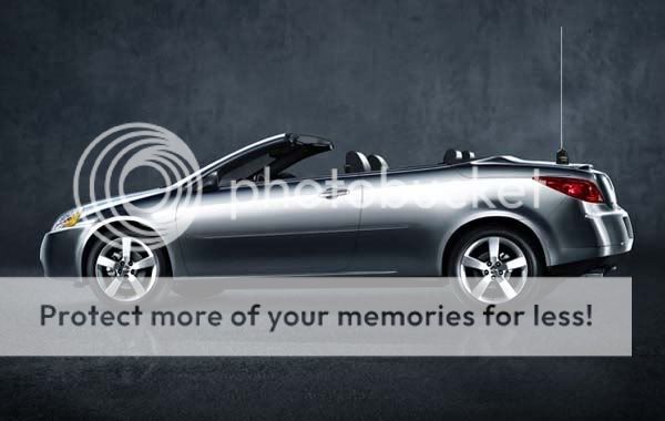

Hey spaz, chop off the top and get a Wilson 5000 roof mount and mount it on the trunk or get a Wilson 5000.
Heres some pix I made up.
But hey the daimon ant I think is the best option for ya.
Aloha 1-5 james.
