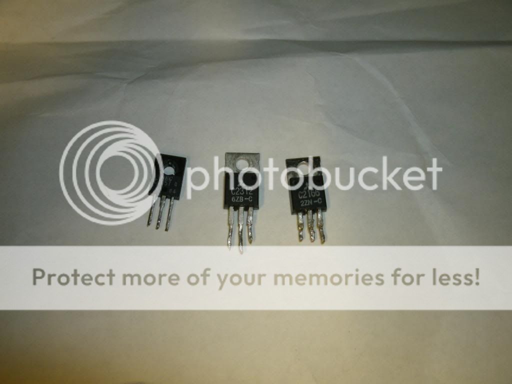

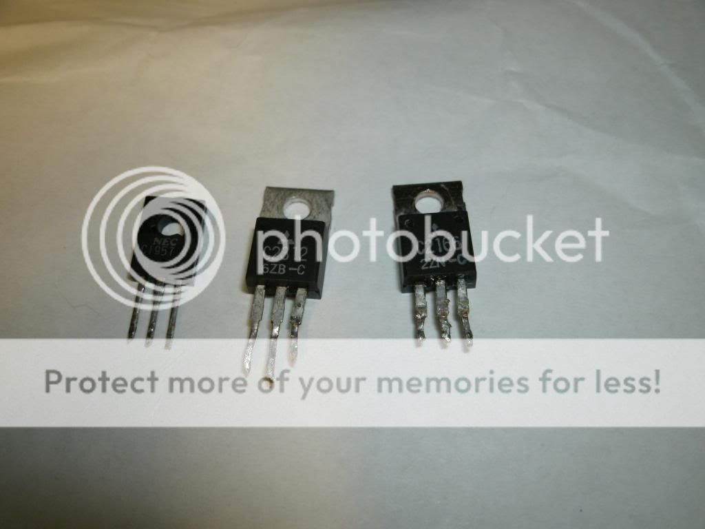

well just took some transistors out of my friends E-bay cobra 142 GTL radio
replaced them with eleflow final and a NOS driver and predriver transistor what a world of difference lol
The pre driver, driver, and final were blown?
They where all repladed at One point befor he got it.. don't know why... The pre driver and final where not the right part numbers. The solder job on it was aweful on all 3
Even if there not fake it was only letting the radio have a dead key of 4 watts with the am power cranked up and swing to 7 watts.. side band was no better with a pep of only 6 watts

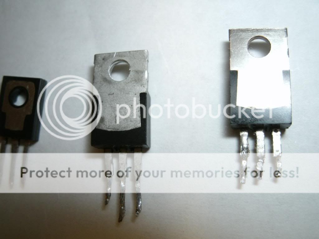

The predriver transistor (labeled C1957 in the picture) is the main reason why power output was low, since the C1957 is the incorrect predriver for a Cobra 142GTL. It should be a 2SC1973.
The C2166 and C2312 are genuine. However, it is possible the C2312 went low gain due to an SWR issue. The C2312 is a direct drop-in replacement for a C1969 and will work with same output as a C1969.

yeah that may be so I did do a mix swop out where I tested 1 at a time the 2 that mad the diff where the driver and pre driver.. looking at the data sheet on the 2sc1957 looked up as just audio pre amp :thumbup: lol I may have jumped the gun on china chips but it is making it hard to fined good chips now....

Most real and I mean not fake Mitsubishi 2SC1969's do not have a super high HFE. That I have ever noticed and all work fine.
Most of the Chinese fake 2SC1969's do not even look like a real 2SC1969 the casing does not even resemble the real part
