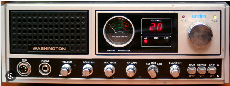

the other way to tell which washington you have is the number of buttons on the lower right.
if you have three buttons, its the 8719 version.
if you have two, 858.
UPD858 version:
MB8719 version:

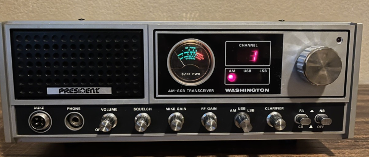

The original 4-pin Washington radio with the uPD858 inside bore the brand President. It was made for only one year, 1978. Then the FCC outlawed channel selectors that could be tweaked between detents to produce not-legal binary codes. All radios built `1979 and later with unlocked PLLs like the 8719 required a channel selector with an additional spst contact circuit. It closes when the shaft is between detents, and connects to the PLL's out-of-lock circuit to disable transmit when the selector is between stable detent positions. Oddly enough, Uniden ditched the 858 chip for the MB8719. Story is that after approving the Cobra 140, 142 and 148 models the FCC griped about the simplicity of modding pin 10. The Cobra 2000 was approved a bit later, after Fujitsu tweaked the 8719 to produce the MB8734. That chip disables pin 10 altogether. No telling how reliable that story is, but if the type-acceptance approval paperwork for the 2000 had been submitted earlier, it would have contained the 8719 chip as well. The President name on the front panel changed to "Uniden" some time in the very-early 1980s, long after the transition from the 4-pin radio to the radio with the MB8719 and the 5-pin mike. If the front panel says "Uniden" the first digit of the serial number should indicate the year of manufacture.

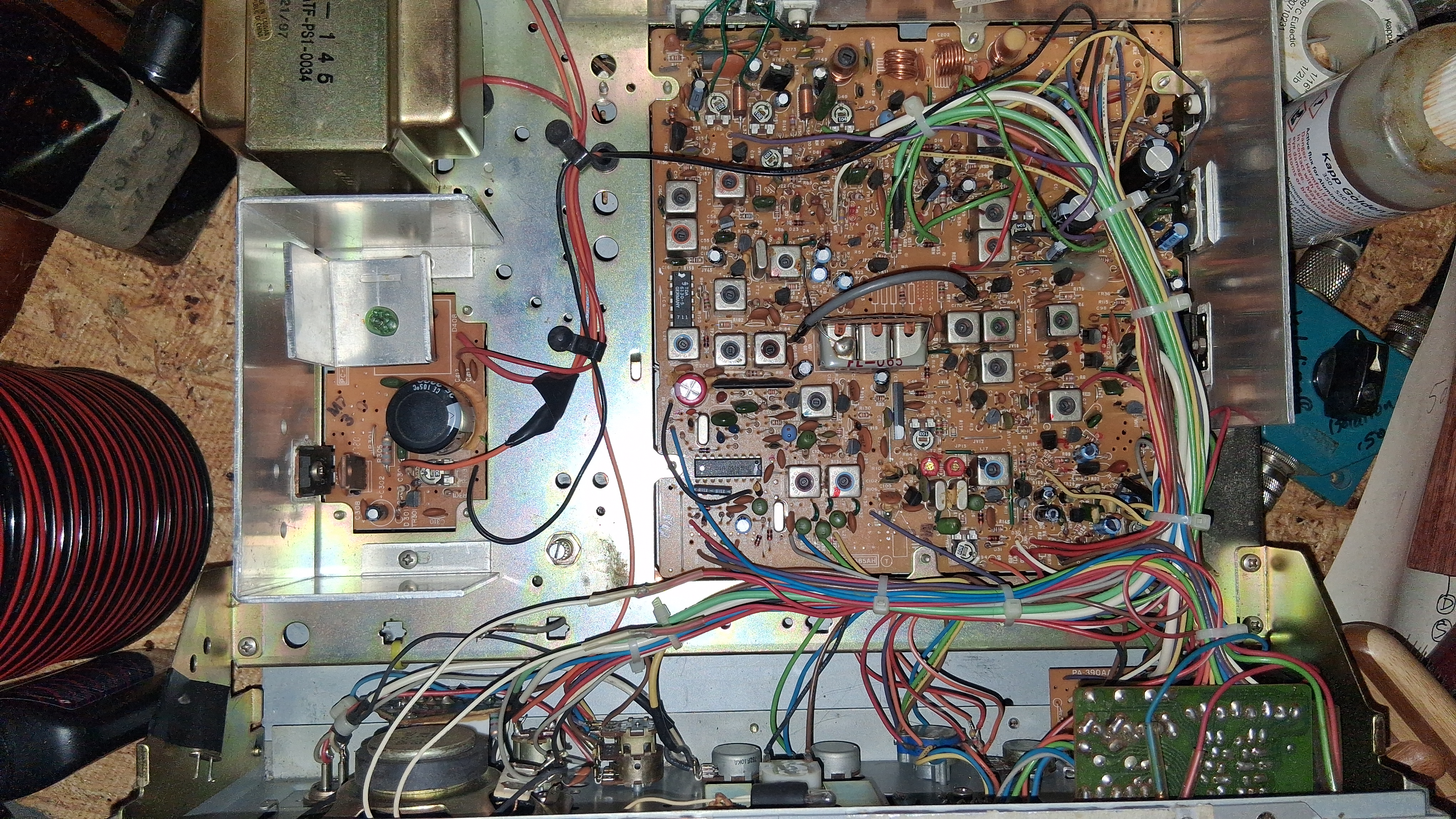

the switch shaft just north of the volume knob was the crystal switch that was stuck through the face. I moved it there hoping that shortening the wires would make the frequency stable before I discovered the problem was a bad trim cap. That switch is now disconnected, which is the little coax poking up through the hole between it and the volume knob. I just left it in the radio because it has no other purpose, same with the crystal taped to the left side. Other than that mess, it is almost untouched. I put the red wurth cap in, so clearly I had a total disregard for the sonybond when I did that. Put the new cap in over the glue lol. I was just getting into radio when I did that. Anyhow, the mic stuff looks factory, but I believe you when you say it shouldn't have come like that.

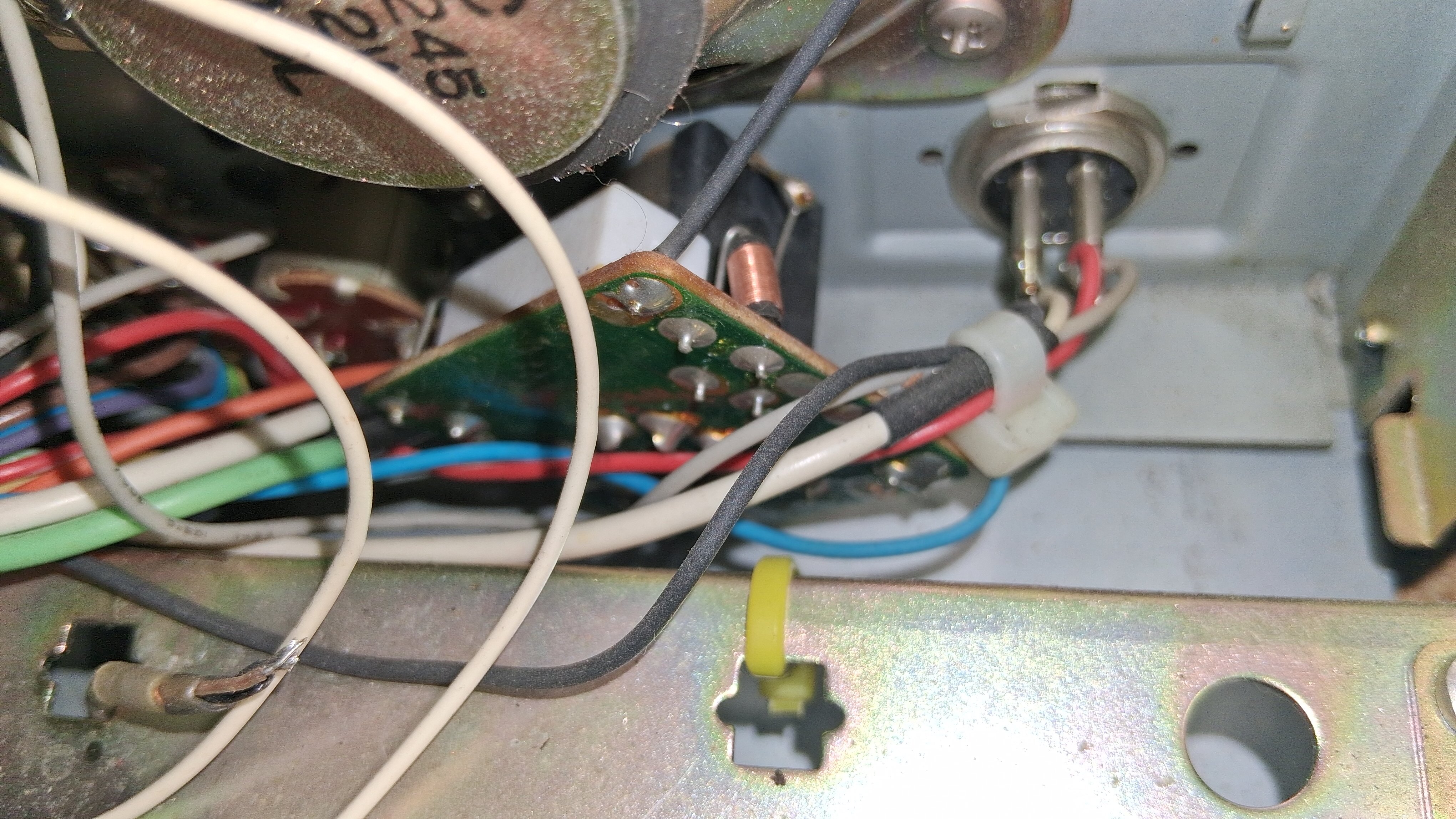

looks like they did a good job on the 4 pin conversion but that bit white cable tie is most likely not factory.
i could be wrong but i don't think ive ever seen one that size used in an old uniden/president radio.
Can't tell from the pic which of the three options was used. Connect only the pin 2 wire, only the pin 4 wire or connect both of them to pin 1. Simply wiring up a 4-pin socket to the radio requires one of those three answers to the math problem 5 doesn't equal 4

I will have to trace the wires later and see what they did. I know there is no relay. The mic does need to be connected for the speaker to work. And I know the pinout matches a DX2547 and cobra mic. I will take a look this evening.
