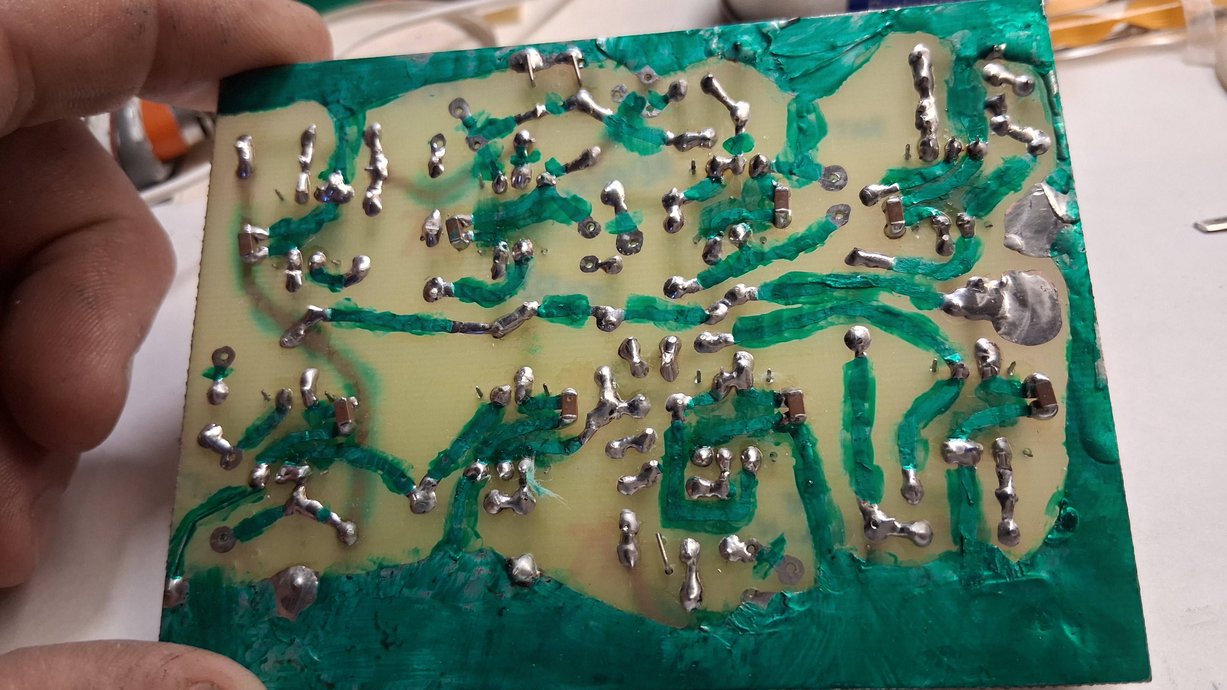

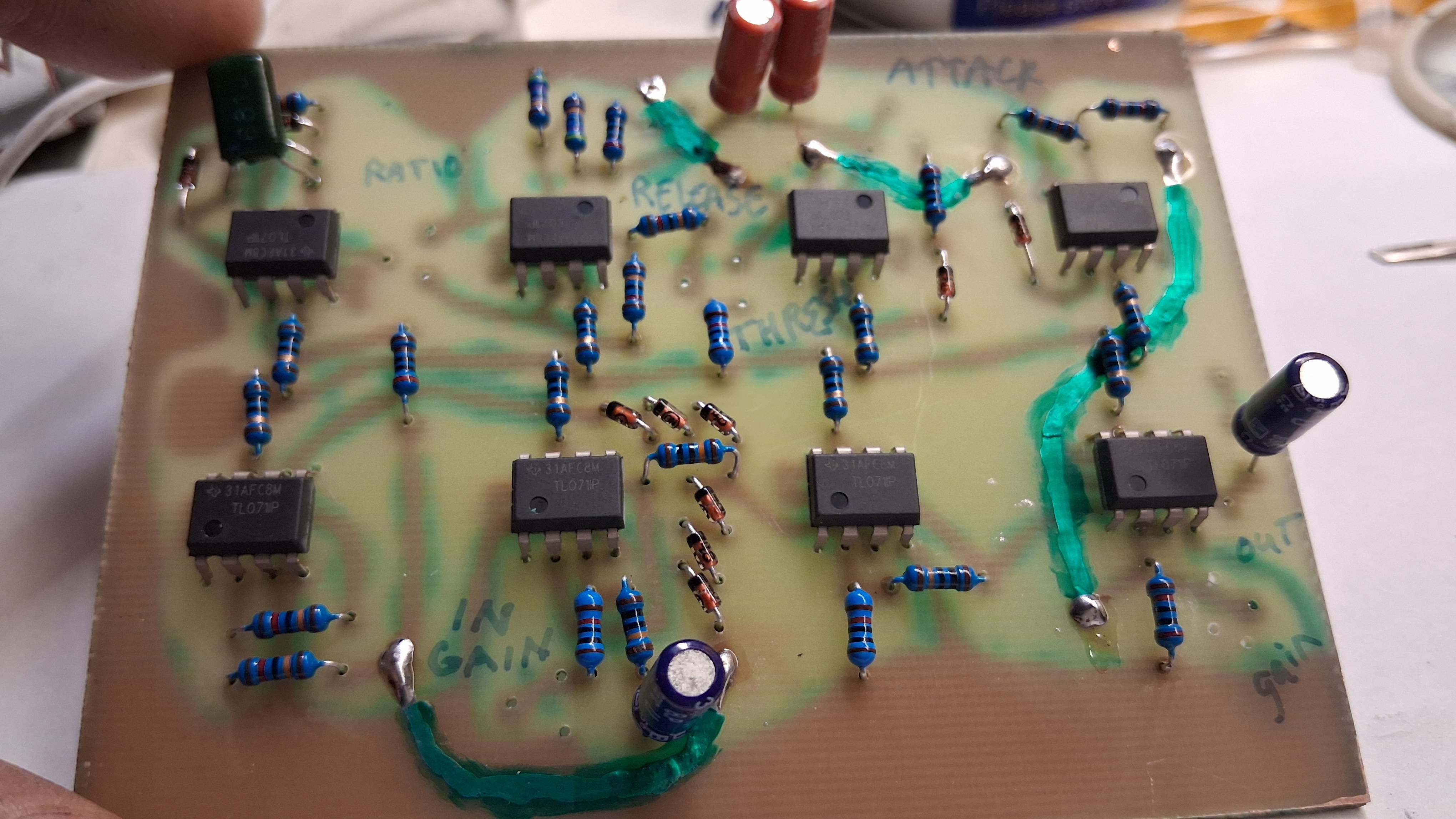

I never studied compressors, but I saw this video and thought it would be fun to try. I only had single op-amps but the plans call for two duals and a quad. Slapped some uv mask on the traces, still don't know why i do that, just makes it a mess. I still need to get the pots and a metal enclosure.
This is going to be one of the two boards for my home brew desk mic. I have no idea how well this will work for voice but I thought it would be worth a try.
