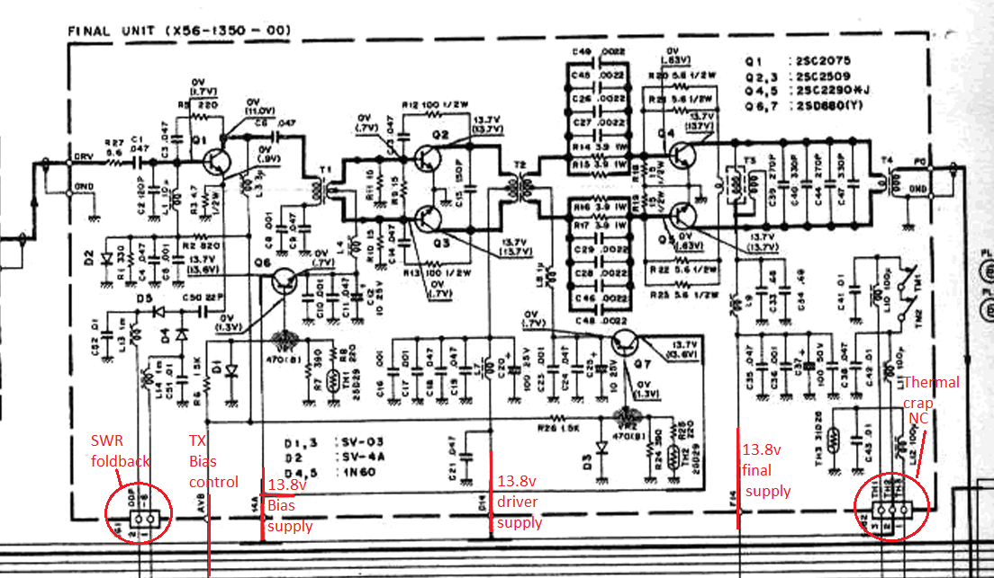

My daily driver is a uniden washington. I have an extra TS-130s final unit and I have been wanting to attach it to the washington for years now but abandoned it due to a lack of knowledge. I think I have the connections figured out now.
It would seem the first pair or wires on the bottom is for SWR foldback as it goes to a transistor very near to the directional coupler on the filter unit. I havent analyzed the circuit there, but I would assume bypassing the emitter would increase gain, so I am thinking swapping diodes D4 and D5 with caps and leave these two leads disconnected (or use it as a variable power mod). The thermal protection stuff that drives relays can go too because I don't normally sit on the mic very long. That should leave just the bias control thats TX only and the other three that I figure can connect right to 13v. Of course, the relays and a filter will have to be macgyvered onto a custom board and tucked inside the radio somehow (and shielded, maybe an external box, idk), a PS upgrade and maybe even some hot switching prevention.
I'm not an amp builder so I must ask if this would be ok to run on AM too or if I would need change bias for AM (the TS-130s had no AM). Anyone know if this will play nice with AM?

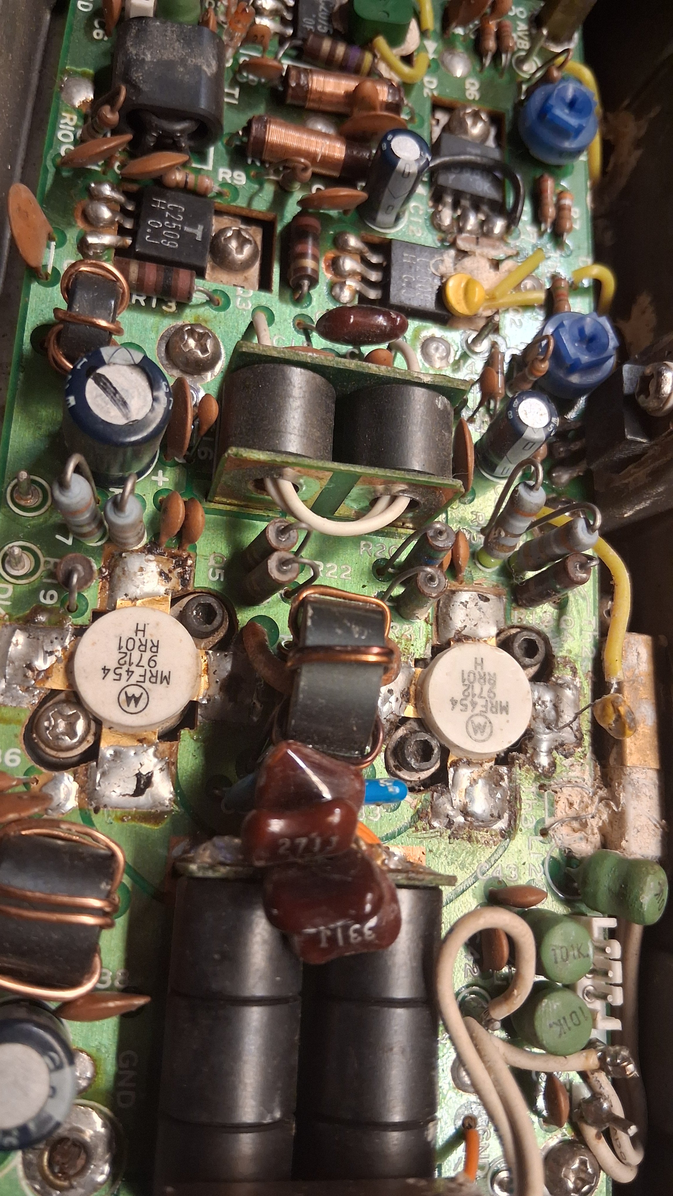

Found the amp in the shed. Looks like someone was already in it. The transistors are new looking and a factory screw replaced. The final thermistor is cracked too so I guess I need to take the board out and look under it.

The TS-130S PA uses 2SC2290. Someone was in it for sure..... My TS-130S, had the worst PA on 10m of all of my Kenwood's.

I noticed that too. The cracked thermistor works as it should so i coated it in a thin layer of resin and put it back in. One thing that I don't understand is that all of the 2SC2509 (drivers) datasheets show the middle pin as the collector and this PA grounds that pin and calls it the emitter in the schematic. The datasheet also calls the tab the collector, and it is connected to the middle pin that kenwood is using as emitter/ground.

I did a quick in-circuit test on the MRF454s to make sure they are working and they both worked and seemed well matched. I hope it works. I will be searching the shed for the old parts kenwood filter board. I think it will have the inductors and relay I need.

My memory, which isn't great these days, tells me the pinout of the driver is BEC, thus grounding the center pin and tab.

I've got a mystery with these 454s. I noticed 23mA of current with no bias. The base is about 8 ohm to ground. I get about 23mA draw with no bias. I lifted one collector and it cut the draw in half. With an ohm meter on the supply rail, I get about 345ohm and it raises a few ohm when hot air is blown on the finals. Going from 12v to 24v only added 10mA. If I power the bias circuit (which I haven't changed) it pulls about 248mA (which seems like it would be right, IDK).
Earlier I had used a 220ohm resistor to go from collector to base to turn on the transistor. At 220ohm I had about 250mA and at 120ohm, it went up to 1.25A. With the 8 ohms or so at the base, thats around .7v so a sharp increase in current is expected. Both transistors raised the current the same so I assumed they must be well matched. With the supply set to trip at 2A, I used a 10ohm resistor to turn it on hard enough to trip the breaker, and it did. Seems like it is working.
When I lifted the collector of one of the transistors, I had 581ohm collector to emitter and 574 collector to base. Polarity did not matter.
Do these 454's have that much leakage? They seem to be behaving like transistors at least.
What voltage drop do you see E-C?
With no bias and 13.8v at the supply, I see the full supply voltage across C-E of both transistors, 202mV on one base to emitter and 207mV base to emitter on the other.
With the final bias supply input pin connected to the 13v rail, the base-emitter of both drop to 153mV and 157mV respectively and the current draw goes from 25mA to 255mA and the collector emitter voltage goes to 13.5v on both. They seem to be behaving like good transistors aside from this mystery leakage when not biased.
