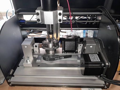

All things evolve stagnate or die. In this case the original 3018 was used as a model for a 4th and 5th axis machine.
I had a bit of an engineering challenge.

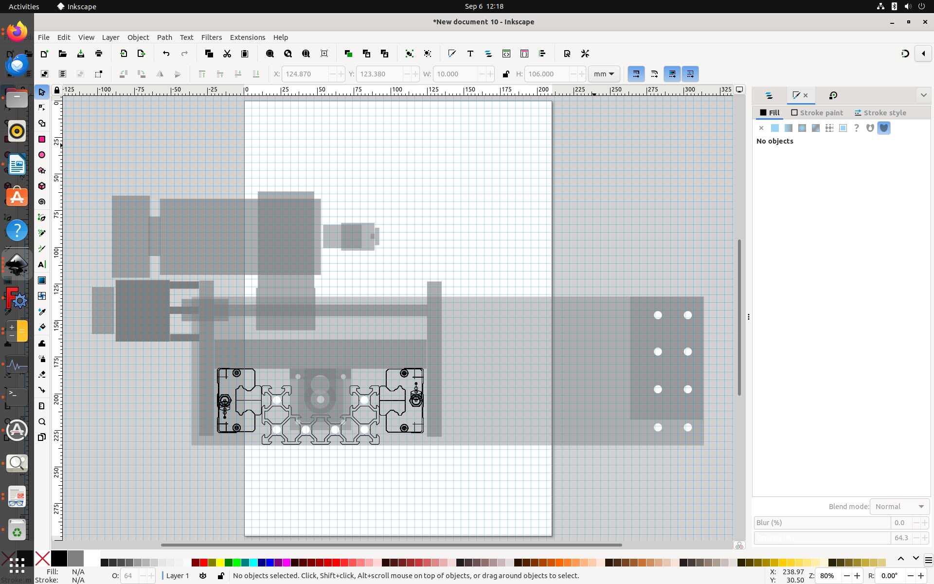

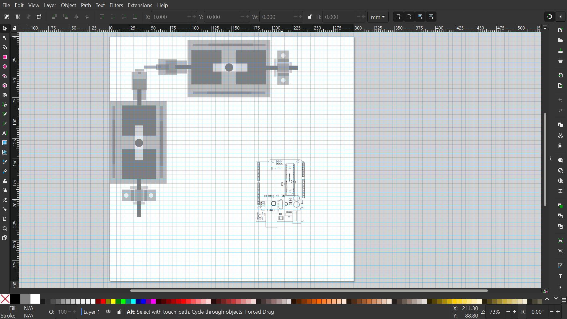

This will take some imagination. There are 4 stepper motors there (nema 17) and two er11 collets. One pair of stepper motors position the work. The other pair of motors rotate the work. The arduino uno n the lower right is to and for scale .
