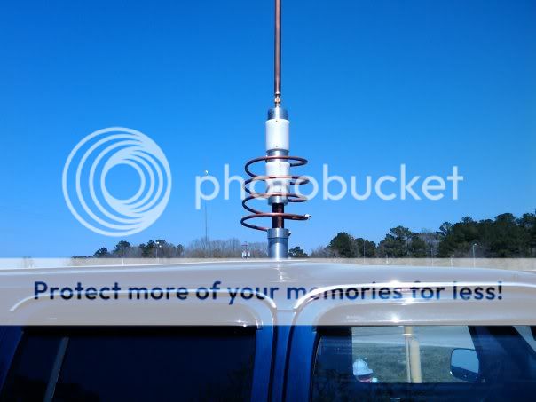

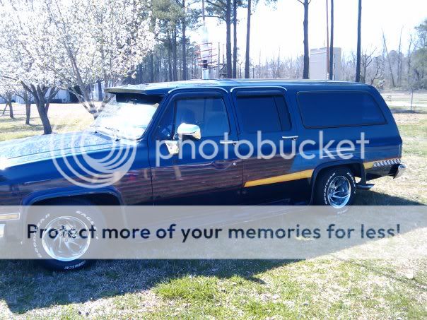

Your comments makes it clear to me why they banned The Rod Of God Antenna from keydowns. A 16pill DC mobile running the Rod OF God cutting the lips off a 3cx3000 AC mobile is priceless.:thumbup: Alot of people would not be able to accept the beat down.
If the R.O.G was a half wave or 5/8 wave wouldn't it have more gain by design than a quarter wave setup, even if directors were added on the mobile (especially if it were just one or two)?

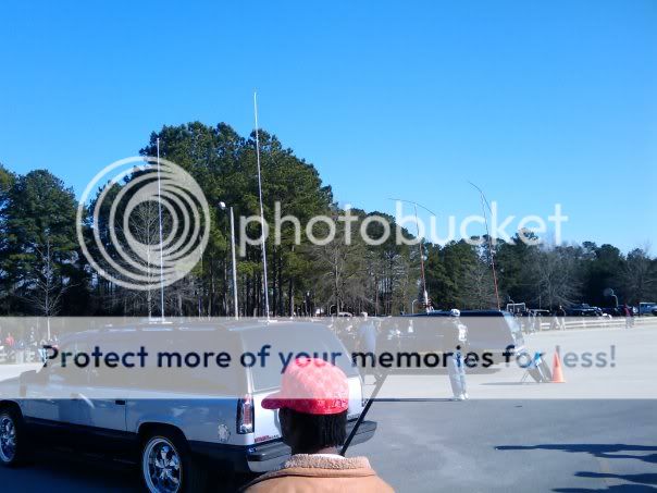

I was just a the Jax break 09 and Fatboy has their own version of the Rod of God They use it with copper pipe "T" tops and claim it to be 5/8's. Pricing up over the $1,000. mark. They keyed against other trucks in the regular pill classes and didn't get past the second round against the 5 antenna Suburbans. They run a 2 antenna set-up on BB's old truck and beat a 3cx15000 with 2 live sticks & no backdoor. 50kw's of power! What a show but to me it's just marketing!

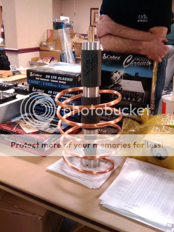

At a typically >1,000ohms feed point impedance of an end-fed 1/2 wave, I would expect a lot more coil than that.
I estimated about 9 feet of 3/8" wide hollow copper coil. The top I saw on it was about 9 feet tall with a "T" on top of about 9 feet wide. The top to bottom was NOT adjustable but the "T" was adjustable to the sides and about 6 to 8 inches longer on the reflector. This was a 2 antenna set-up with 6 foot spacing BUT the reflector did NOT have the coil. I might be wrong but isn't the reflector AND the antenna supposed to be the same wavelength? By the way, the set-up I saw had copper pipe for the shaft and it was soldered like a regular plumbing fixture...

You can't deny one thing, Dave was a great innovator of higher performance boxes and antennas.. I have never seen vacuum capacitors used on a mobile antenna before, which is something very different. Vacuum capacitors have a higher efficiency and handle much more power. I would of just made the antenna 4 feet taller however, and made it a 5/8th wave though. A 5/8th wave doesn't need a capacitor to match the antenna at all, and may have an ever slight more gain and height advantage.
