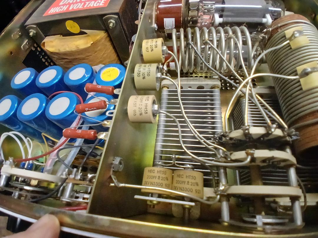

nomadradio here is a picture of inside.
Reactions: Cable Guy

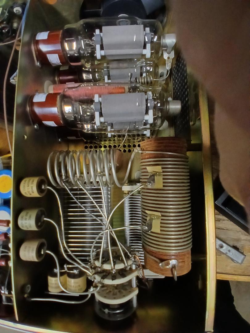

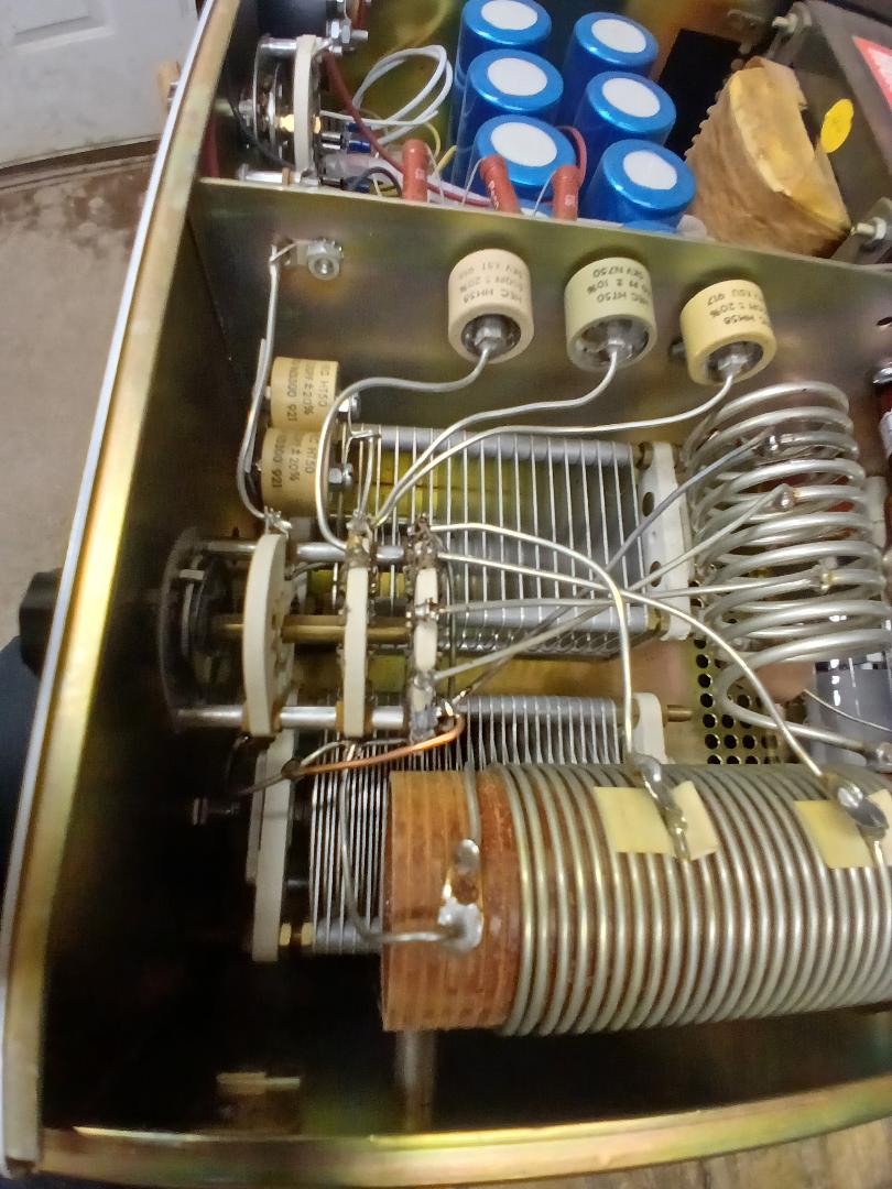

Our local tech helped me converting Dentron amp to just 11 meters to bypass burnt wafer switch. It was really pretty easy. Amp will not work on other bands unless jumper wire is cut or removed. The copper jumper wire makes amp run on just 11 meters. Works great.
