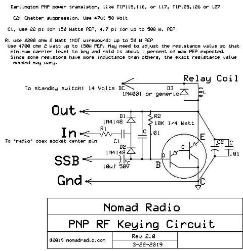

Here's the one we sell, with the input resistor used to bridge from the radio jack's center pin to the pc board.
To use it at frequencies much lower than 11 meters, the input cap probably has to be bigger. Never had a reason to find out how much.

This is a good circuit. I see you have the base-emitter junction bypassed with a .01 capacitor, which effectively RF bypasses the diodes as well. I would not expect this circuit to have the ability to introduce any harmonics. Nice job. Heavy duty too.
