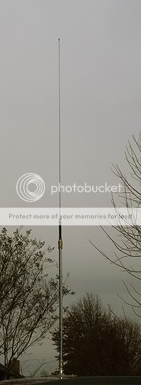

I have two of them. I've made numerous contacts with them.
Modified for center load:
