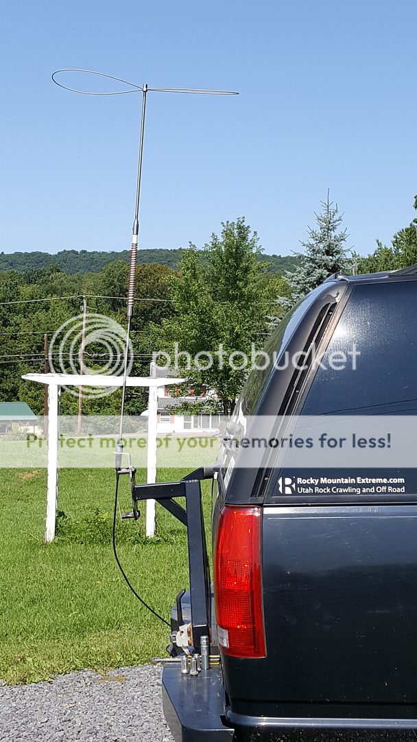

Isn't that "more coil", compared to a commercially manufactured unit (a Wilson 5k would be longer, no?) and is that for 11 meters? Looks great none-the-less! Awesome work
with a neat capacitance hat, very nice.
Edit: Some reading on hats
Some folks think cap hats are for the birds! But, if you want the best performance (read that as the highest efficiency) out of an HF mobile antenna, they are the only way to accomplish the goal, yet maintain some modicum of practicality. They have some drawbacks as any system will have, but the pluses outweigh the minuses.

Too bad these aren't commercially available.
You can actually make one easy enough. Just buy the hub from DX engineering and radial rods if needed. I prefer straight radials for capacity hats because that loop is a tree branch catcher.
Below is a pic of the hub which takes a standard 3/8 x 24 threaded mast. Just push some rods thru the holes then make a coil with enameled copper wire around some PVC pipe. It'll take a little trial and error to get the match right but it will work great when completed.

now they just need to start selling all the other parts

I ended up removing half the coil after adding the cap hat. Then I just had to readjust the spacing between the coils after I got done removing the unnecessary coils.
Now I just need to find someone with a tractor that could use it. I don't really have a use for it since I slip seat
Just as a note that is probably the worst type of mount you could ever have.
It was only for rough tuning. I stopped slightly short of resonance. Grounded through a 1.25" trailer axle and roller bearings for a hinge as well as the latching mechanism. It was never meant to be used that way. My real antenna is on the roof. I didn't have a tractor to mount it on so I improvised to get it roughly in the ballpark before I sent it to a guy but he never picked it up.
