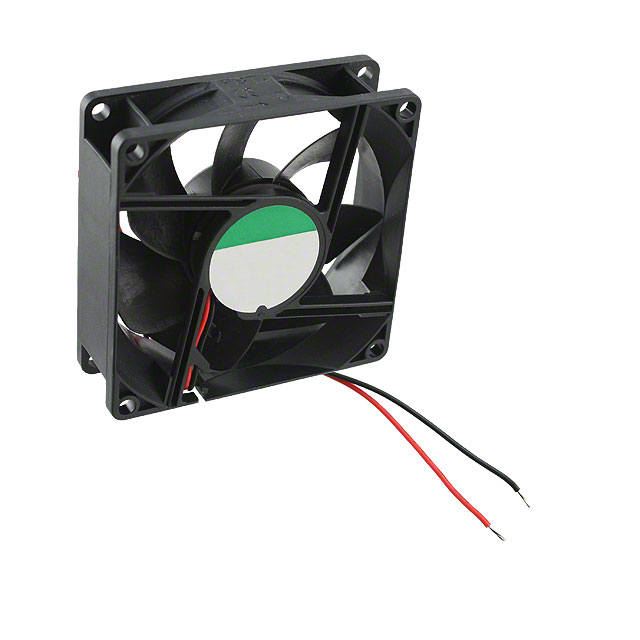

Digikey and Mouser sell DC fans. You have enough space on the horizontal section of your radio's heatsink to tap out holes to mount 2 inch or smaller fans with a couple small screws. Power it externally or as I said before, run the wires to a switchable source in the radio. Heat worries long gone!
Technically I could just mount a couple fans on the bottom of my console.
