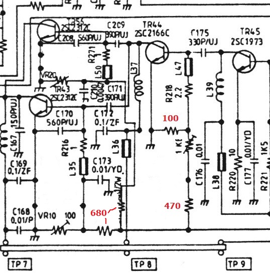

but can you adjust VR10/11 for the bias there? the finals?
as brandon said, "in SSB (with mic gain minimum)"
key up.
check the 8V that supplies the bias R243/R245 junction to ground.
check the voltage at base of Q47/48/49 for around .65
the voltage at the collectors at around 12.5
but if the conducting voltage at D92 is lower than normal, then
that will be a problem to adjust Q49 bias.
I have had this same problem as you, so I take out them
diodes in the bias circuit and change it up.
I do something like this-

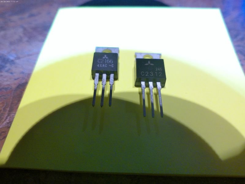

What is the RF PO in FM? What are you measuring power with? Also, peak Atlas will not tell you a device is a fake. I generally trust RF Parts, but I don't know what they are selling these days, so I just checked. The do NOT have 2SC2312, but are subbing MRF475, which does not have the same Po as the 2312. When did you acquire these devices? Can you post a photo of the 2312, 2166?
