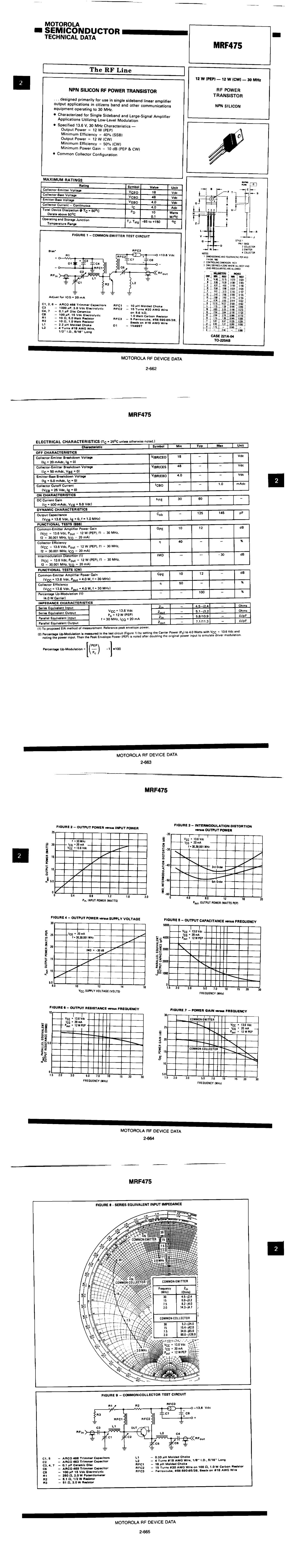

Why would RF parts rebrand the Motorola transistor as a Mitsubishi?
They plainly state on the site that it's a sub for the 2312/1969 with lower gain and only 12 watts output, lower than both the 1969/2312
See attached data sheet.
