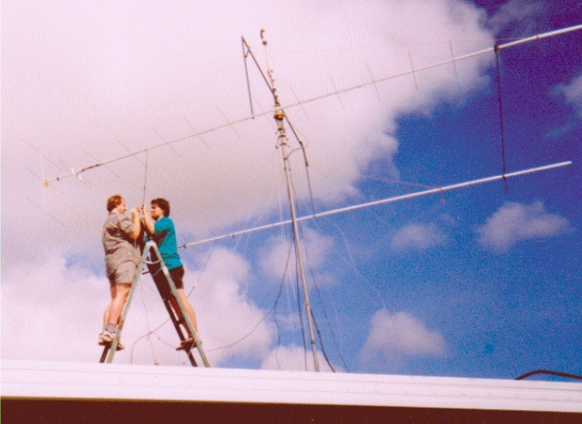

Did it a couple of times about 10 years ago with a budget setup on 2 meters.Cw only. 200 watts carrier gasfet preamp 4x 18 element long yagis fed with ldf 450. like i said a budget setup. A lot of work for a few scratchy dit dahs. kind of cool technically , Loved sweeping the array past the moon and listening to the increase in static for testing.Lookup W5UN,s site to see what a good setup looks like ( he uses a jeep as a rotator) De VK4AAP
Here's an old pic of the first stage going up.
