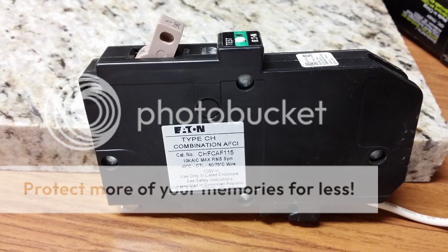

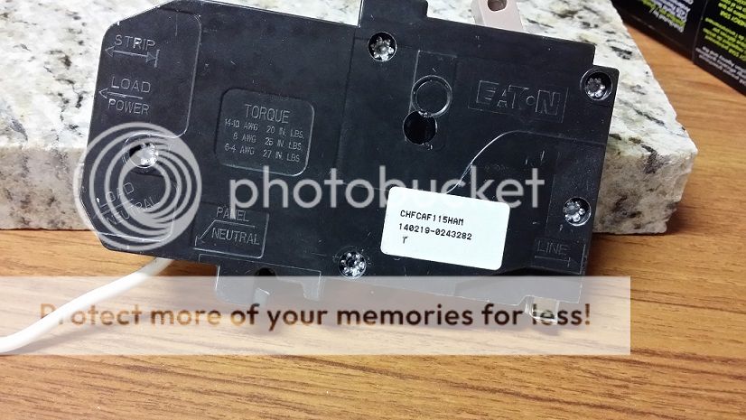

notice the difference.....
supposedly modified for Ham usage
look closely at the labels
