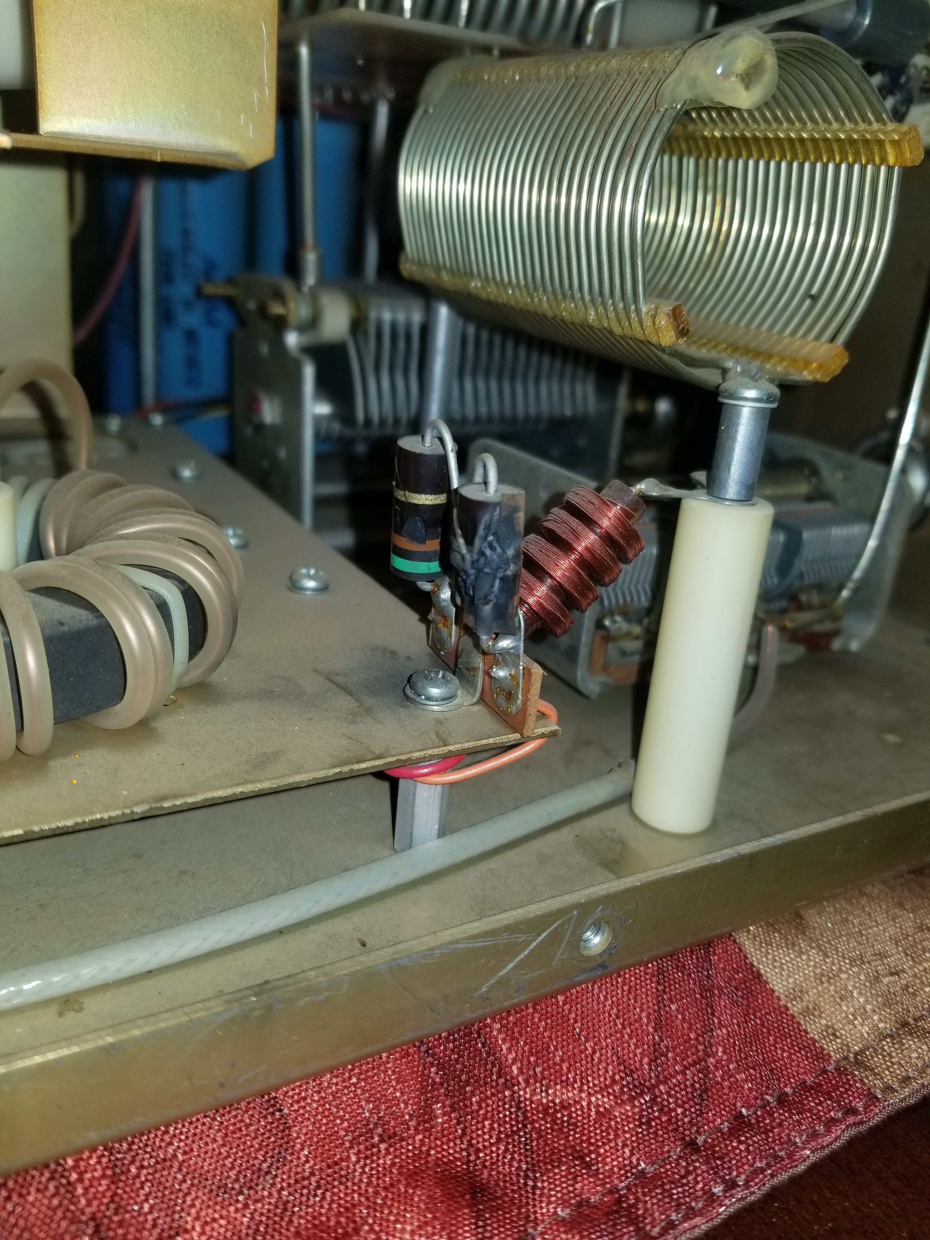

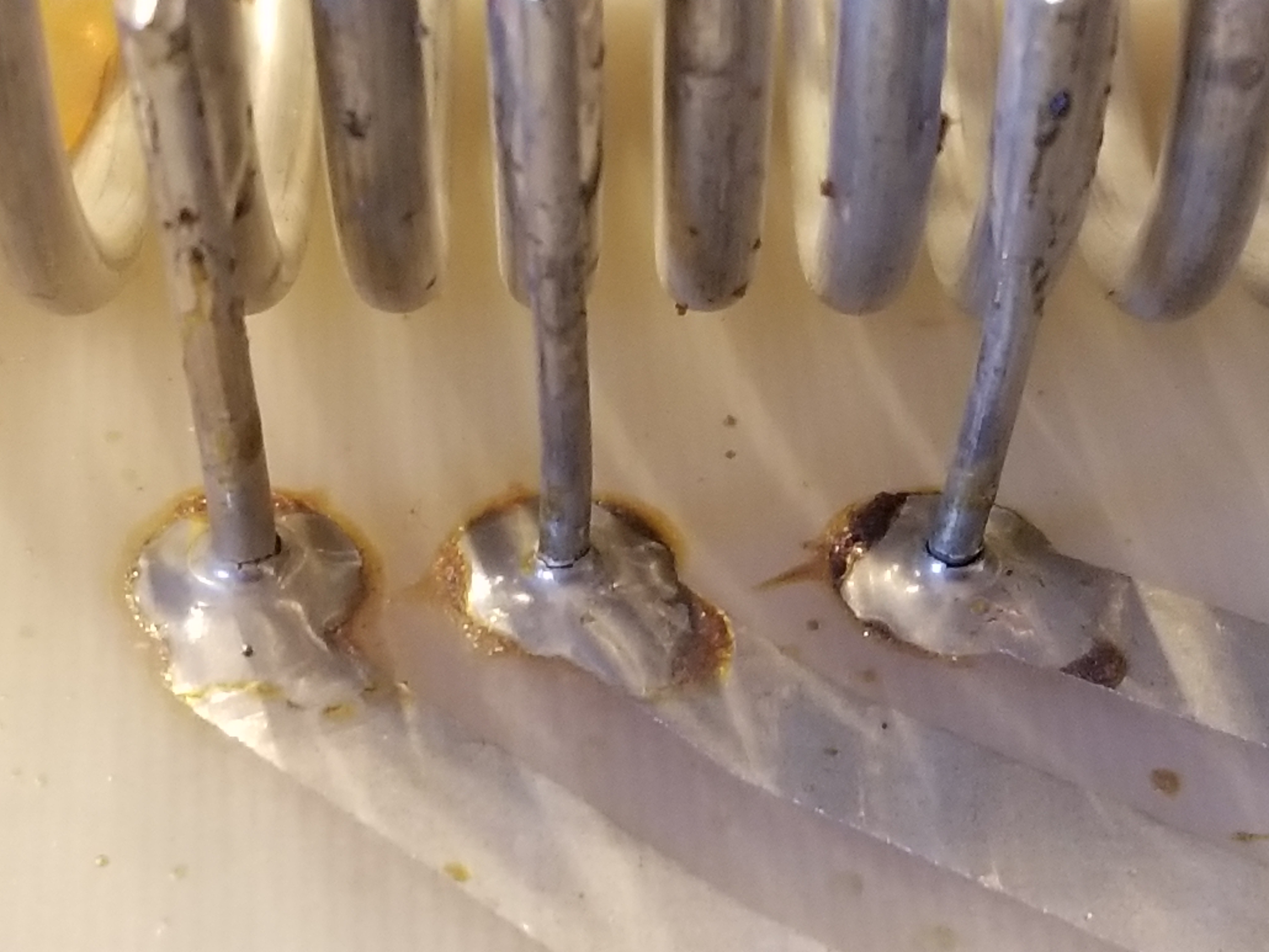

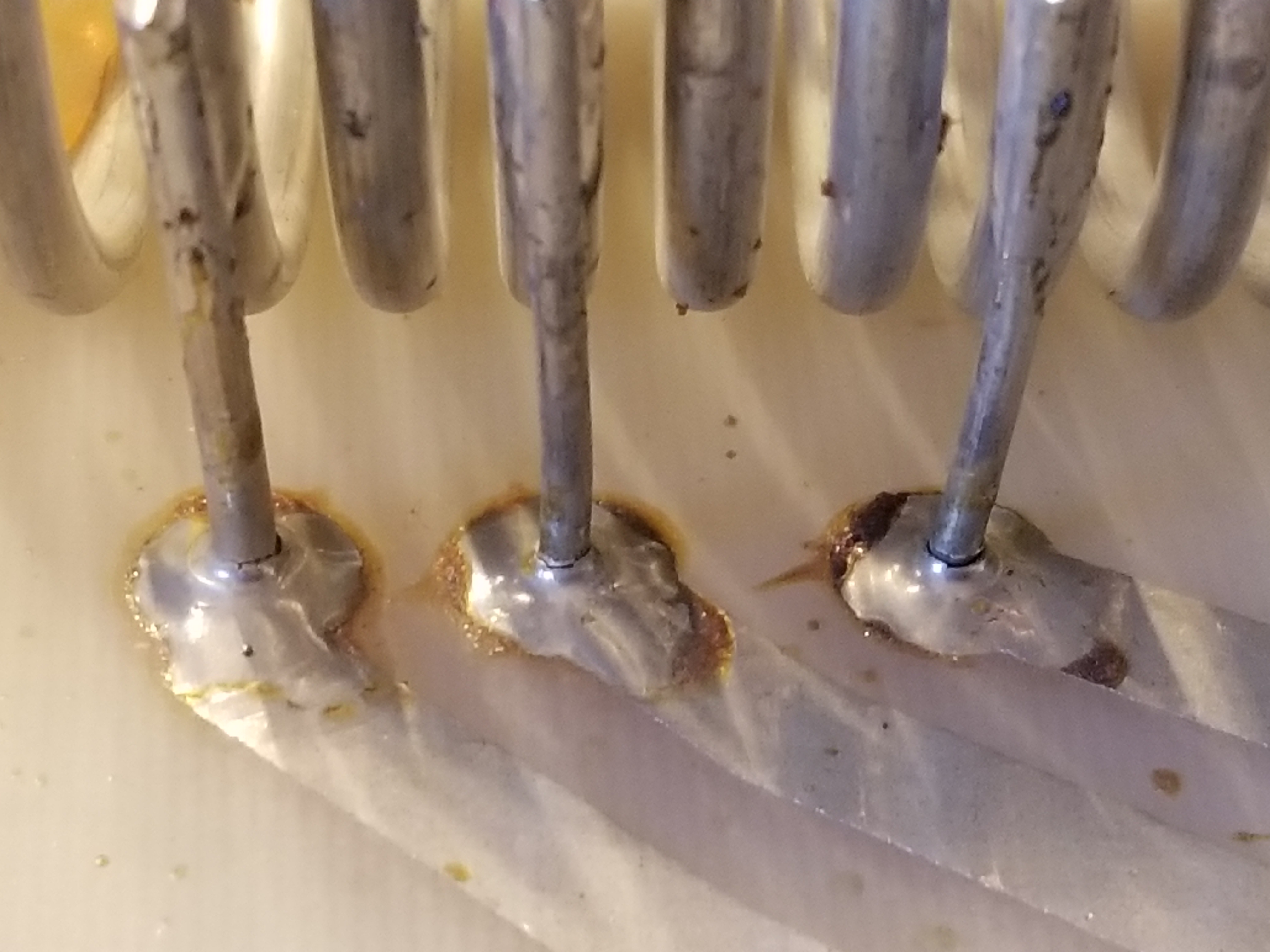

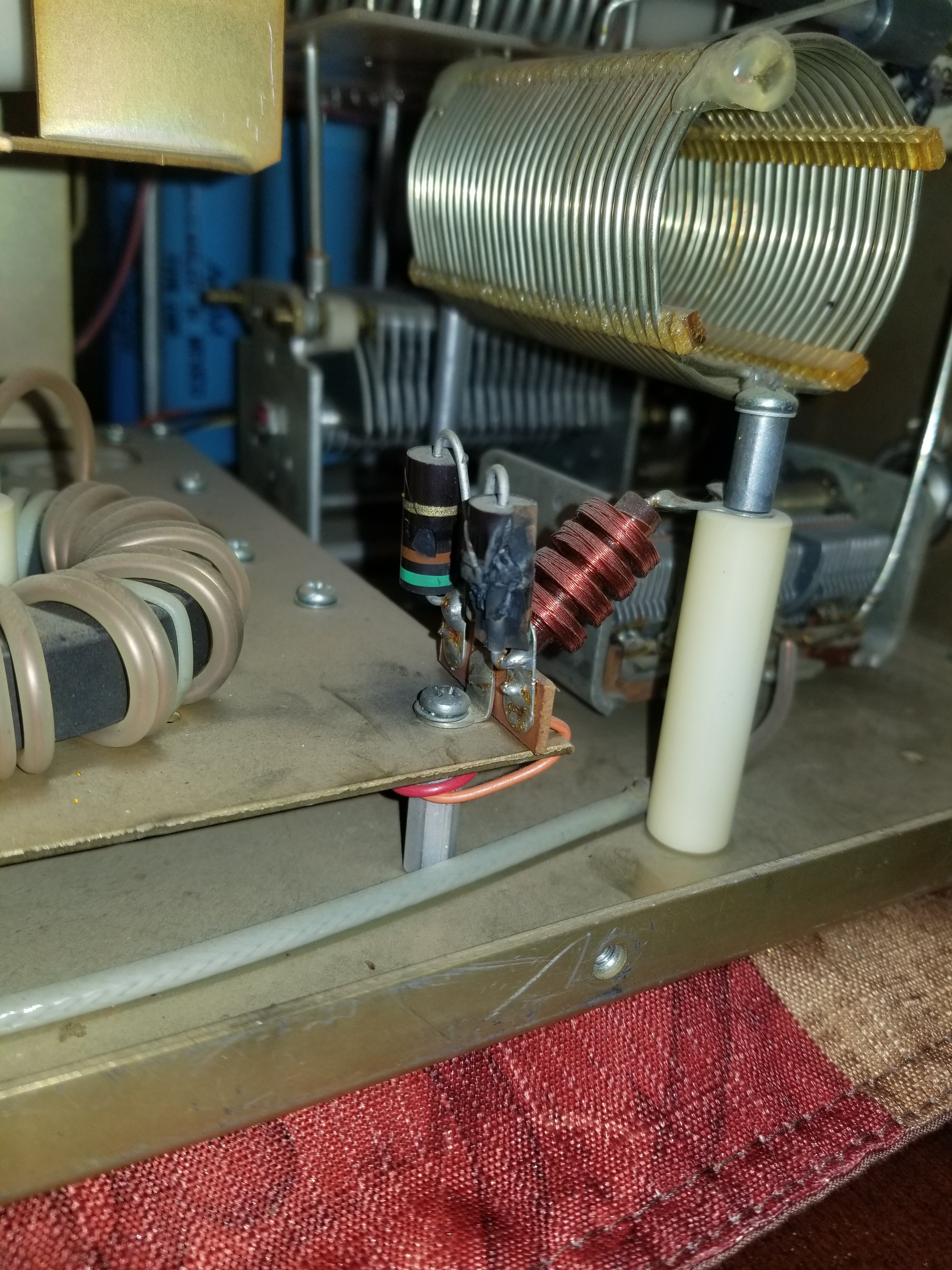

It arrived today, and I think it could have been worse. I found broken solder joints where 20, 15 an 10m tie into the high power choke. The band switch has a little discoloring, but all of the contacts still have spring to them. It also has 2 blown grid resistors. I assume I should get rid if the grid resistors as W8JI recommends, but I will have to do some more research on that.

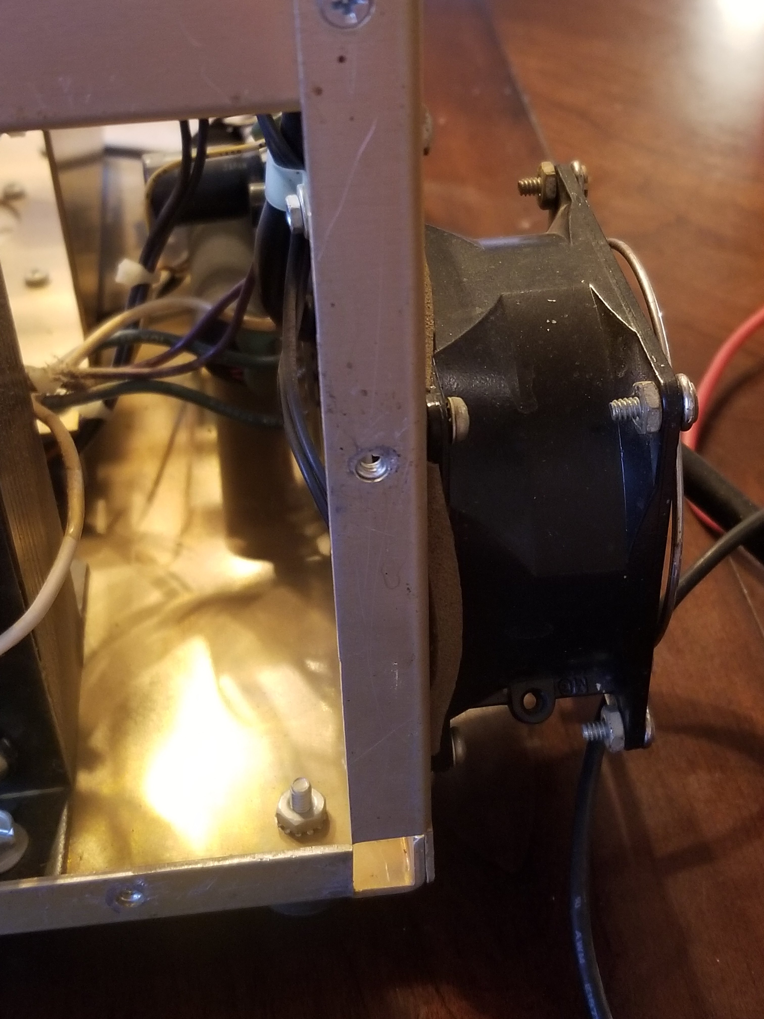

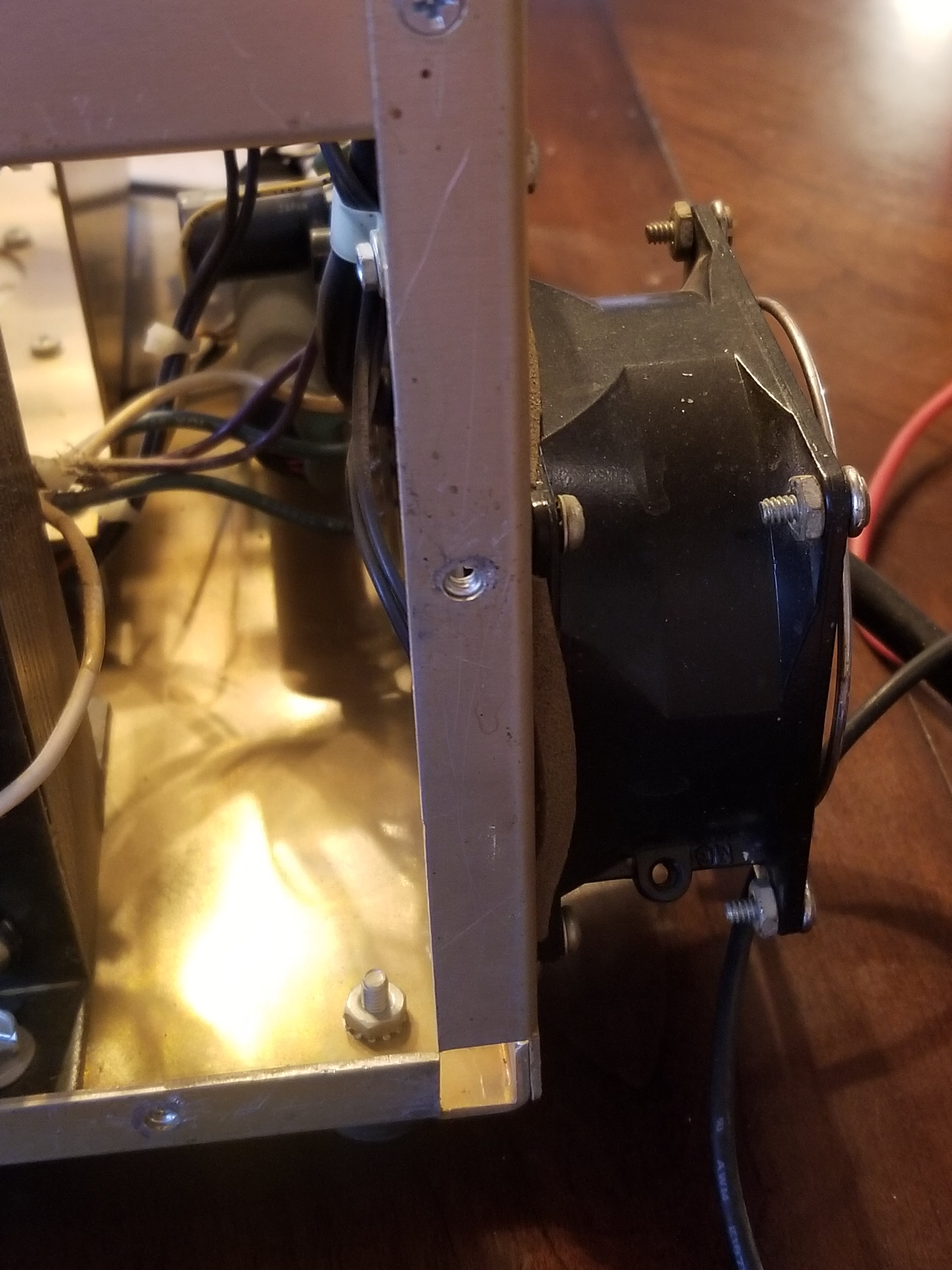

I can't figure out why the fan is outside the case. Maybe a lousy attempt to increase air flow?
thats an 811 H.
perhaps I misread the thread, I thot you got an 811 three holer.
DUH!!!! I just went back and L@@KED at the thread title,.... you can smak me now:censored:
