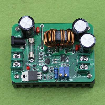

What did arrive today are a couple of candidate voltage step-up inverters I'll need to get 50 Volts DC in a 13.8-Volt base radio.
Here's the pic for a 600-Watt step-up inverter from the Chinabay listing.

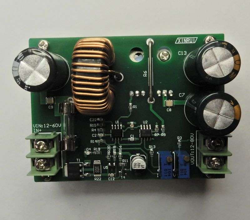

And here's what they sent.
If I wanted to be a jerk, I could probably get it free by invoking Fleabay's "As Pictured" rule. But I was pretty sure I would need to hack this thing anyway, so I really don't care.

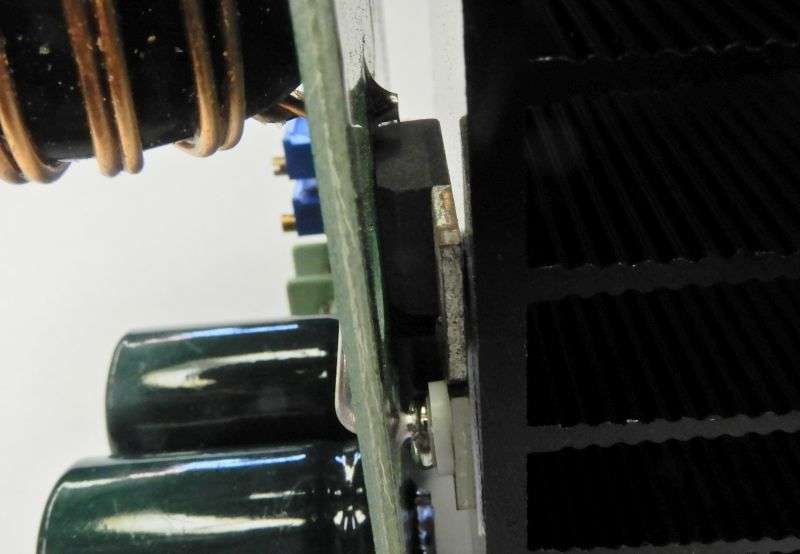

The sharp-eyed reader may spot a small assembly crock in the one they sent me.
Like this:
Looks like this from the side.

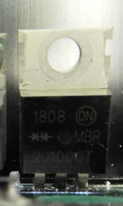

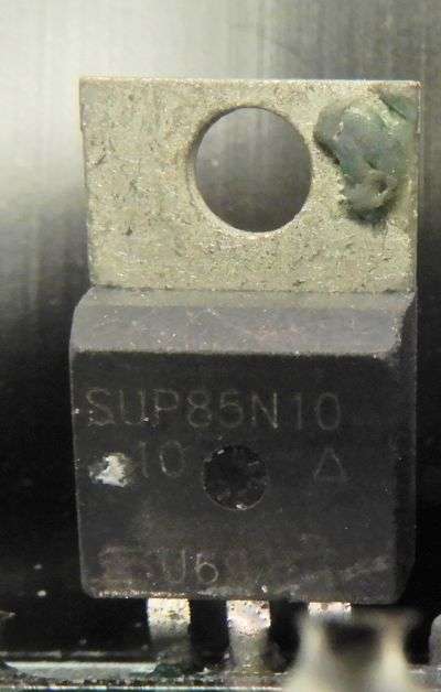

Sure enough, the Sil-pad stays where it was when the pcb is unbolted from the heat sink.
A good thing I didn't plan to just hook it up and try with a dummy load right away.
The part that was bolted down is a full-wave rectifier, containing two diodes.
The one that wasn't bolted down is the switchmode MOSFET.
Seems like a bad idea. Fortunately I have the hardware to finish building this unit before I power it up.
I did not get a good pic of the markings on the two tiny surface-mount integrated circuits. But for those playing along at home, the controller chip is type UC3843 current-mode PWM controller made by ST Micro.
Found it at alldatasheet.com.
The other chip is a generic LM358 dual opamp.
