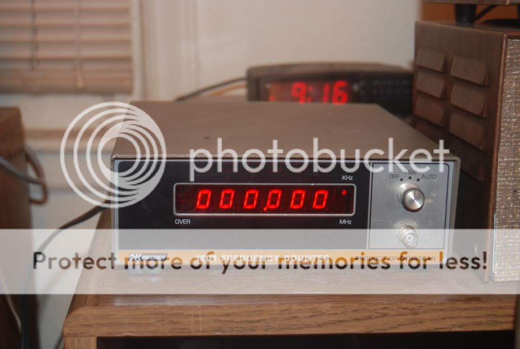

Well I bought it and I am gonna use it......if I can find the proper probes.
It has 2 settings 1 second and auto?
Its solid built.
