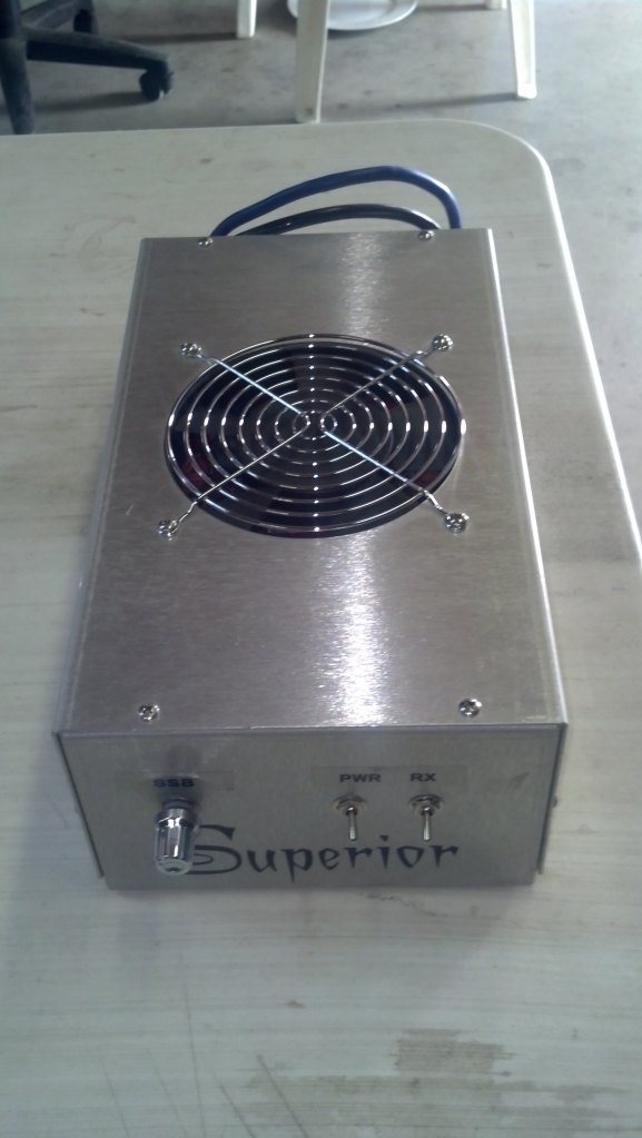

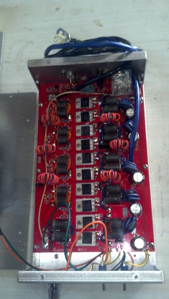

2 driving 8 ERF 7530s MOFSETs I ran this in my car and got only 400W PEP and i need to know what its capable of doing. I ran 12W swinging over 60w and the owner who picked this up at an estate sale says never run over 40 pep into it. 400w seems way too low for me and i cant find anything online about it. Any info would help thanks

Well, you might be driving it more than it requires since two ERF are driving eight. The ERF7530 are rated at/about 75w out/each. So either a couple of ERF's are burned out, or you aren't supplying the amp with enough current/amperage to let them fully operate. I would expected around 600w since 8 X ~75w device = ~600 . . .
Ok thanks for your time. I'll just try this. What in your opinion is the proper driver for this box. You know "this amp should run on 13.8v with a 100 amp power supply driving it with a 3w deadkey" And what is the expected output for a 2x8 running ERF 7530's. and if you would ....what would be considered too much drive for this box period. I dont know enough about these FET's yet and i have no time to learn them.
Too much dead key, try 1-2 watts of dead key and see what happens, sounds like you are overdriving it as well. With a 1.5 watt dead key can you tell me what the amp keys up as that's what is important. That and I would think that with a driver section that 60 watts pep is too much, something like 15-20 watts pep from a 1-2 watt dead key might make the amp perform better. Do you have any other radios to use that don't put out so much power?? I may be wrong but normally if there is a driver section the 2 drivers shouldn't need much to get them going. Maybe someone can chime in as well.
Well, the RFX-75 uses a single ERF-2030 to drive the ERF-7530, so a 2030 drives it with about 20w. SO two 7530 being driven with 40-45w should be tops as a guess.
The best way to gauge real output is with an accurate meter into a dummy load.
One thing to keep in mind about the RFX-75 is that it replaces the radios driver and final. That means the ERF-2030 is only driven by the radios pre-driver at a level usually less than 300 milliwatts. That means the output of the ERF-2030 used in the RFX-75 is significantly less than the 20 watts it might make as the final in a radio driven by over 1200 milliwatts from the driver stage in most cases. The fact that driving the amp harder will not produce more than the 400 watts suggests those transistors are already driven into saturation and well beyond the point of gain compression.
I'm not a fan of using any RF device in this type of package for applications above 50 watts to 30 Mhz. Motorola, one of the most trusted names in RF transistors NEVER manufactured a part over 40 watts in these cheaper 3 pin packages. The 40 watt versions were also made with the metal tab as the emitter or grounded pin to reduce inductance. This is very important when dealing with higher levels of RF current (required at 12 volts) and the upper limits of the HF spectrum. Power, efficiency and stability all suffer when this is ignored because the transistor struggles to maintain a path to RF ground as the power goes up.
The unfortunate truth is they perform worse than the lowest rated Motorola MRF455 RF transistors made 30 years ago in these amplifiers. That's why you need at least twice as many to come close to the output of the old bipolar transistors. Any more current through a single stage and the circuit falls apart or pops the transistors. Incidentally, if one of your transistors were burnt out, the 100 ohm resistors across the output combiners would be smoking when you keyed. Seeing 400 watts output may just mean you have an accurate watt meter.

I really hate to see that amplifiers have come to this, a whole nasty looking row of friggen 7530 mosfets in an amplifier. Dang. Give me 2290's, 2879's, 1446's, 455's, and 454's like it should be.
They used to sell an amp that had four ERF-7530's that was doing about 300w. So an amp with eight devices should do twice that. Just saying.
Possible that one of the two ERF's drivers are blown. Really hard to troubleshoot something like this over the internet.
It's the mindset typically found in this area of the hobby. I just want watts...as many as possible for as little as possible. The driving factor has remained the same, just the options have changed. If you want to see the other end of modern solid state amps just look at any of the established commercial Two-Way or amateur manufactures are doing. Notice what Motorola or Yaesu use in their 100 watt mobile rigs. They are MOSFET transistors but look nothing like a CB final. They also cost about 10 times as much per device. Better parts are available today but this market is price driven and the circuits used to run today's parts are also different. That means some techs are going to have to update their knowledge to use them too.
Reactions: 2 people
If one of the drivers were blown in this circuit the output would be zero. That's because the first stage is push-pull and cannot function if one side is open. First sign of blown transistors is the 100 ohm resistors inside the output combiners burns up. That's because in normal operation the input to all combiners is equal on both sides so that no power is dissipated across the resistor. When one transistor fails it creates an imbalance much larger than the resistors power rating and you let the smoke out of the part.
