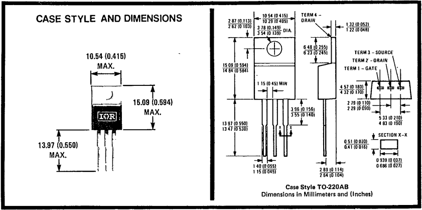

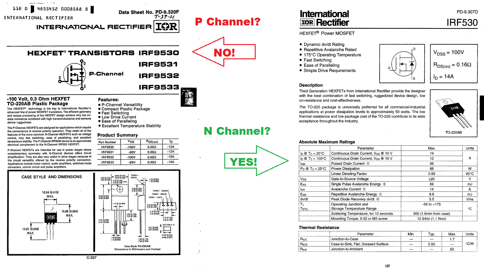

Well, look at the Datasheet of the one that is known - being the IRF one...
Compare it to a KNOWN one that will work in systems like what you're intending to "convert"
There are reasons why the numbers are different - by manufacturer due to the versatility of the device and the intent of the maker to promote for that purpose.
To help you understand the differences between P-channel and N-Channel - just look for and utilize the "spike polarity protection diode" and note it's polarity.
Your device would blow the moment you turned on the power installed in a typical linear.
You might want to rethink that...

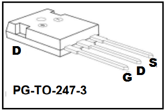

You can also try this...
Use IXTQ36N30 to locate this thru Digikey
- Seems the URL is specific to the search so each time you try and drop a link to show the part the "key" that identifies the search token - is different​
PDF attached ...
