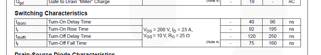

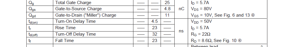

It's all about the speed. Since these parts are characterized to function as switches, the on/off delay times are your only guide to the max RF frequency it will amplify.
Here's the delay times for the IRF520.

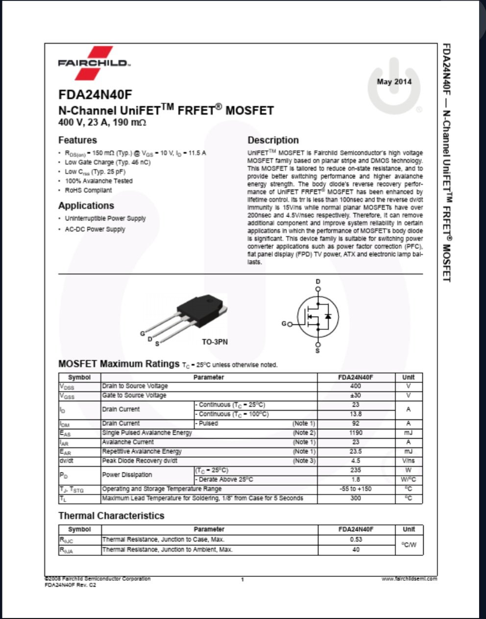

And here's the FDA24N40F:
The FDA part is at least four times as slow as the IRF520. Looks like you won't get any real RF gain much above 7 or 8 MHz.
Then again, don't let me discourage you from trying. I'll predict that your power gain from input to output won't be much more than about twice the drive power.

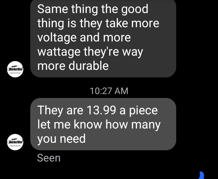

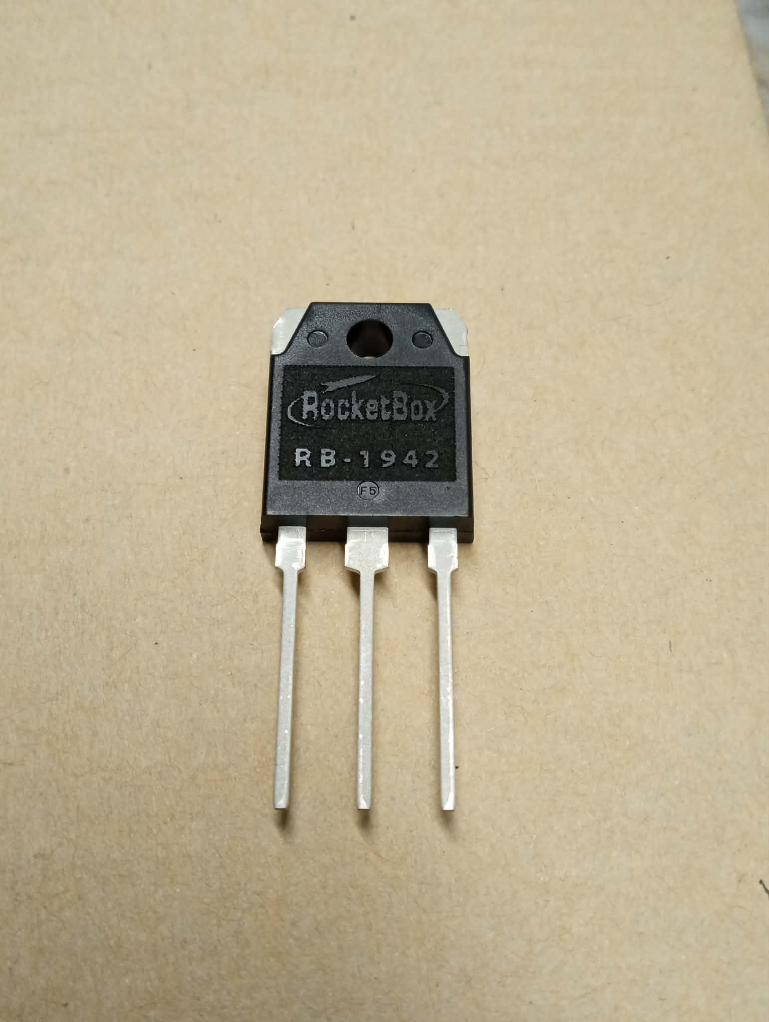

The ERF 9530 is no longer available.
Rocket is now building with this
The Rocket box RB 1942.
24 volt capable device.
Will update when I get more information.
Jeff
The rebrand continues.....
Reactions: Eldorado828
Replied

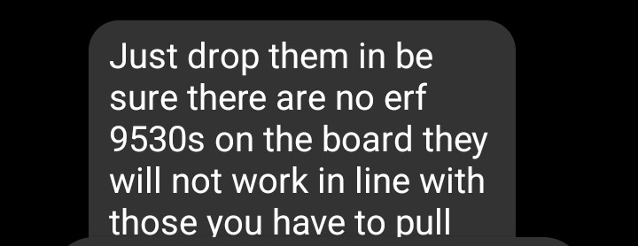

The new device will replace the 9530 but it's not compatible so you will have to replace all the the ERFs with the new RB part to repair the amp.
Current cost $13.99 each from Rocket.View attachment 76129View attachment 76130
I suspect more snake oil. Did he get the recipe from E. Lewis and now rebranding them as his own? It's hard trying to unwind the whole scam these guys are doing with all the rebranding of parts. What happened to the days where the oe number was just on the devices and we could source the part ourselves! These guys not only want the customer base to buy their amps, now they want them running back to get the brand exclusive part from them too. It's all about the money and who cares about integrity i guess.

The IXYS part looks promising:
The Fairchild part has been discontinued. The DigiKey listing is a drop ship from Rochester Electronics. Looks like they'll sell you all 150 in their stock or none. That company's claim to fame is buying up discontinued parts and getting a healthy markup after they spend years on the shelf.
The IXYS part is over 11 bucks until you buy 30. Then the price drops nearly in half.
Probably worth giving that one a tryout.
Reactions: NZ8N
The FDA24N40F looks to have way too much input capacitance to be good for 27mhz, even the irf520 has more than you would like.
