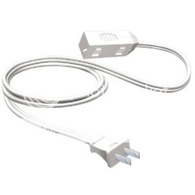

I realize you have already ordered a dipole, however, for future reference, or for someone reading the thread, here is a cheap dipole.
1. Use oOne 9' extension cord. $2 - $3
2. Cut off the female block end.
3.
Separate the two conductors back to the male plug.
4. Attach center coax conductor to one male plug prong.
5. Attach coax braid to other male plug prong.

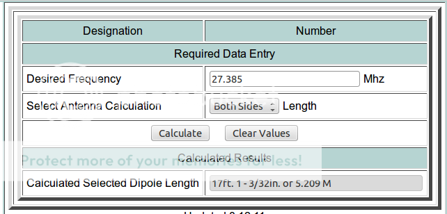

6. Fold back ends of both wires so each is 8' 6" long.
7. Hang this in the air horizontally.
8. Hook opposite end of coax to the radio and start talking.
What about SWR and all that? I've done this so many times that unless the dipole is really close to something conductive or the wires are shorted or broken the SWR will be so close to just right that the difference in performance in indistinguishable.

I have shown someone to keep the female block and terminate the antenna end of the coax with it so the dipole can be plugged into it. I did not advise it here because too much info confuses folks sometimes.
If it's too windy just use tape or string to hold the plugs together for portable work.

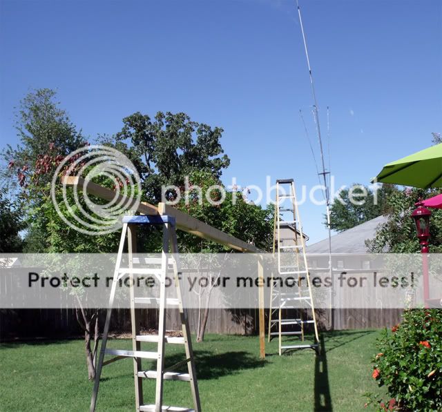

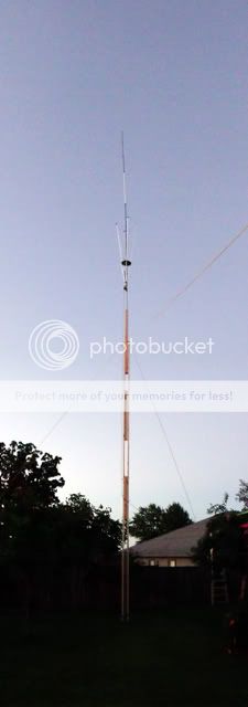

The next plan is to put up a vertical... I've decided to go with a Sirio Tornado. Since I cant mount it off the house , its going in the backyard. Im going to cement a treated 6x6x12 post into the ground and build my own mast out of two pieces of fence toprail, giving me 20ft of mast, which will be bolted into the post another 5ft up. So it will be about 25ft to the base of the antenna. Really hoping ill be able to work some local base stations with it and capture some of that skip that my directional dipole is missing.

You may find you'll need guy wires on the top rail as it gets flimsy when stood vertically. Also it sometimes will bend if you mount an antenna on it and attempt to walk it up from horizontal to vertical.
That is one reason why I built the wooden tilt over mast.
