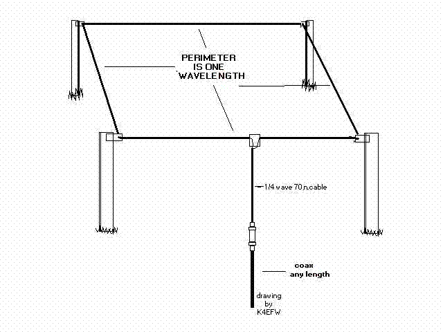

Good choices "Flat" top dipoles or Squalo's (horizontal loops) do very well. Height makes might and squalo's make a excellent choice as they tend to be more "omni" than a dipole, plus work well even at lower heights.

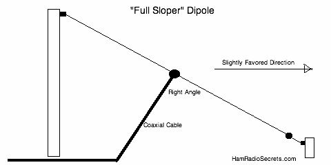

Also "Sloper" type dipoles offer some interesting options when able to switch between them to peak a signal.
Again positioning them different directions around a mast or supported by trees etc.

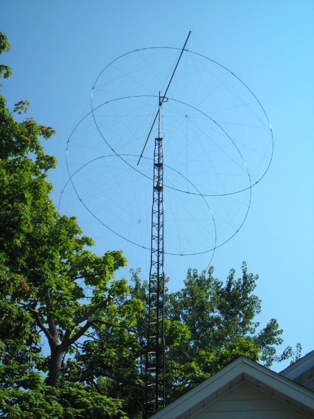

https://www.worldwidedx.com/attachments/ezo-jpg.28040/
That's not circular polarity. That is like a quad but with circular elements which according to theory raises the efficiency a tiny bit by using the geometric shape that covers the most area. It is still vertical or horizontal depending on where the feed point is located. Similar yagis are used on UHF and above and are called loop yagis or ring yagis.
