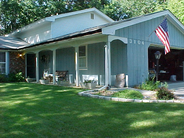

Just thought I would post an update. I was trying to get something working so I could make a QSO with a friend of mine during the Lighthouse Weekend event Aug 18-19 After looking around on here and the internet, I decided to try making a double bazooka for 20 meters. I had some RG8 mini so I cut it to length, used solid wire for the ends and strung it up temporarily as an inverted Vee along the peak of my garage roof in the front of the house. The peak of the V is at about 14 ft at most. I probably would not have $20 in it even if I had to buy the coax to make it from.
I got it tuned at about 6 pm and tried to make a lighthouse QSO but it was not to be, I think we were actually too close, about 30 miles.
So after talking to my friend on the phone trying to hook up on 20 meters, he mentioned that the North American QSO party was that weekend and I should try the antenna out on some contest QSO's. I have never operated in a contest even though I have been a ham since around 1970, but I figured what the heck.
Well I ate dinner and came back out to the garage where the rig is about 8 PM. Between 8 and 11 PM I made over 40 contacts to all four corners of the country and everywhere in between !!!! This was with my 30 year old TS520, no amp or tuner and the temporary antenna. I am really impressed with how the antenna worked and in the next few weeks I am going to move it up higher to the upper level of the house, about 30ft up, and see what happens. SWR is less than 1.5 to 1 across the whole band. I would like to try and get something up for 40 and 80 by winter but not sure if I will have time. Having a blast on 20 anyway :)
I added a pic so you could see where the antenna is mounted even though it is not in this picture. It is actually under the overhang on the front of the garage roof. I am going to try and move it up to the upper level this weekend :)
Just thought I would let you guys know.
