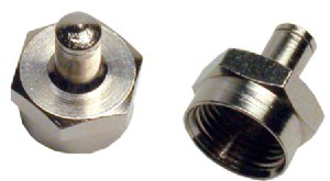

these are shorting caps for F connectors:
put these on any unused cable outlet in the house, and on any unused splitter outputs.
then go around the house an tighten all the connections just to be sure.
most times when someone is interfering with a neighbor's cable TV, it's not harmonic interference so the low pass filter shouldn't be the first go-to.
it's usually straight up overload because one or more cables in their system are acting like antennas because they are not properly terminated.
the cable installers by and large don't know what these are for, or when to use them, but once you show them a picture of one, they will say, "oh yeah, i have a bunch of those in the truck."
let the cable tech go do this work at your neighbor's house, and it should clear up the problem. if it doesn't, the problem is still most likely with the cables themselves and there is probably a badly shielded cable or a badly connected shield on a connector somewhere.

An incredibly high percentage of trouble we used to see in the old analog cable-TV days was from poorly crimped, worn-out or weathered "F" connectors.
The threaded plug like the one in the pic above has a crimped connection to the coax shield. Any resistance that forms between the body of the plug and the aluminum shield of the coax causes nearby signals to be picked up.
The coax shield should reject that stuff, but only if it's grounded to the body of every connector between the TV and the pole.
Every one.
Only takes one bad crimp to turn the outside surface of the TV coax into a very long receiving antenna.
The cable-guy term for this problem back in the day is "ingress", meaning that an outside signal has leaked into the cable-TV coax.
Every case of this that we solved began with finding out where the RF was getting in.
Can't easily plug the leak until you know where it is.
