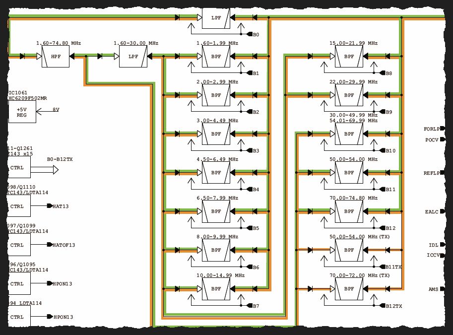

Since the filters of the 7300 are wide as barn doors and the FT991A are just tighter

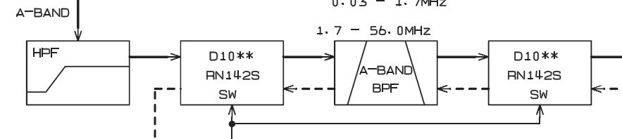

If you call that tighter filter in 991a...
and same part in 7300
Obviously you have no idea what you are talking about.
Maybe in stead of selectively putting up just part of the 991 A schematic, produce the full schematic of the front end including band filters.
Most of the OVF warnings of the 7300 come from bleeding commercial stations into the hambands because the 7300 filters are barndoor wide, specially using broadbanded antenna's.

For example, the 7300 bandfilter for 20 meter is runs from 10 to 15 MHz, as said barndoor wide.
