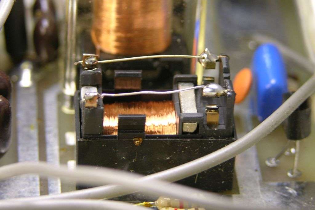

The part number printed on the relay is your only hope of getting a drop-in replacement. Relays that size don't always have the same pin assignment. The specs for the original part will define what can drop in and replace it.
Just need that number to find the specs.
And if you just don't need a preamp, a wire jumper can fix problems caused by the preamp relay. I'll see if I can dig up a picture we have for the relays with the clear cover that pops off easily.
Found the pic. If your preamp relay looks like this one, you can totally avoid removing the printed circuit board from the amplifier this way. Won't have a preamp any more, but the flaky preamp-relay problem will be a thing of the past. The wires are fairly thin. Removing a strand from a thin stranded wire should get you what's needed.
