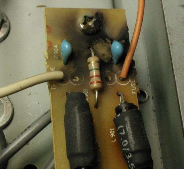

He finally got the radio back from the shop he sent it to and they told him that the radio was struck by lightning and it wouldn't be worth fixing, so he decided not to have him pend any more time on it.
Most of the lightning-surge damage we see enters the radio by the power cord.
If you see this, there may be multiple faults from a surge this size.
This one was only a little more subtle. Popped the disc cap in half, rather than scorched it.
The flash burn under the line-filter board should always get your attention.
