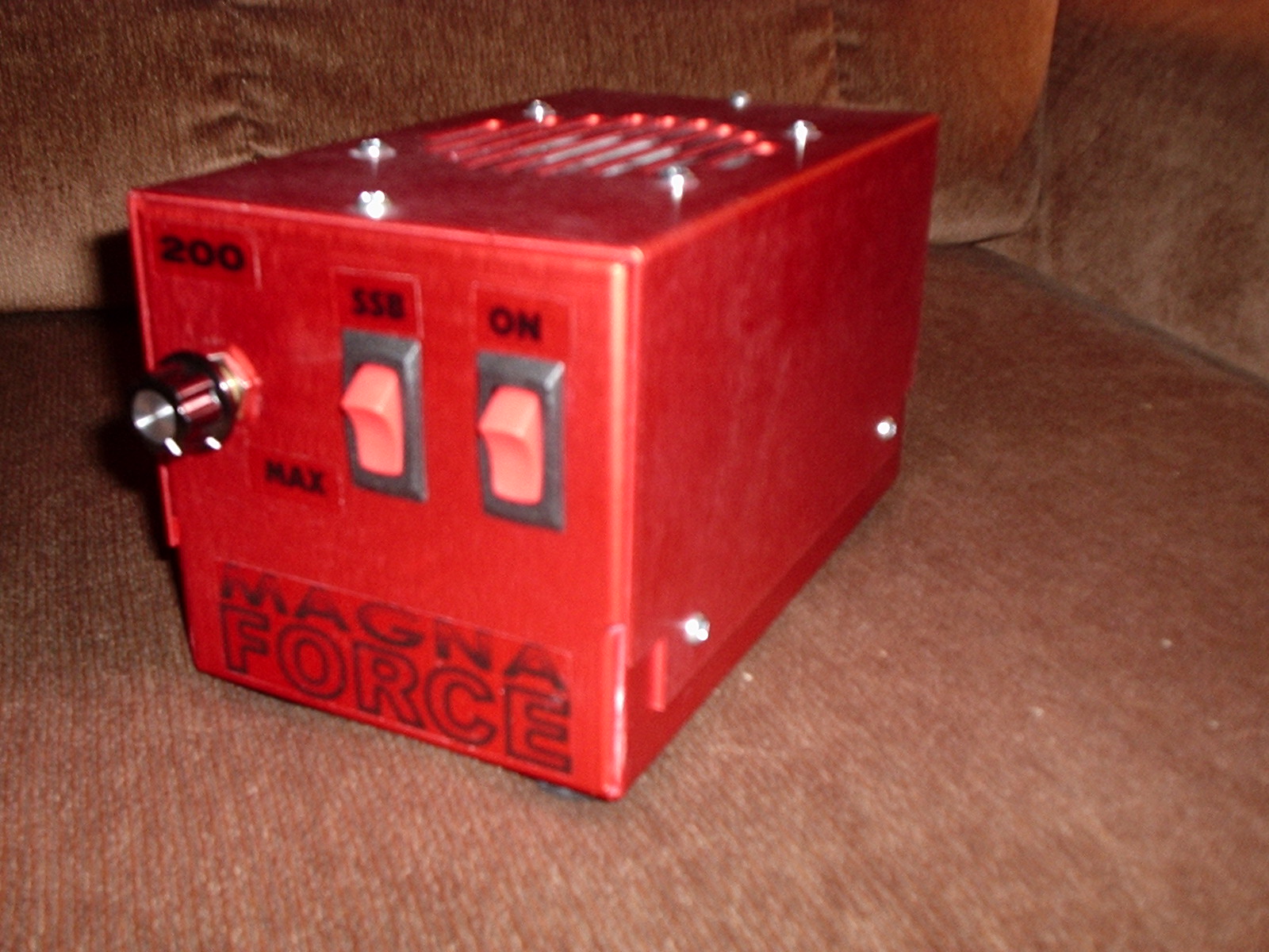

I guess for me "older amp" falls into the late 1990's to early 2000's category. I was really thinking a class B Magna Force from X-Force would be great. They made a straight 6 pill that was a beast. Pictured below is a Magna Force 200 I had. Since Karl built them i'm sure he could still do it now.
Years later X-Force changed these to black and called them a TnT (not the same as the TNT amps from the 80's) They were still class B and performed like a good comp style amp should.

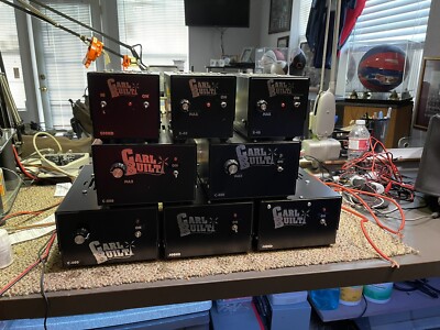

As an update I found this on e-bay, which should be the new version of what I was referring to.
