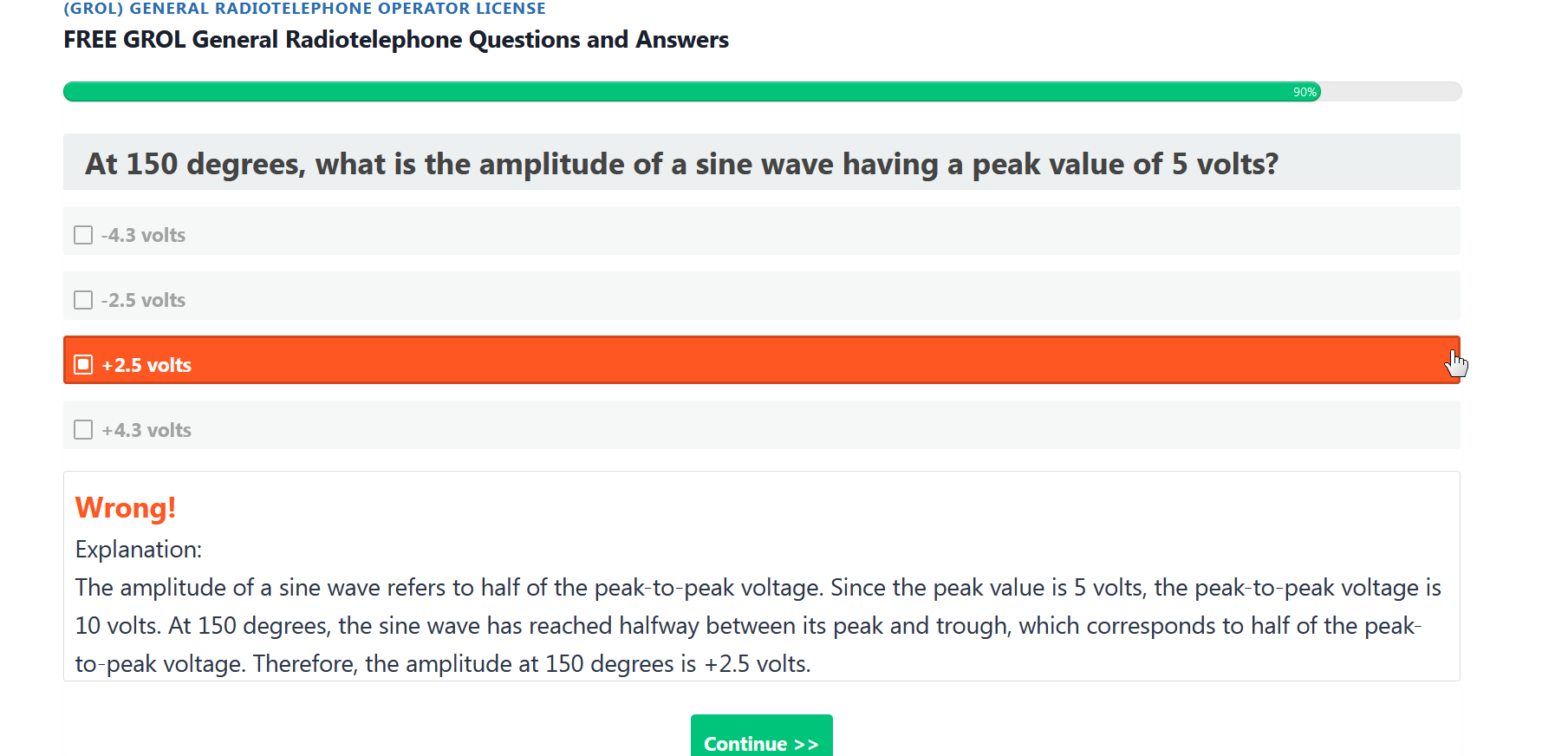

Can someone explain this one to me?
2024-10-11 13_19_20-FREE GROL General Radiotelephone Questions and Answers - Practice Test Gee...png
I took a different practice test elsewhere that had a similar question with the same answers. On that test, it asked about pi/3 radians, or 60°, so +4.3v is probably what they wanted and simply mistyped the question.
