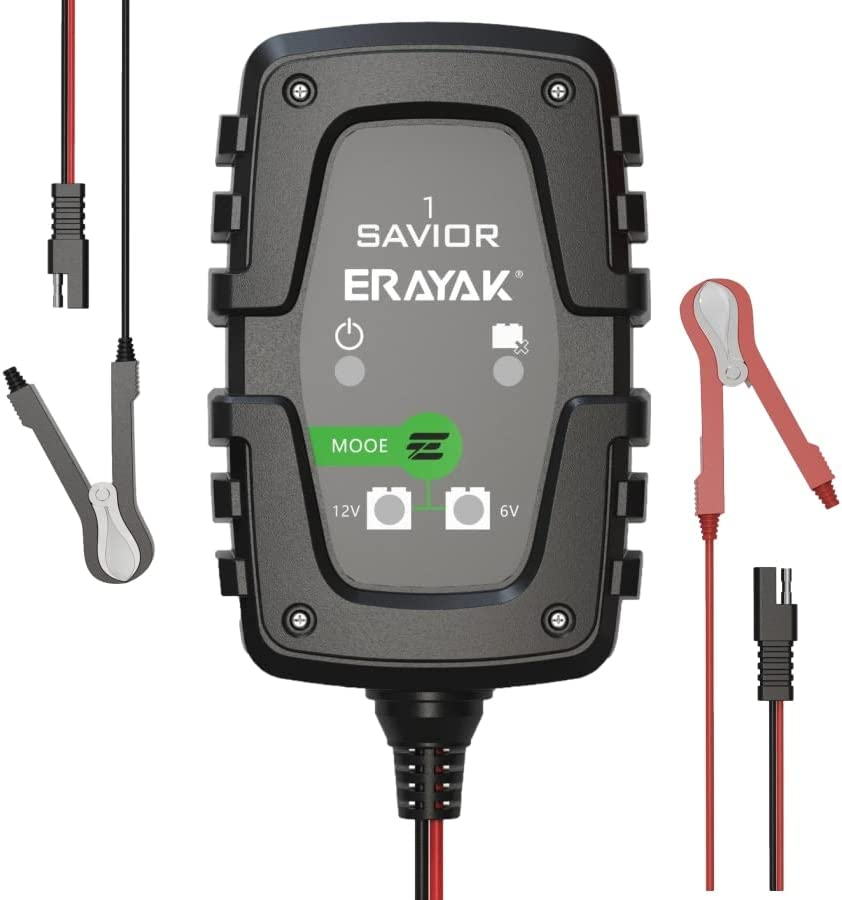

Well, I hooked up my 6 volt (6.31 volt) 5 amp hour AGM battery with this charger:
Was $9.95 on Amazon, but "currently not available" but there are similar cheapo units available.
No more noisy wall wart. No more D cells.

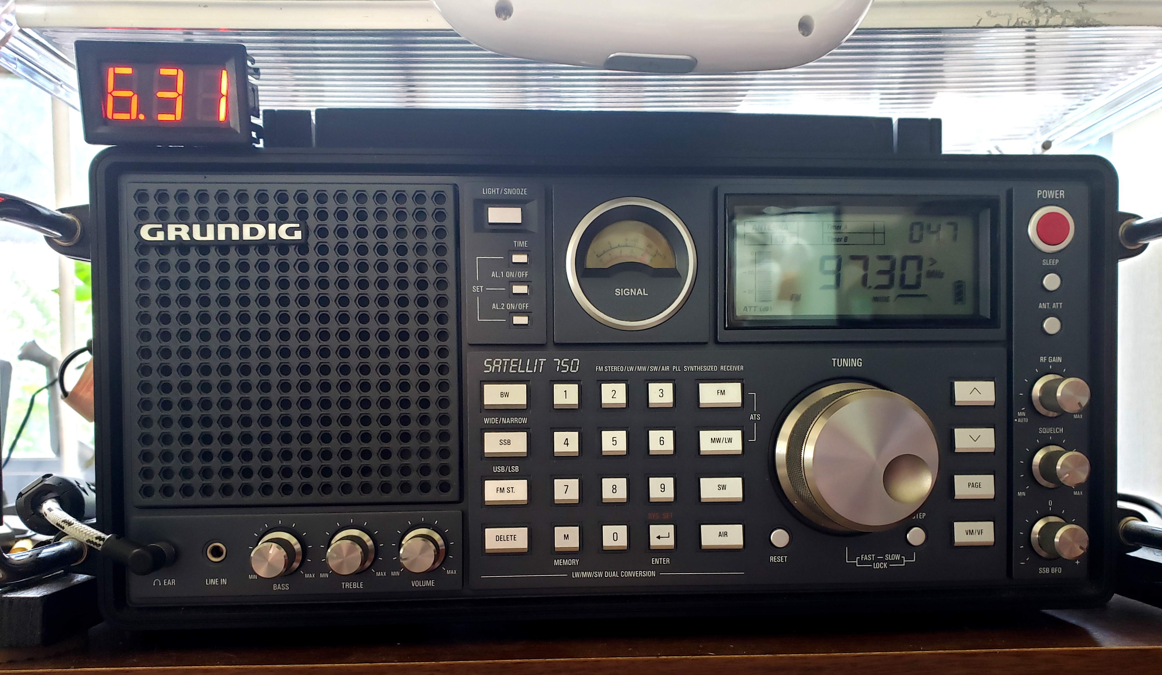

Strange. The hum-inducing 6 volt wall wart I was using generated 10 volts and didn't fry my Grundig. A miracle. Lesson: Test voltage output before using.
The AGM battery together with the charger doing its charging thing noise-free generates only 8.3 volts, so I'm not concerned about that.
I also installed a cheapo volt meter on top of the radio - see photo.
