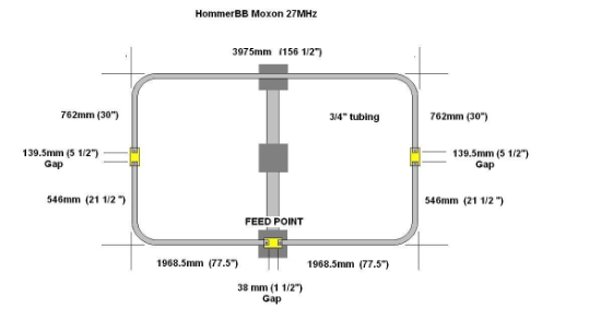

Here are the dimensions I used for making my all metal tubing 11m Moxon.
As for the placement of your feedpoint wires, that shouldn't matter except for in one small detail. If your peeling back a coax pigtail and connecting to the feedpoint the length of the peeled coax ends will add length to the elements overall length.
It seems to me that your antenna may be too long for 10m. The SWR is getting better going lower on the band which indicates it may be tuned down in the 11m band.
If it were me, I would use a Moxon calculator to see what it suggests for antenna dimensions and compare them to the MFJ dimensions.
