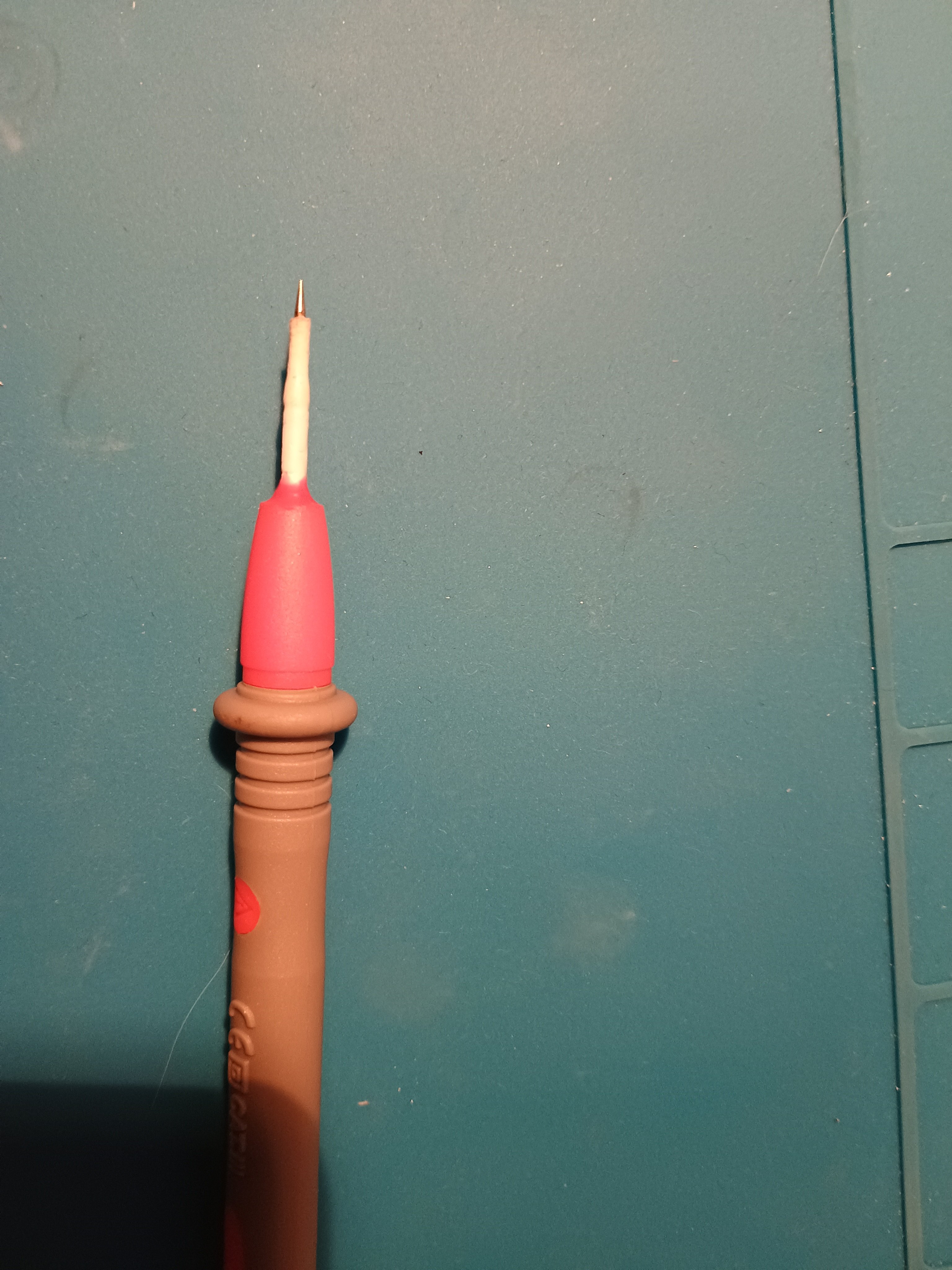

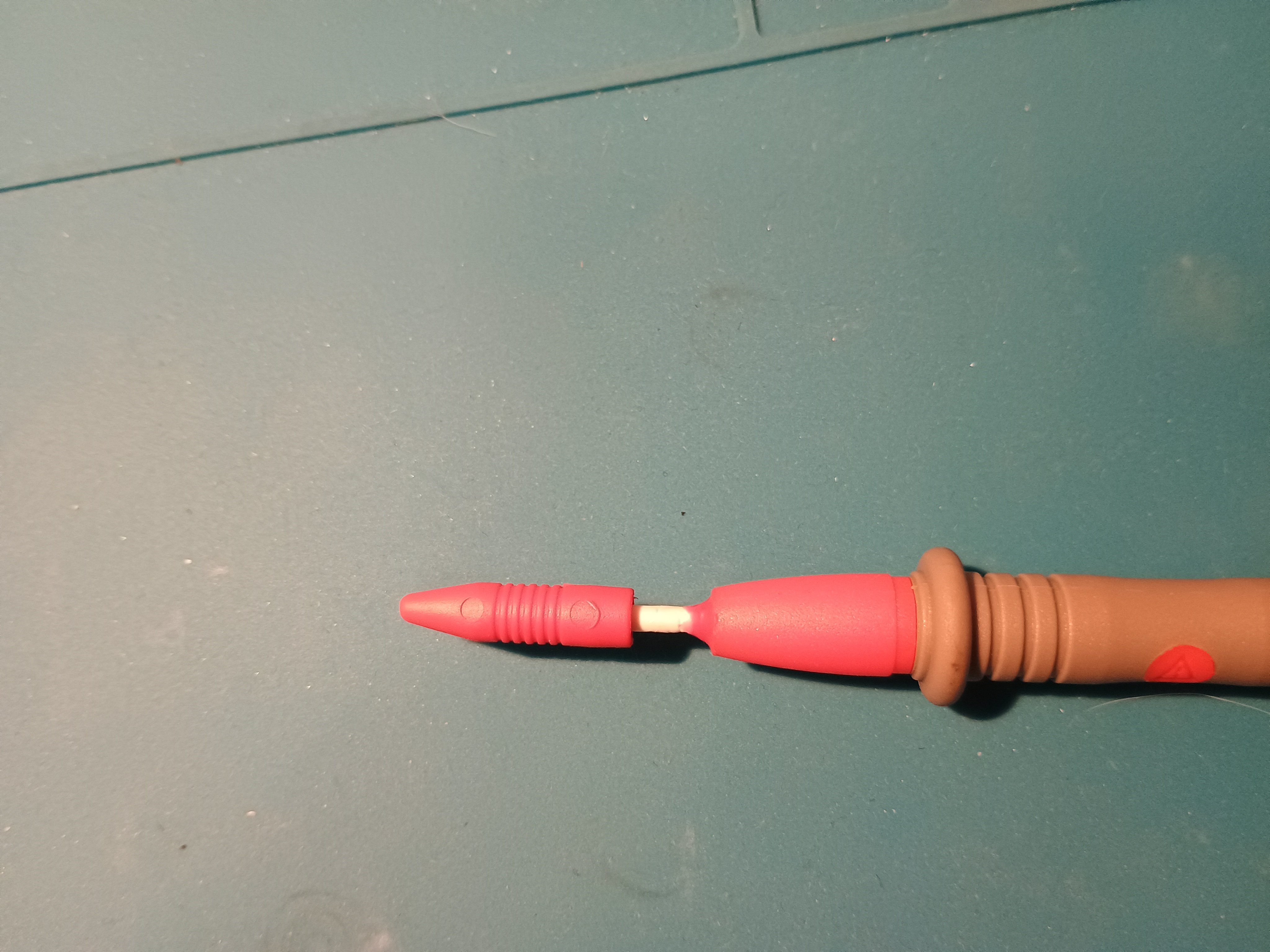

I made one little tweak to them, it's really only the sharp needle part I need and when you're poking around in areas with your DMM where you can short out things very easily I wanted a little extra leeway..
So I added a little extra heat shrink tubing around the rest excluded the tip. As you can see it even still fits the protection cap on top. That extra heat shrink saved me a few times already.
Probably should redo that again soon with some red or transparent tube.

I also use the heat shrink to cover the shaft. I have a long thin screwdriver insulated the same way so I don't short out something getting to the adjustment/screw.
