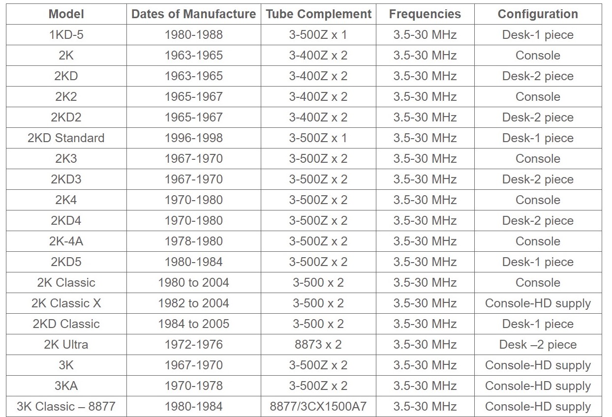

Hmm. The "-3" version was made in the mid-60s and used the 3-400Z tube of that era. The 3-500Z didn't hit the market until 1970. I'll guess that some adaptation has already been made to prevent the plate cap from shorting to the shield cover. The 3-500 is taller.

The Henry 2k3 I have came with 3-500z's. According to the manual, that's what it came with from factory.
These old amps are great looking. Nothing today has the same appeal to me. I guess we'll see how I feel after some time off operating it.
Well, then I'm out of sync and thinking of the "-2" model. Shoulda looked it up before putting my foot in my mouth.
Just looked at the manual, and sure enough that's what it says. I think I know what fooled me. The front cover of my 2k-3 book says "Los Angeles 64, Calif" after the street address.
