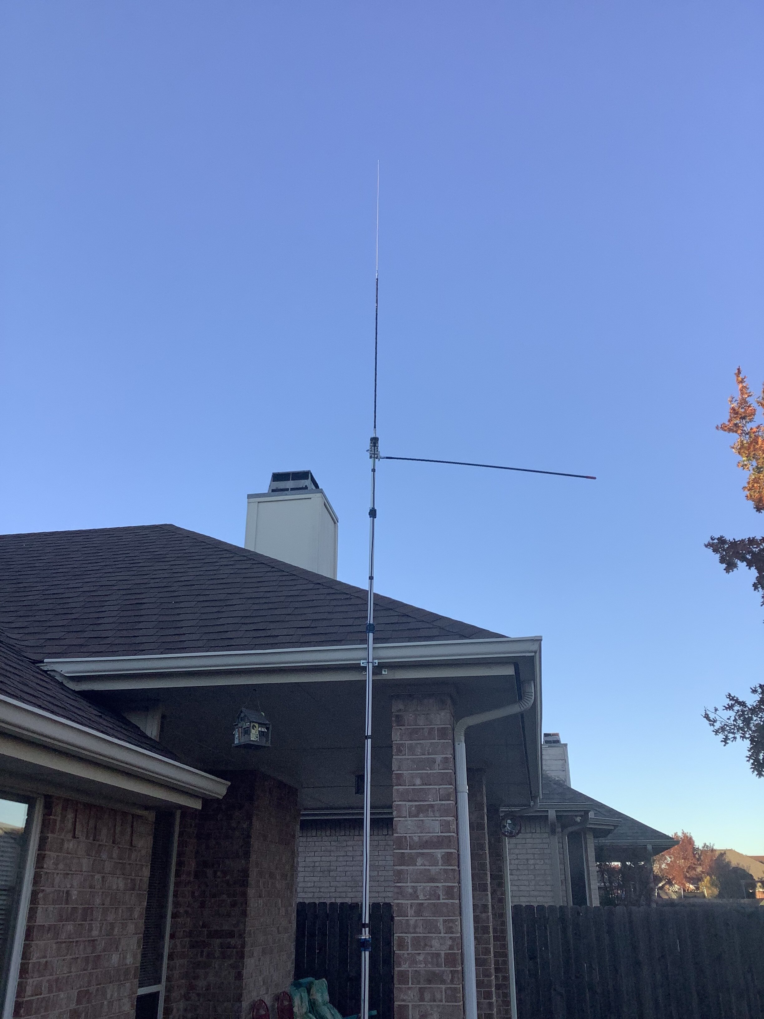

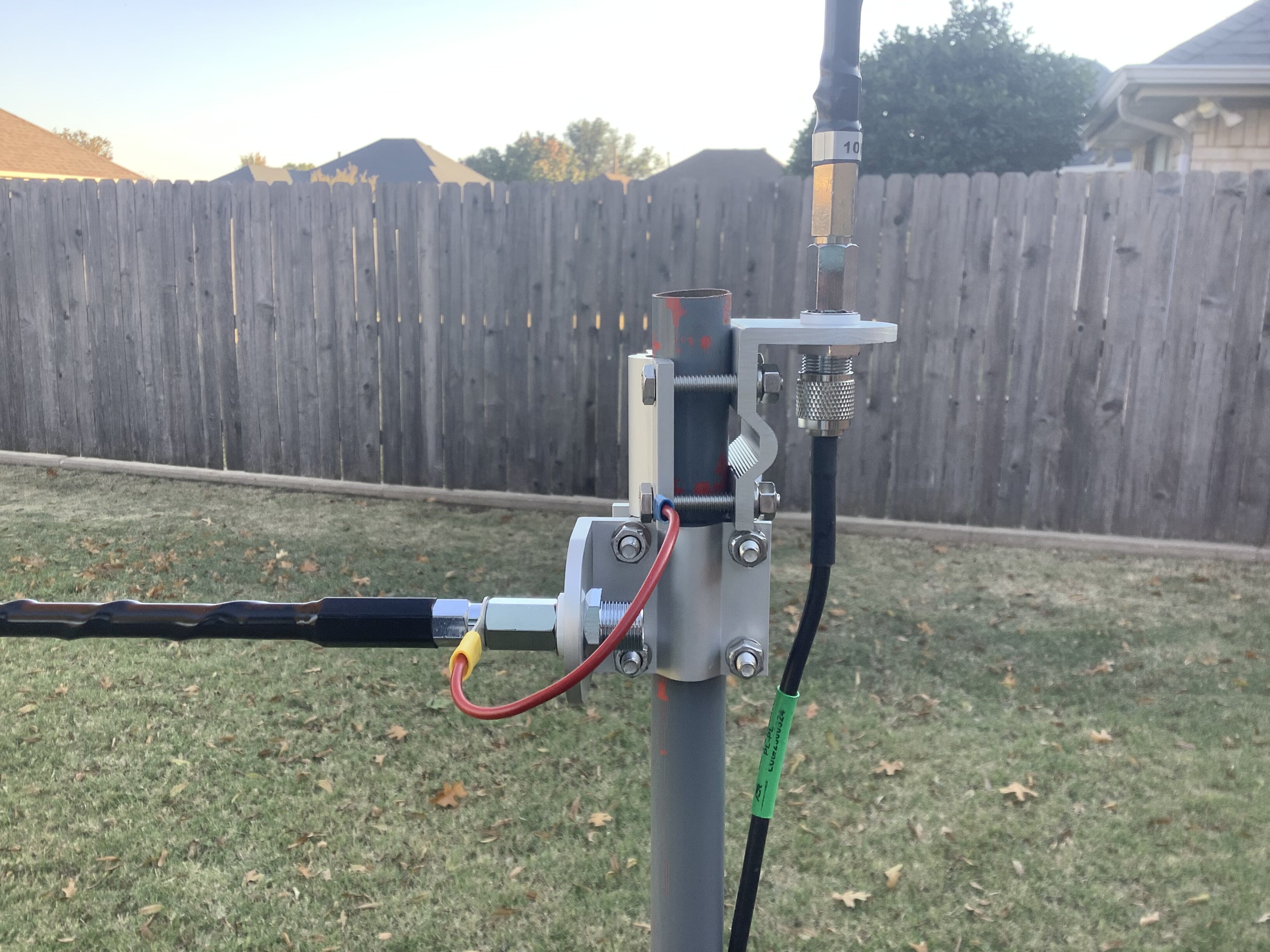

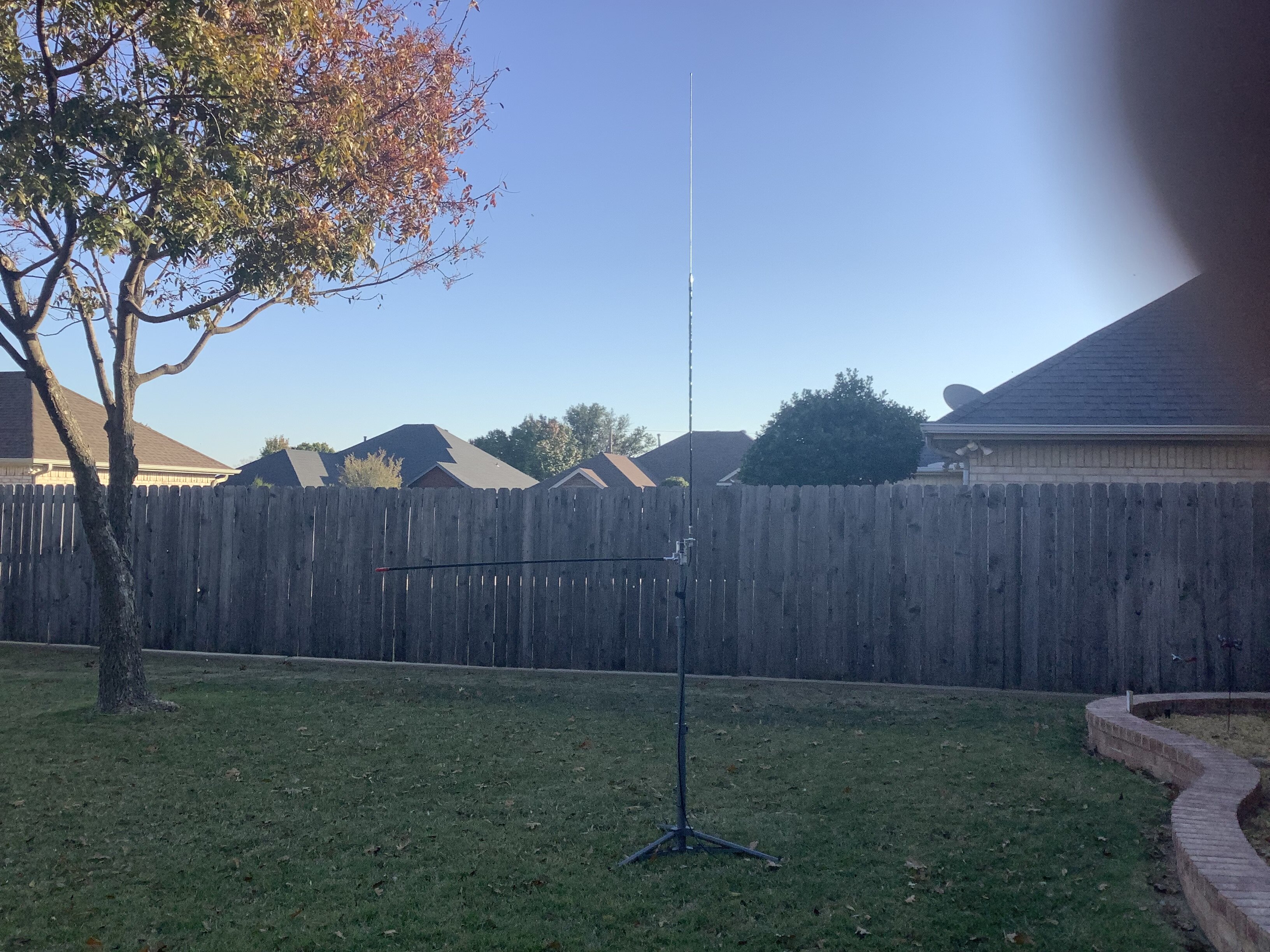

Changed the location and altered the angle of the wire radial.
The locals’ signals went up a somewhat and they are receiving me stronger as well.

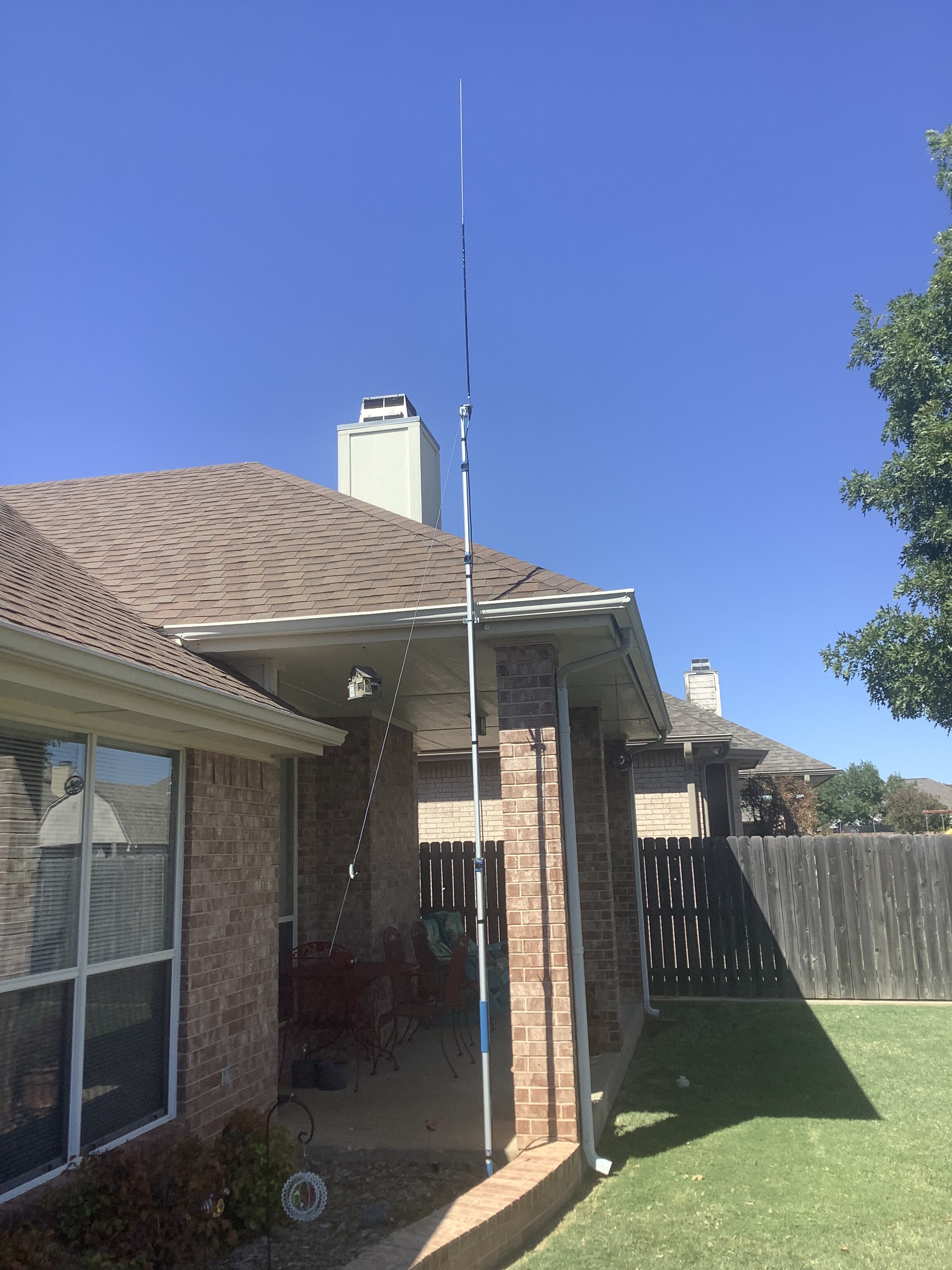

Replaced the wire radial with a 4’ Firestik. The Firestik has a tunable tip making SWR adjustments simple. It’s flat on 20 and about 1.1 on 1 and 40. Now just need to get it in the air. :giggle:
Jim, what antenna are you running on the top there (the vertical one)?
Note: The title of this thread says “10 Meter Ground Plane”, but this one is a CB antenna. Somewhere in the thread, I switched over to 11 meters. :p
