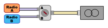

But if you have it set up like this...
1642947234573.png​
The problem lies in the way the switch - moves its contacts.
Shield to shield is common, but when a contact opens - it can act as an antenna - so it should be considered when you push a LOT of power back thru the switch.
The Radio on the active would have full CENTER contact to the one out,
But what does the contact at the unused side - what does it exhibit?
Might want to check that out before you get too far.
Yes, exactly. The switch between the radios and the amp. that was the plan.
