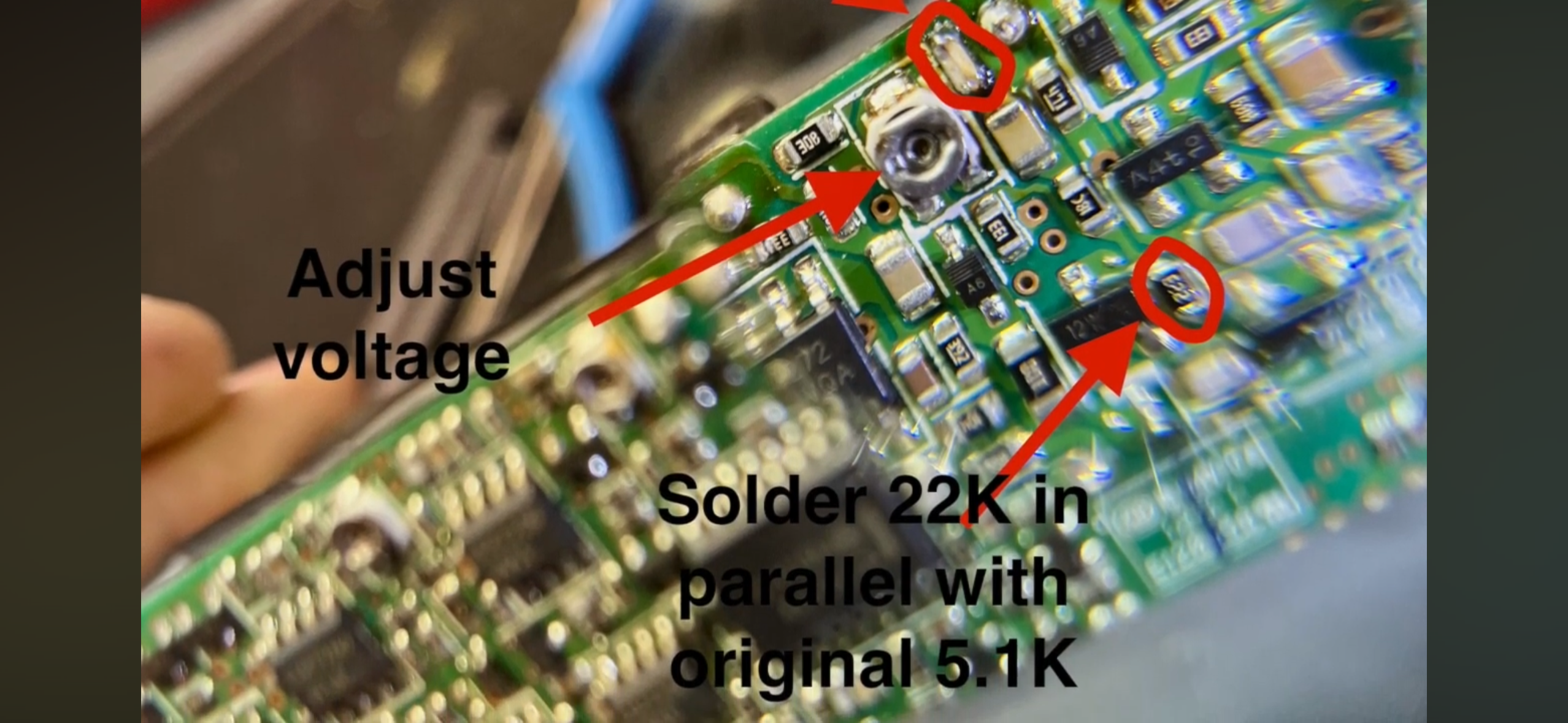

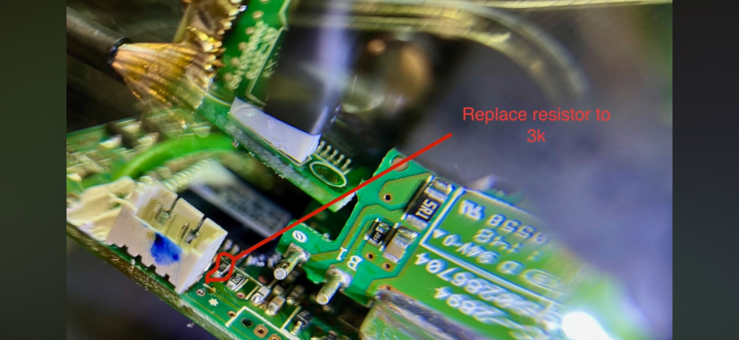

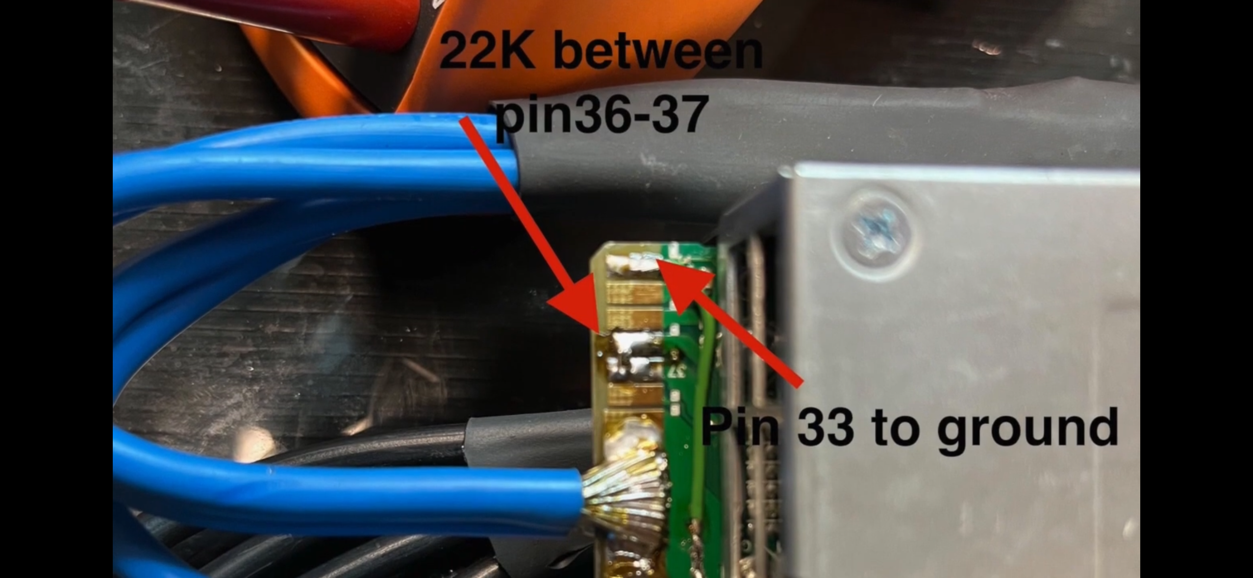

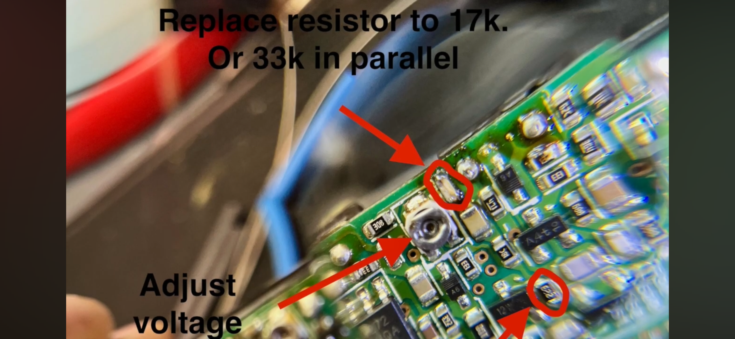

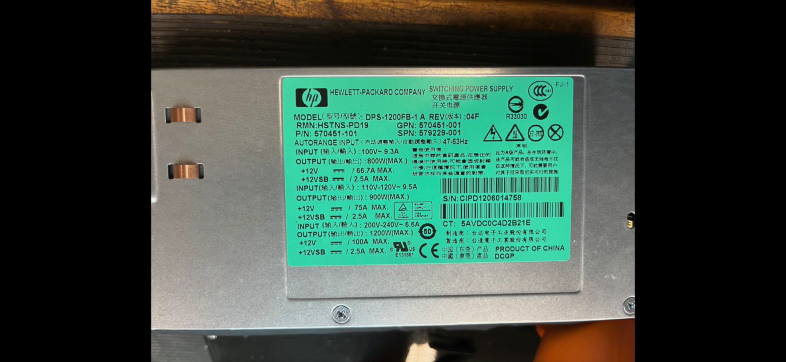

Anyone know if this is correct Mods for this particular power supply? Any input is appreciated.

I recently replaced toshibas with HG pills in my x-Force straight 10 pill. I removed the original unregulated power supply as the HG are sensitive to voltage swings. Planning on stacking 3 of these to replace the unregulated supply. They are dozens of different versions out there. This is the only thing I could find on the PD19 version.

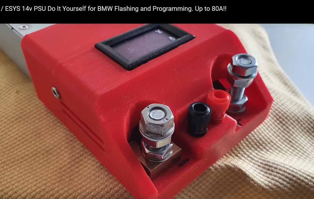

Here is a project that I am currently working on. HP 1200w, 80A @ 13.8v. I've got a couple of them. Got all the parts together, just need to 3D print the cases.

The mods to make certain of the dps1200FB work for me aren't clearly available so I went with the DPS-1200SB A version. Lots of info out there for that one. There are a few FB versions and the mods are different.
Put the model number in youtube and you should be able to find a few posts on how to modify it. If not, I can link it here. I had this model on my list of looking into it.
Thanks, I did, and purchased 4 of them, although I was a bit confused about the added S in the model, as the videos don't include it, instead showing only HSTN, maybe it's a slimmer version? I will figure it out when I get them. I have been on the fence about these for a few years. I have used PC power supplies in the past to power equipment.

They came in today, the conversion is simple enough, but I'm waiting on some high tolerance resistors so I can set them exactly and stack them. Will I need 400 amps? Probably not. But at least I will be able to test the big amps that come through and not break a sweat. Plus, if push comes to shove, I could jump start my truck or power the flux capacitor I have been hoarding lol.
