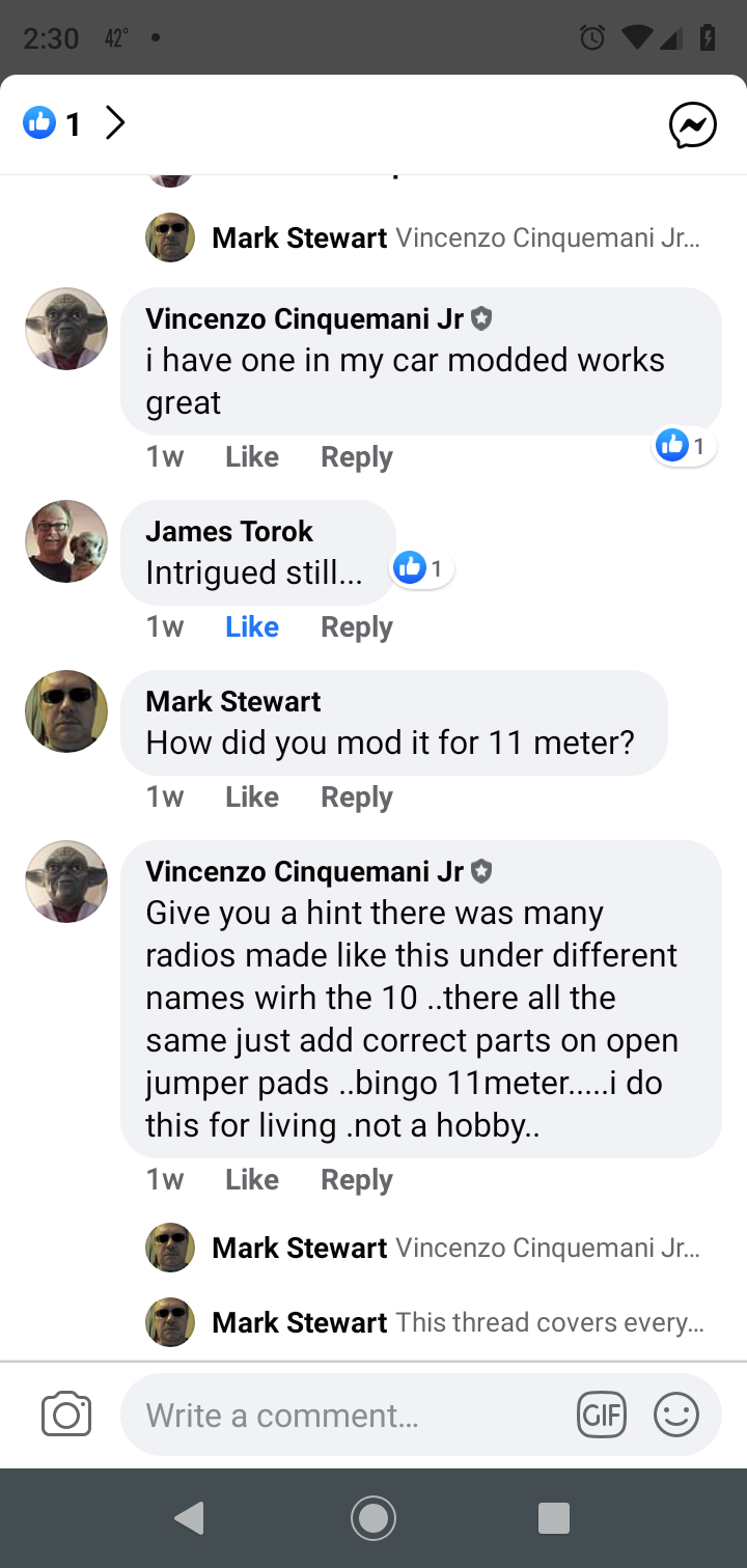

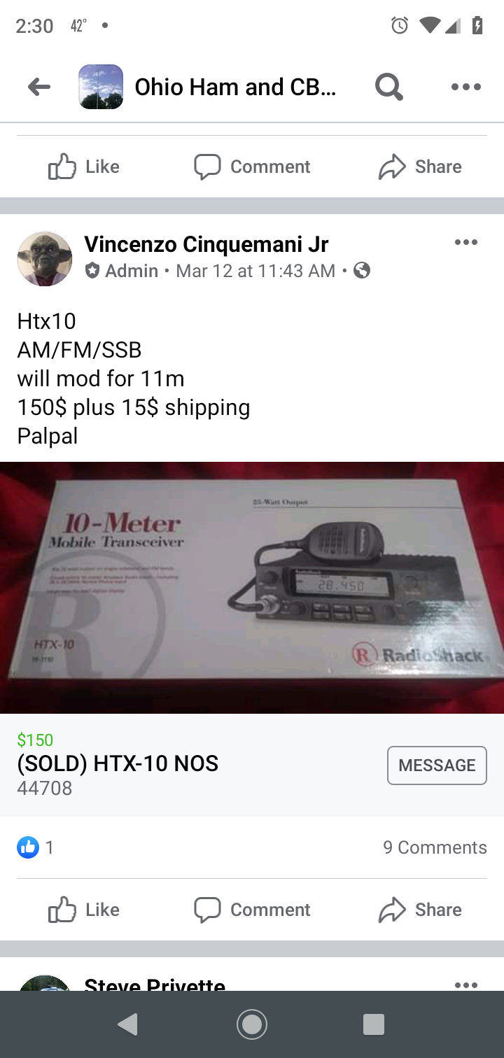

I recently seen a local Facebook post which had a NOS HTX-10 for sale. Dude wanted $125 for it. His ad mentioned it could be modded for 11 meters.
So, is there an actual working mod for the HTX-10?
Reactions: Rwb
Reactions: Rwb
I tried telling this fool it can't be done. Said all you have to do is change some resistors and such, before reminding me he does this for a living and not hobby. Guess the new owner will find out if he decides to convert.
Lol, then tell him you will give him 150 for it after he mods it and shows you it works.
He's just a dumbass that doesn't want to be wrong.
