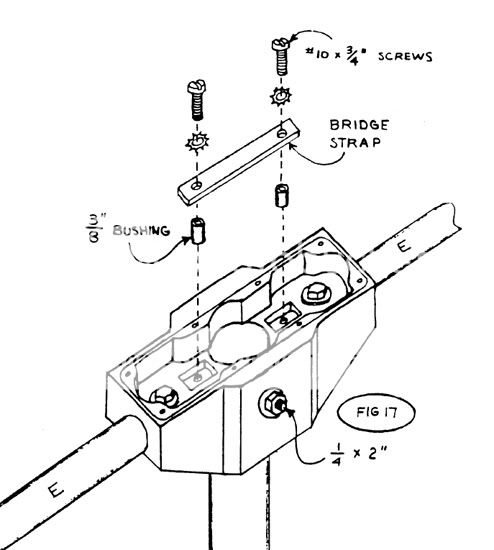

All that would be necessary to make the hubs conduct is a metal strap in the hubs with set screws into the spreaders making everything mechanically in contact.
Similar to this:
That bar is the conducting strap in the center insulator on the top of the Astrobeam. It served to keep the upper part of the element in contact with the lower part as the Astroplane portion was misaligned from normal on the beam.
