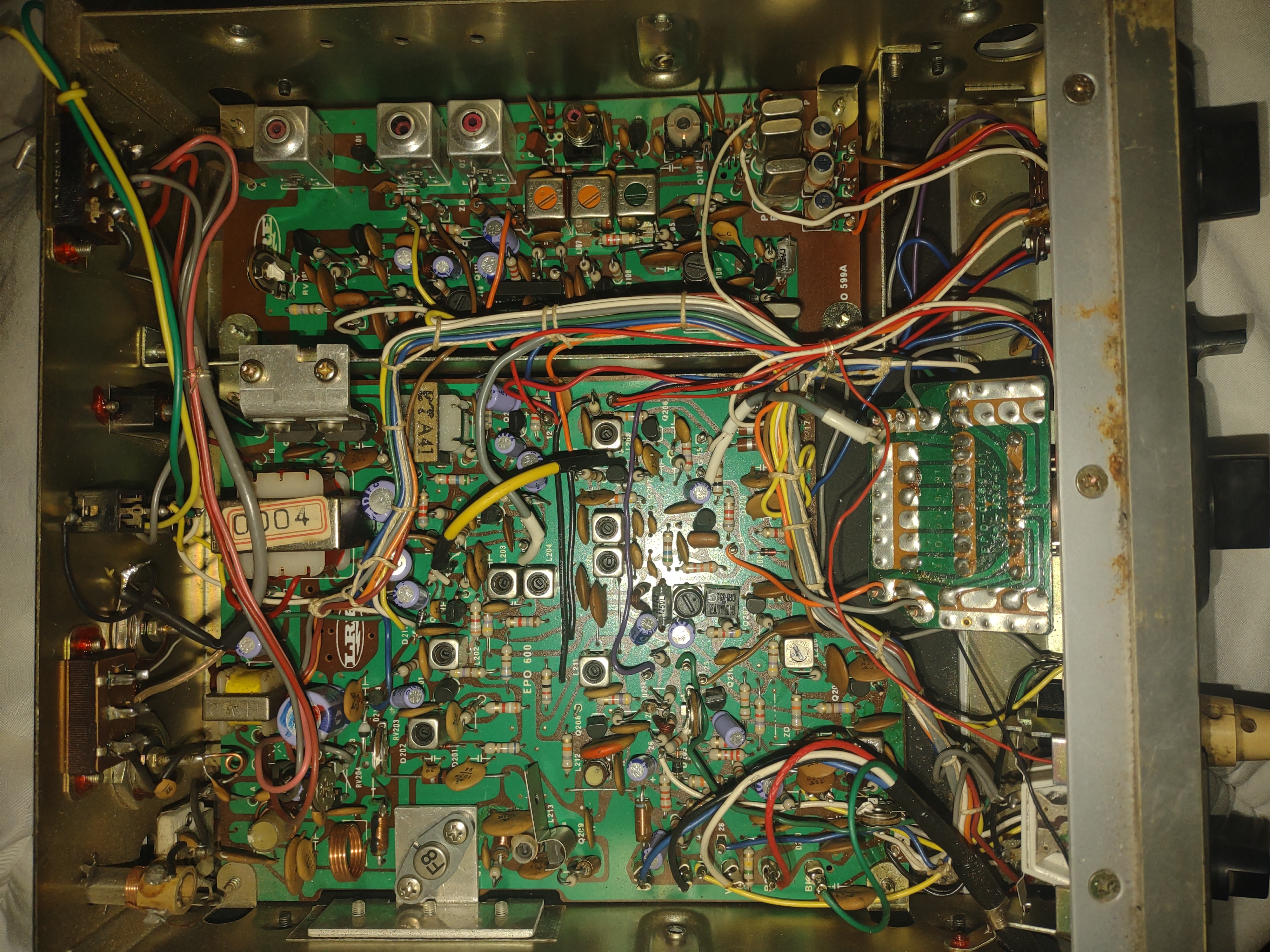

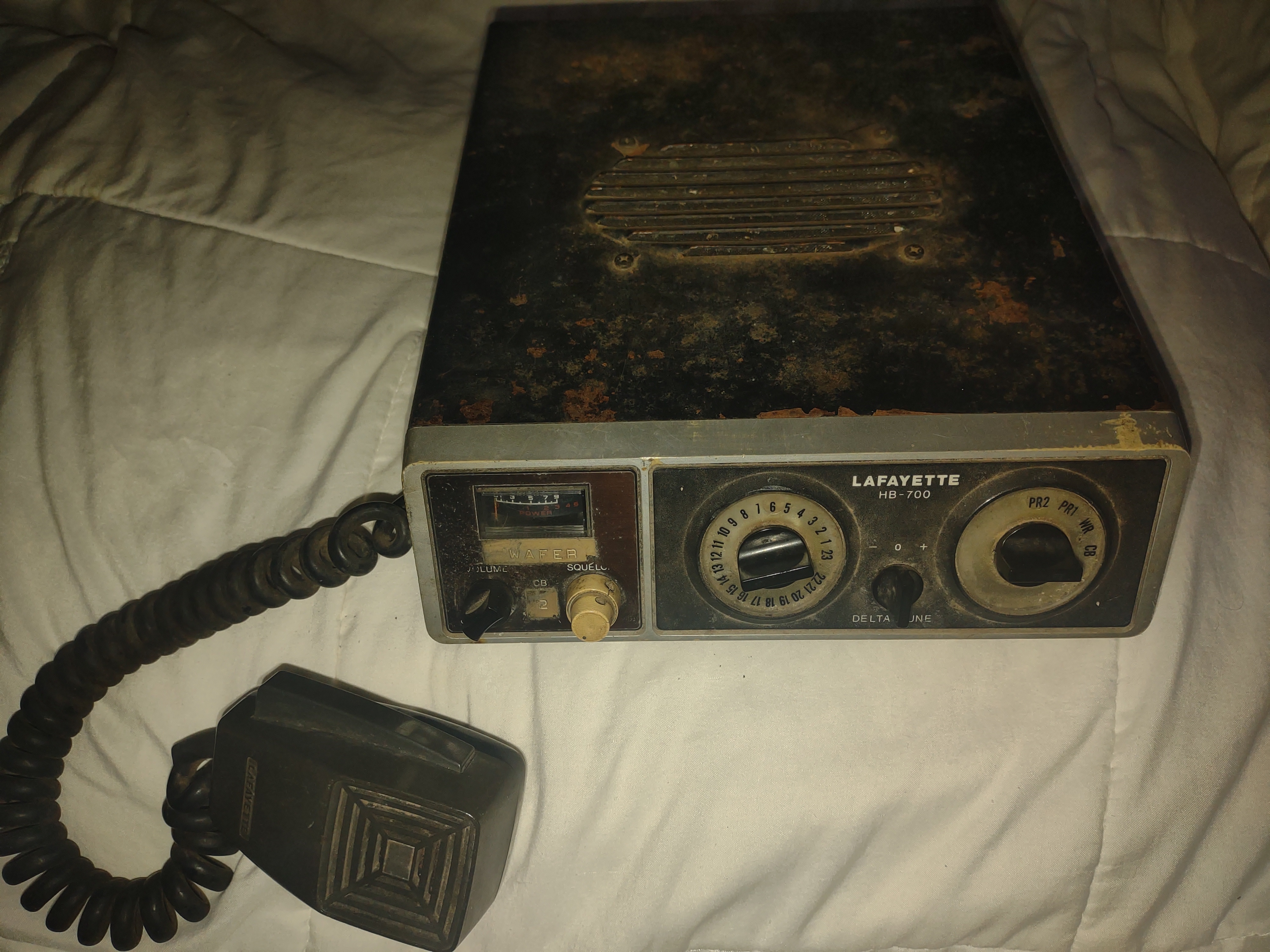

My better half got mad last week because I always work on radios for friends, but I never make any real money doing it. So trying to settle her down, I said (and I shouldn't have), I'll just try to fix all the broken ones I've been given over the years and try to sell them on ebay. She took me too seriously and now thats exactly what she expects me to do. So first up is a lafayette hb-700. Its a bit rusty and not much to look at, but after looking inside and seeing that board, I like it! It even has two crystal sockets and I wish I had beter DDS skills because this thing could really be something with one of those plugged into the socket! (edit, i think its vhf only there). I almost want to nickel electroplate the covers, not sure how far to go with it or if its even worth it.
Heres the before. Whether or not theres an after is still uncertain.

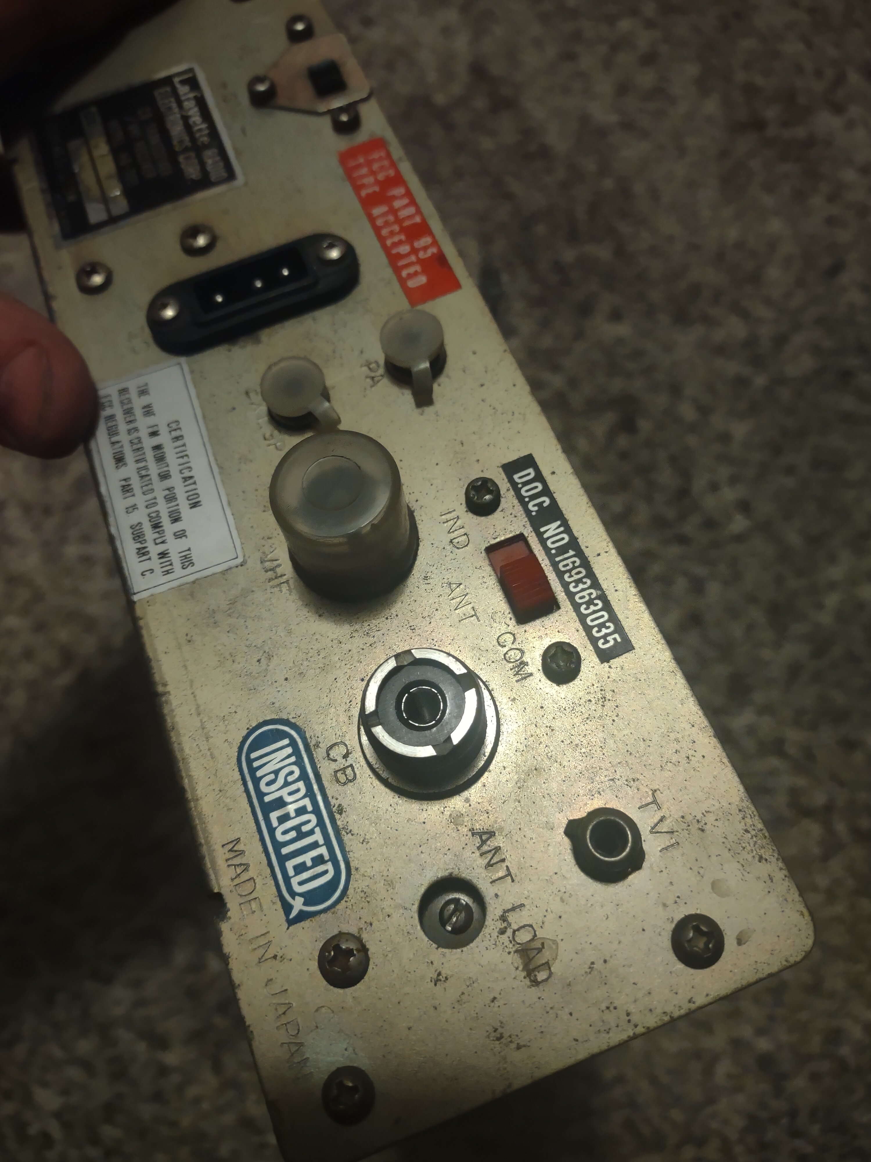

This thing has an adjustment on the back for the 54MHz trap and for antenna matching. I've never seen a transistor radio with that before, I'm too young I guess. I bet that ant adjustment would make getting a good SWR into an amp a lot easier.

There must be some serious chemicals in our atmosphere. I recapped the radio last night and decided today I would sand down the covers and bezel and repaint them. I am 45 miles from the nearest large town, nearest neighbor is 2 miles away, and there is only a slight breeze. The last time I saw that many fish eye's in paint was when someone used silicone spray on the door hinges in my old neighboors paint shop. Something is definitely in the air today. Anyone else having problems painting outside? This was never an issue for me 10 years ago.
