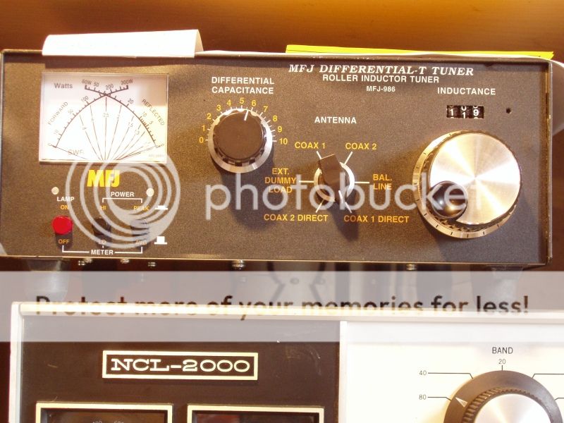

Here's a couple dandy's...not priced to badly
Both will give good service and will last a lifetime even at Legal Limit...

I've been using one of these for several years now and had no problems. Usually pretty cheap.
