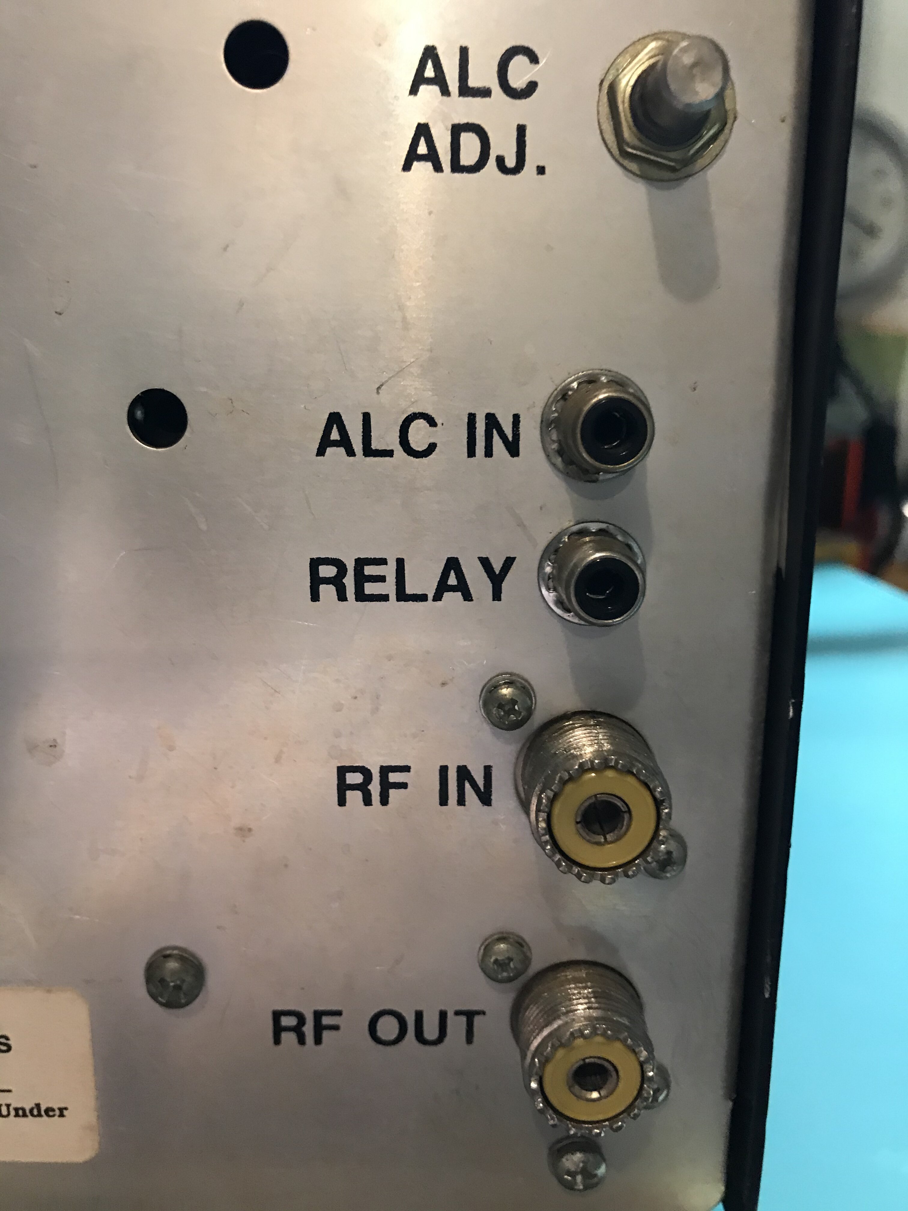

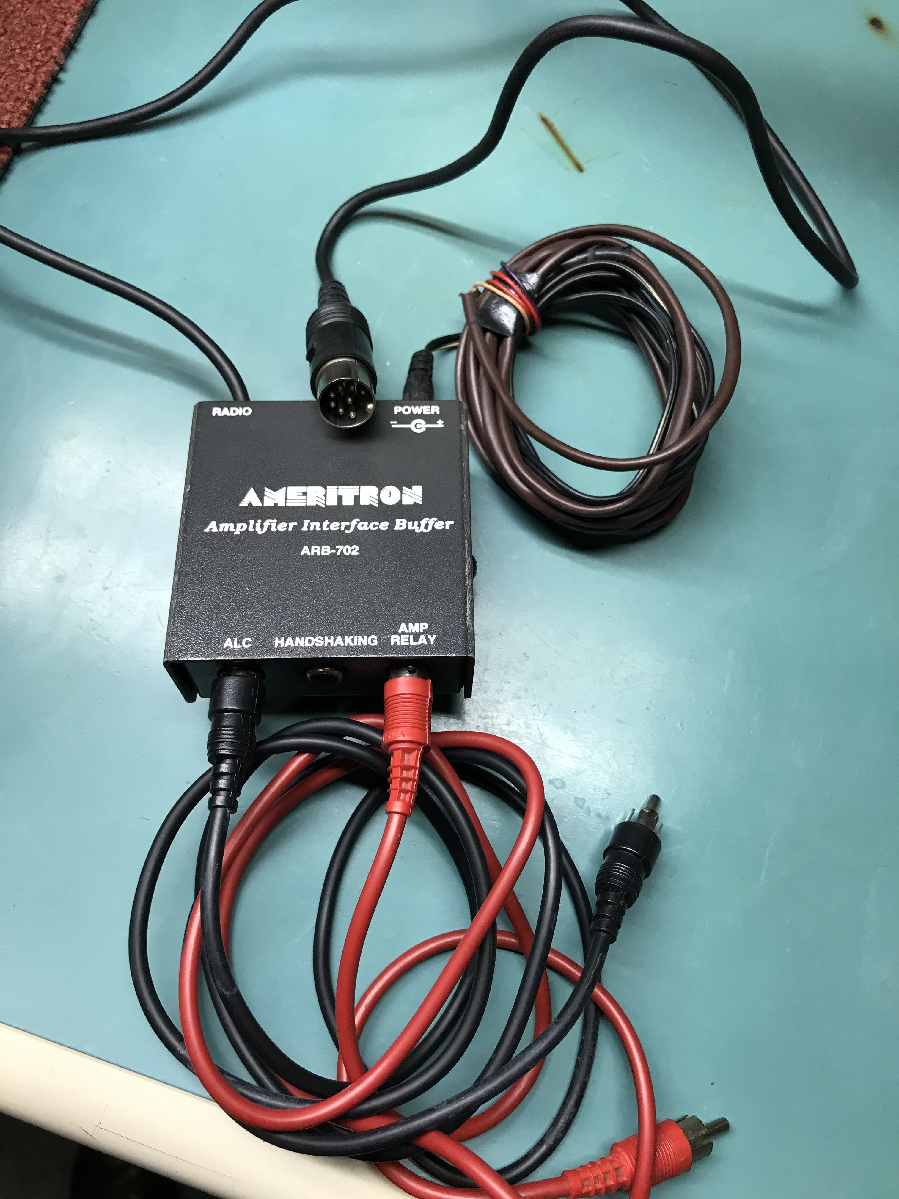

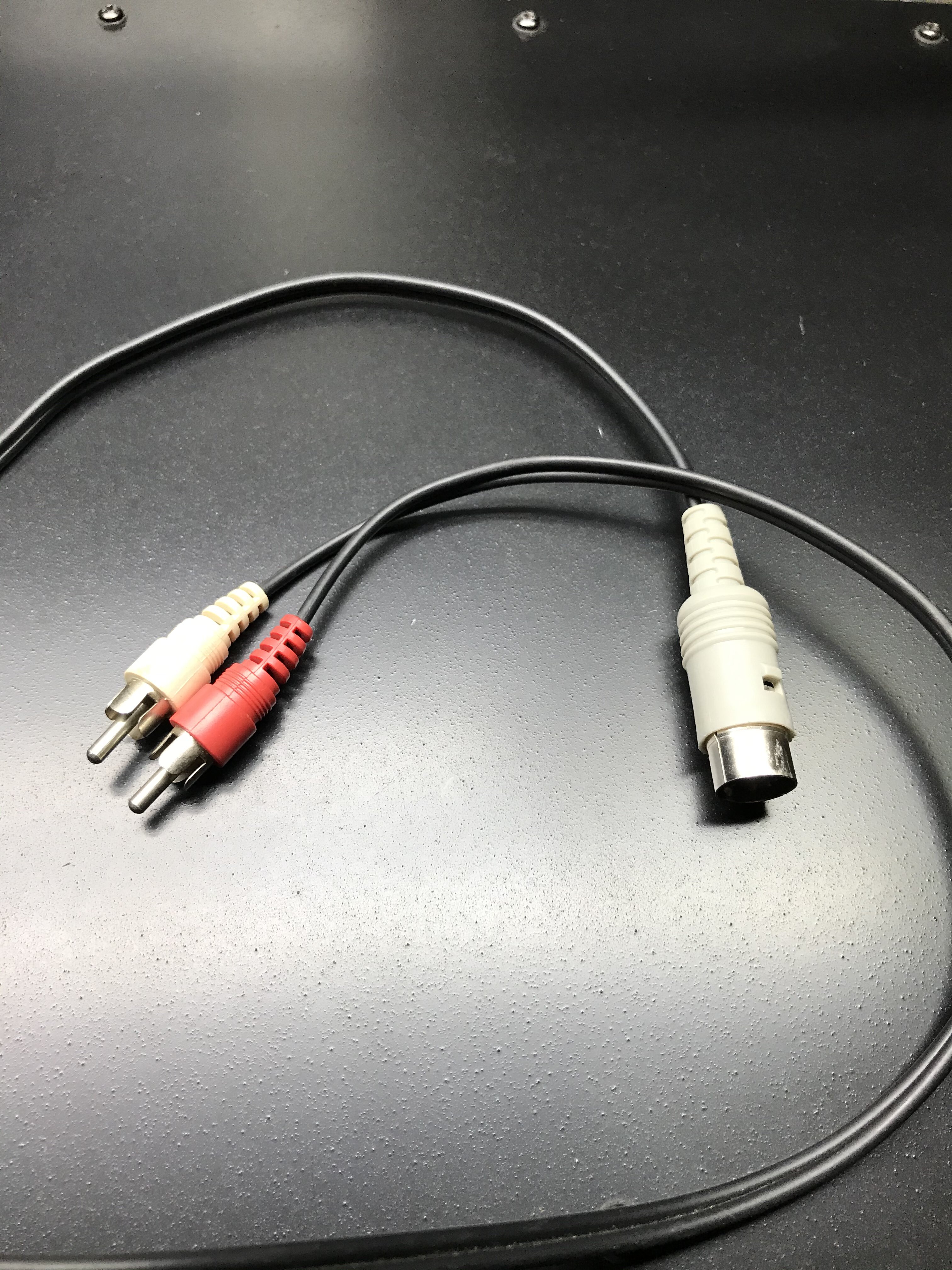

1st time playing with fire .I hope you can help me on this experience. The amp has 3 new bulb A811a and wend i turn on. I have 1.8 plate voltage on STBY. Thank you in advance.Also I need to know is the ARb-702 box run with 9-12 volts .o if I used de grey cable only with pin 2 ground,pin 4 red , 6 pin center white and shield ground.

My Arb 704 runs on 12 to 13.8 volt, i bet your 702 does as well.
The 702/704 can switch high voltage relais, or low voltage, most transceiver only have 50 milli amp switching capabillety, these deliver much more switching power.voltages.
I just replaced the ARB704 with a home made PTT switch having dual separate switching contacts one switching the FT991A the other the Heatkit SB1000 no need for the ARB anymore.

The relay box does use 12vdc...make sure you get polarity correct, with the plus 12vdc to the center pin.
ALC cable on interface to ALC on the rear of the amp.
Relay to relay...Adjust the ALC control on amp till you reach spec I list below.

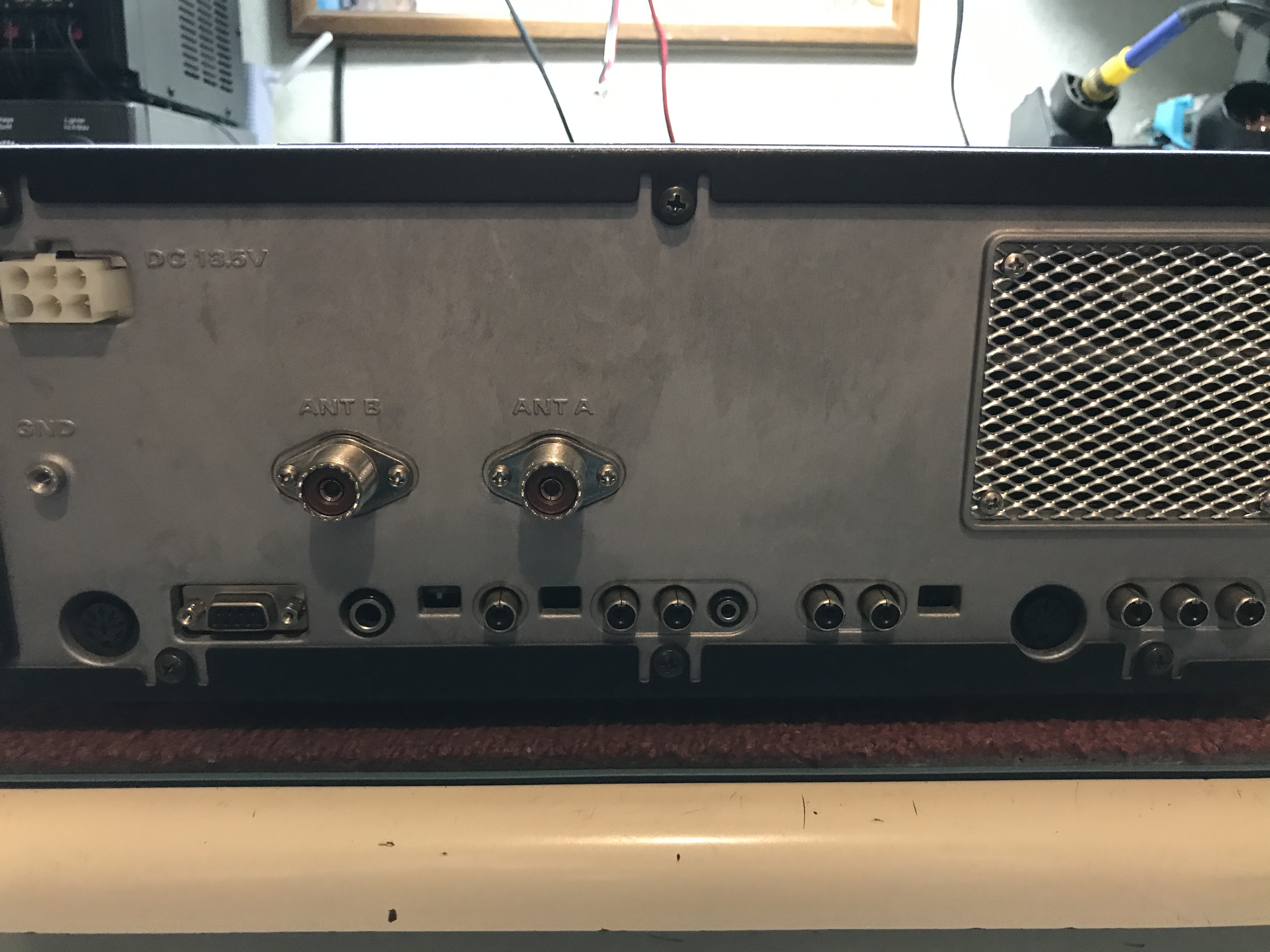

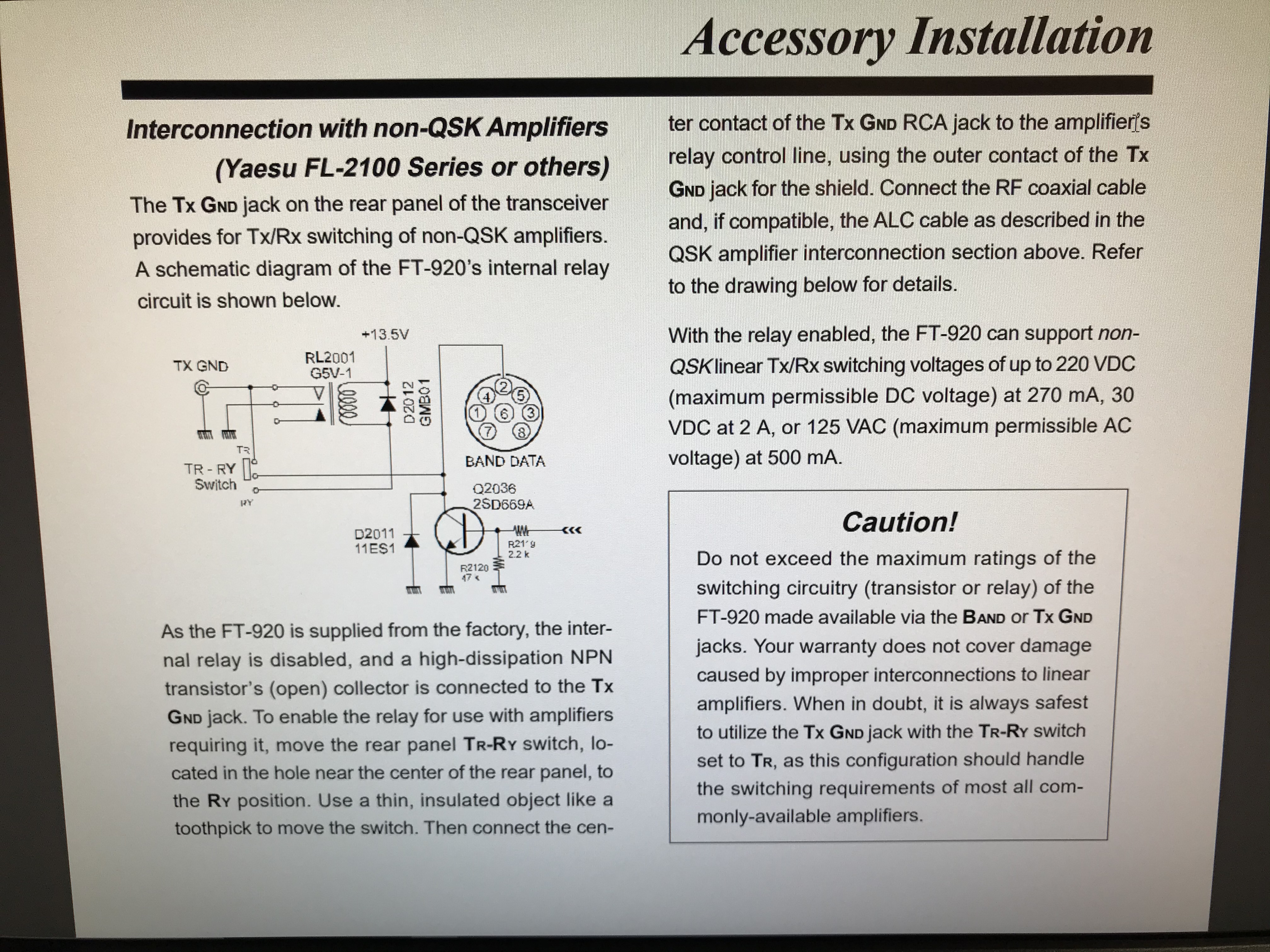

See manual on Radio. Relay must be activated with a switch . However I bet it's already done. The interface should connect to the DATA plug (8 pin din socket on back).(and 12 vdc power) Be careful to get that plug turned the correct way, it's keyed but don't wabble it in. You can easily bend other pins. You should be good to go, as I am guessing whom ever had it was using it that way. When you key the rig in AM (POWER turned down) and the amp pre-tuned to manual specs and in OPR, you should hear relay in the amp key. Should be all that is needed. I use a CW straight key and using CW mode to set power level at about 25 watts to tune the map. You can use AM (mic gain full down) and power level at about (Leave Amp in STD-BY till power level set correctly)
(9 O'clock on the RF Power knob) and go from there. See AMP manual about "DIPPING" the Plate. Just keep power level set low until you get use to the correct way to tune. Then bring the power up slowly till you see the proper level on the Grid current meter and the external wattmeter. The give it a Very quick "tweak" on the Amp tuning, and then adjust the power level back to correct output.

ok here we go, amp is conneted to the dummy load, on 10M. radio on ssb(rf pwr knob at 2:00 oclock) with 60 watts pep just talking ,making sure the signal passes:) the amp,now that the amp is on I see about 180-200 watts on MTA-20 meter from the radio shack and when I pushed the proc key on I saw 565 watts pep is this ok? So now I need to drive the amp with 60 watts to see 180-200 dk with a 565 pep. Grid current is about 115 ma,plate voltage 1.7kv and IP is about 300 ma. I think that this radio internally is pre setup for no more than 60 watts dk.:)
