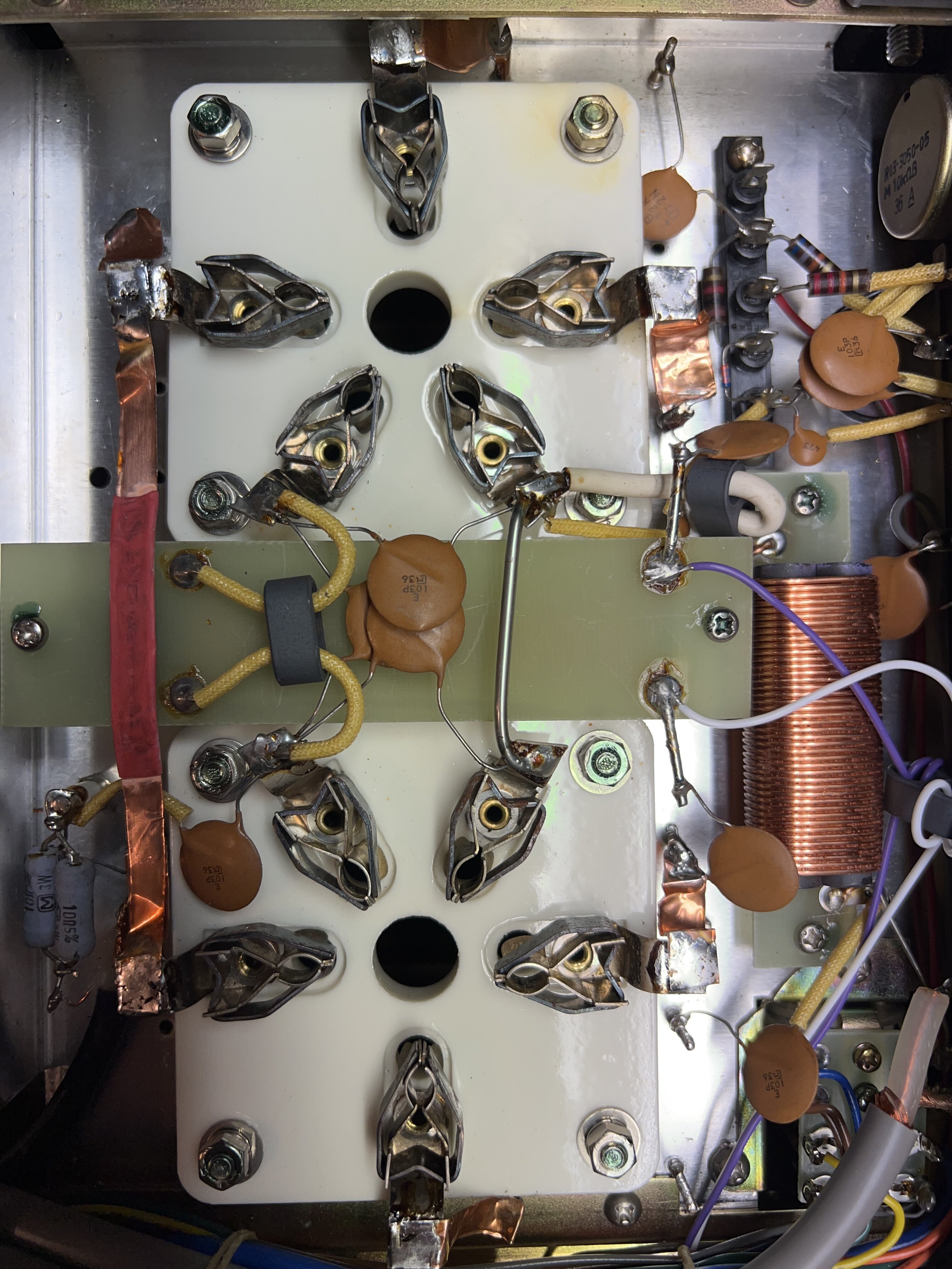

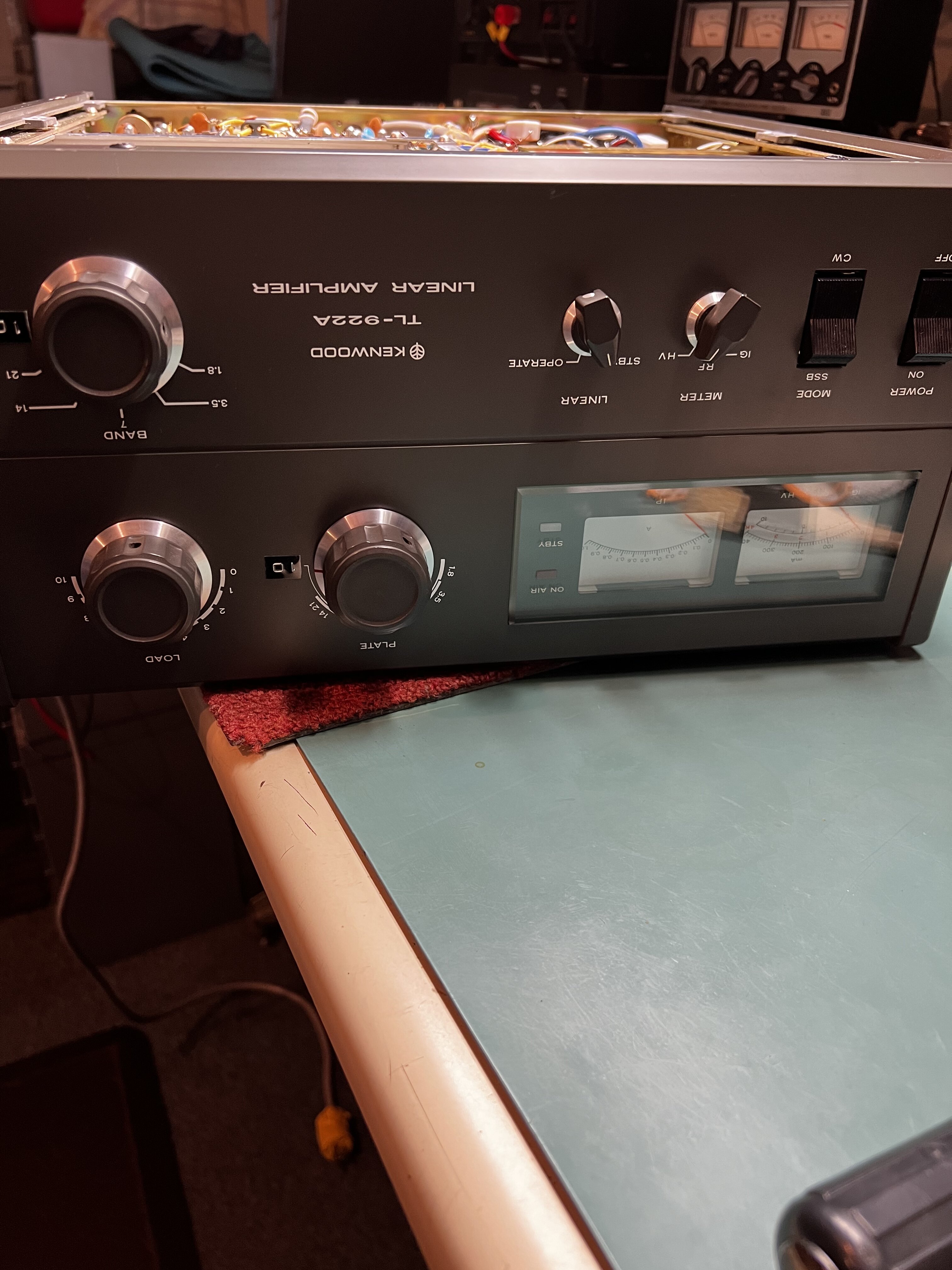

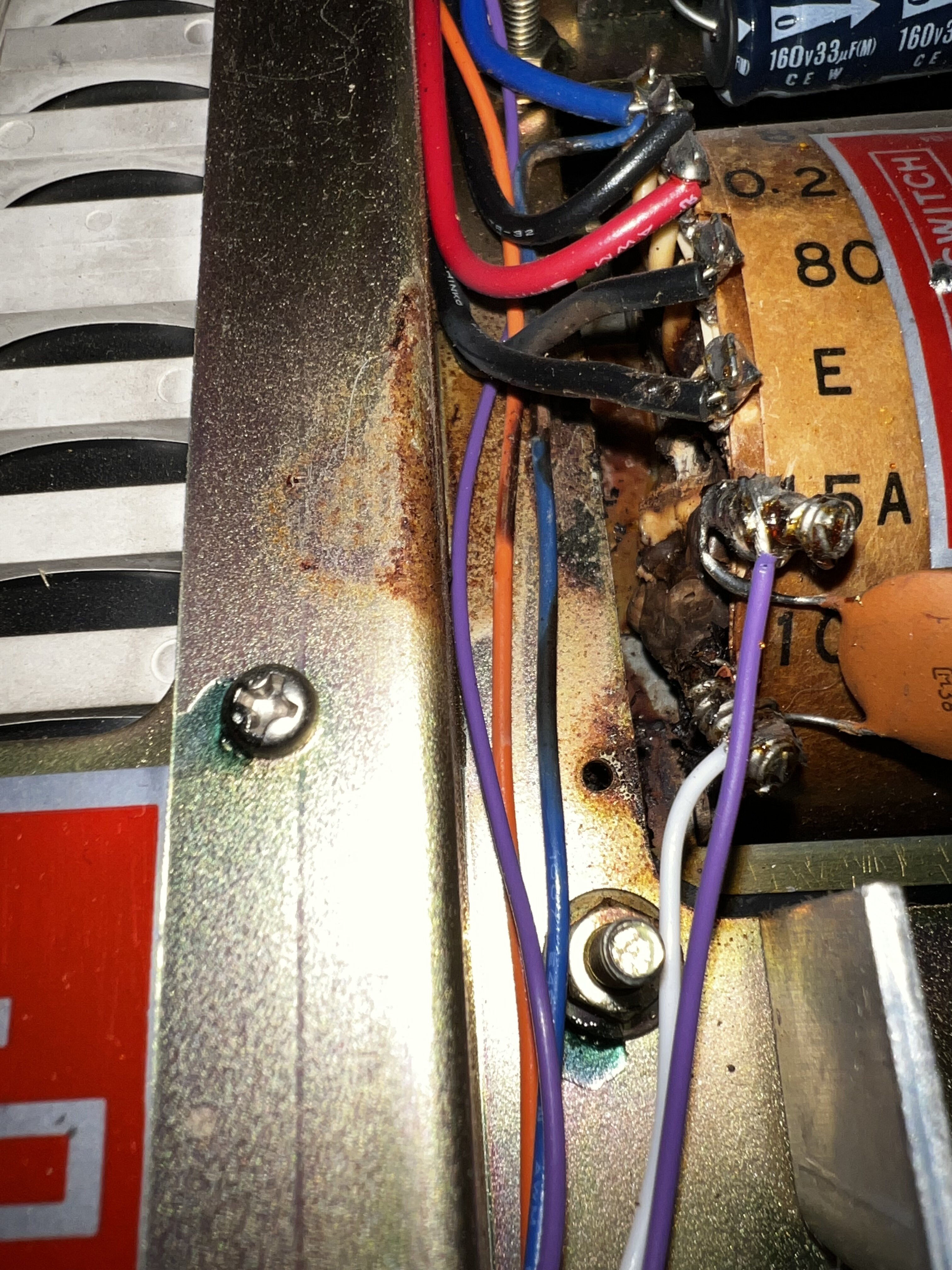

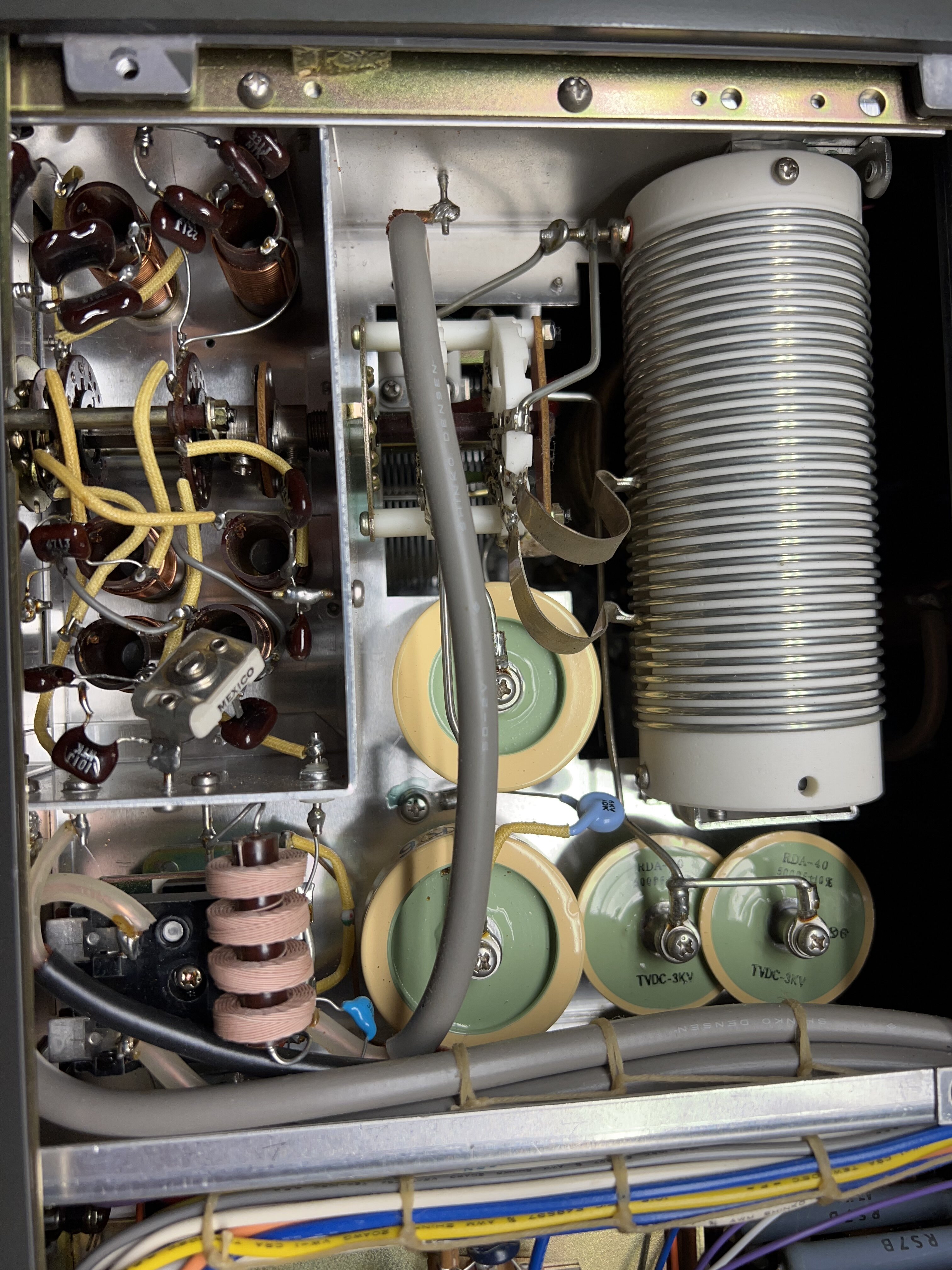

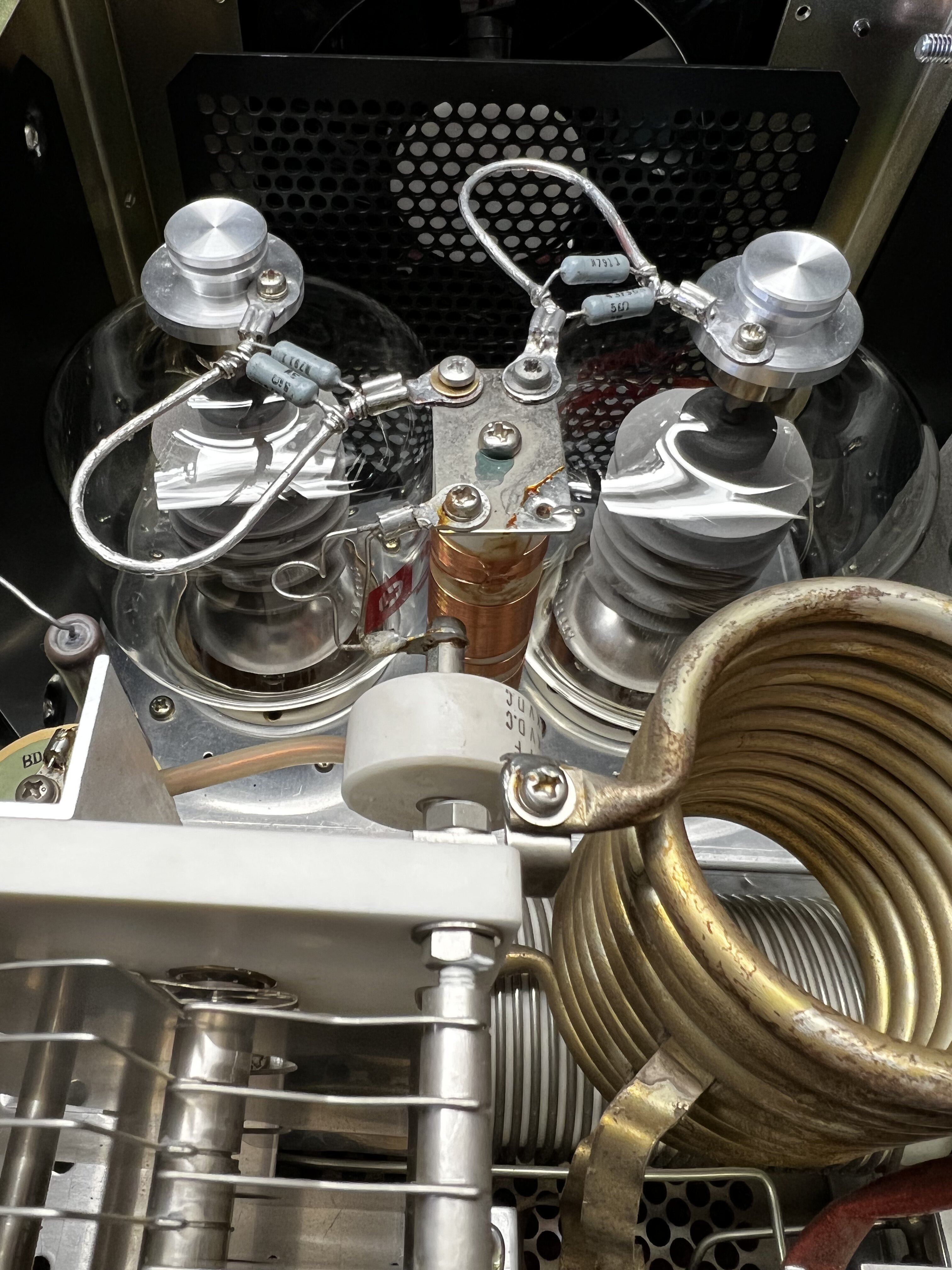

I just got a TL-922A and before booting it up I would like to know if any of you happen to see anything wrong with it. I’ll attach some photos below. 73’s

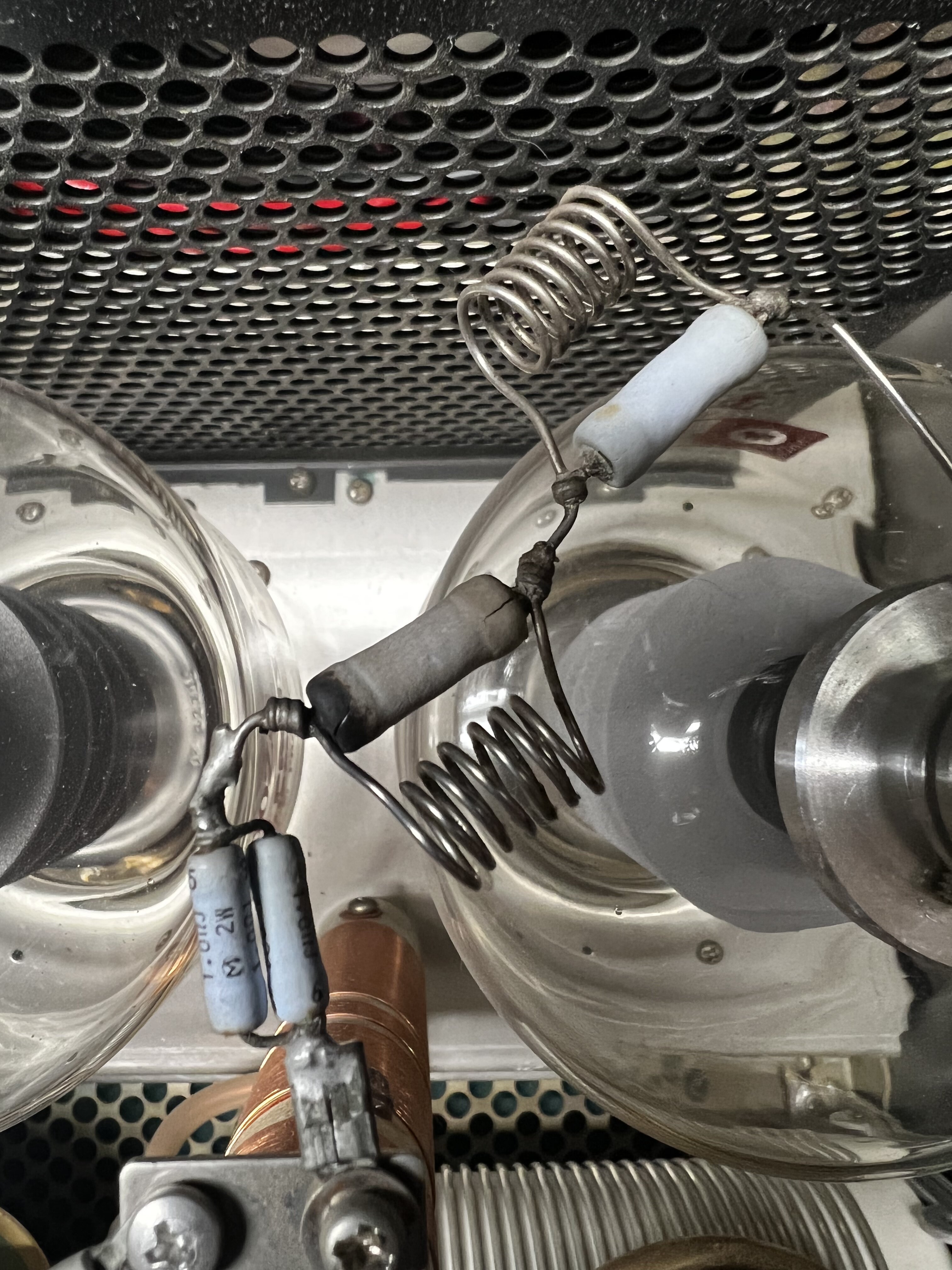

I would check the transformer that burned. Check the bandswitch contacts, especially on 10m. The resistors in the VHF suppression circuit on the Tubes look like they have been very hot. You didn't say how old the amp was. If the HV caps are old, I would change them and any other electrolytic. I would also bring it up on a Variac.
The NEWEST 922A's are 30+ years old... if it has 10m on the band switch (?) years old... These were made during the Hybrid Transceiver Kenwood Era.
The band switch is the weak link, the contacts were too small (Close together)

1st test turn on with 120v the picture one have 2.2Kv on CW, 2nd picture 3.2 Kv on SSB

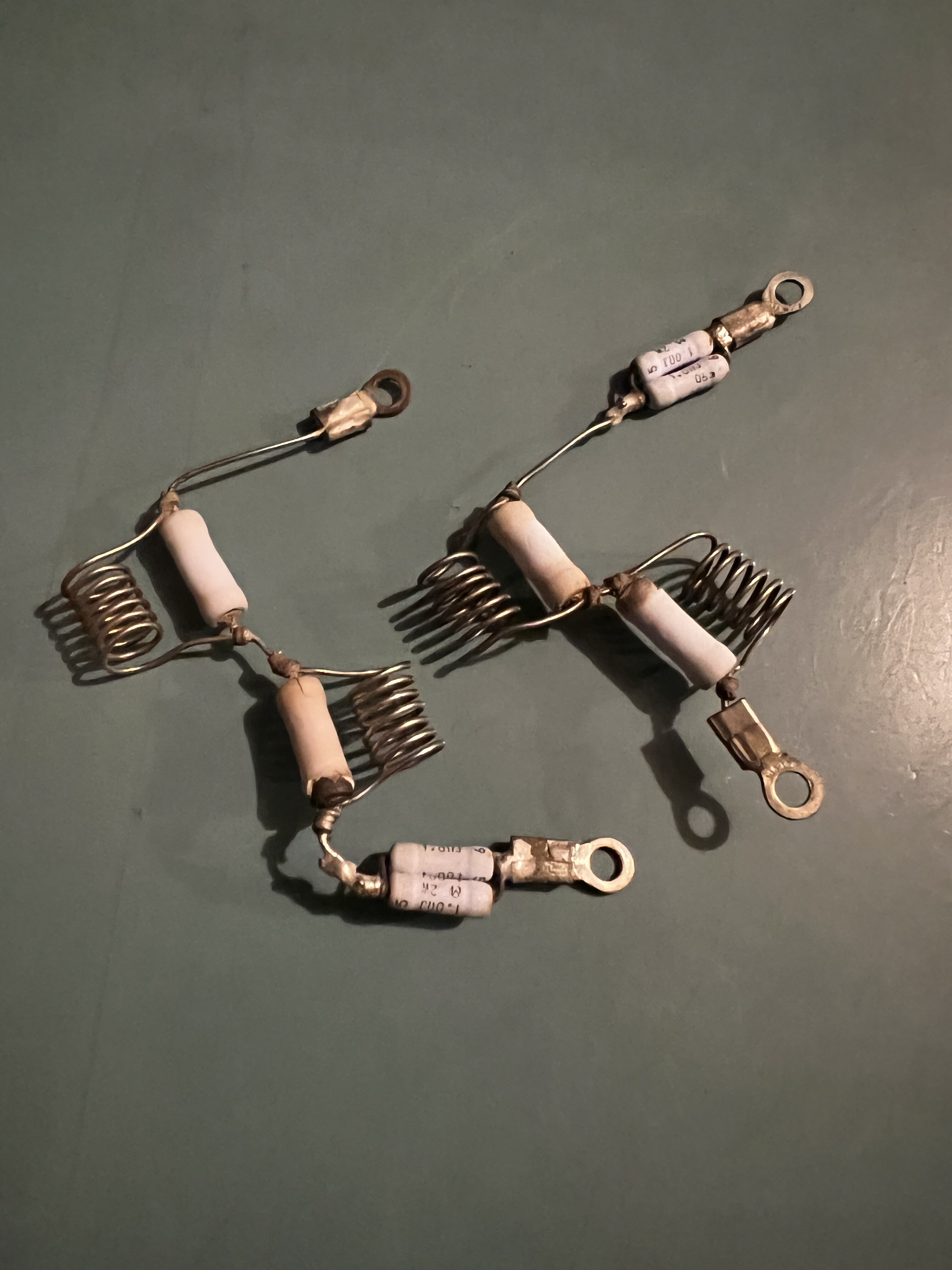

The parasitic suppressors on the tube anodes, are far from stock. The original carbon resistors are hard to find today.

the relay now is stock on RX, and also the parasitic suppressors on the tube anodes getting to hot, how can i fix that.

I think Tom/W8JI has recommendations for choke replacement. Hopefully those are getting hot due to the way they have been redone and have not been "rigged" because the amp is oscillating on its own.

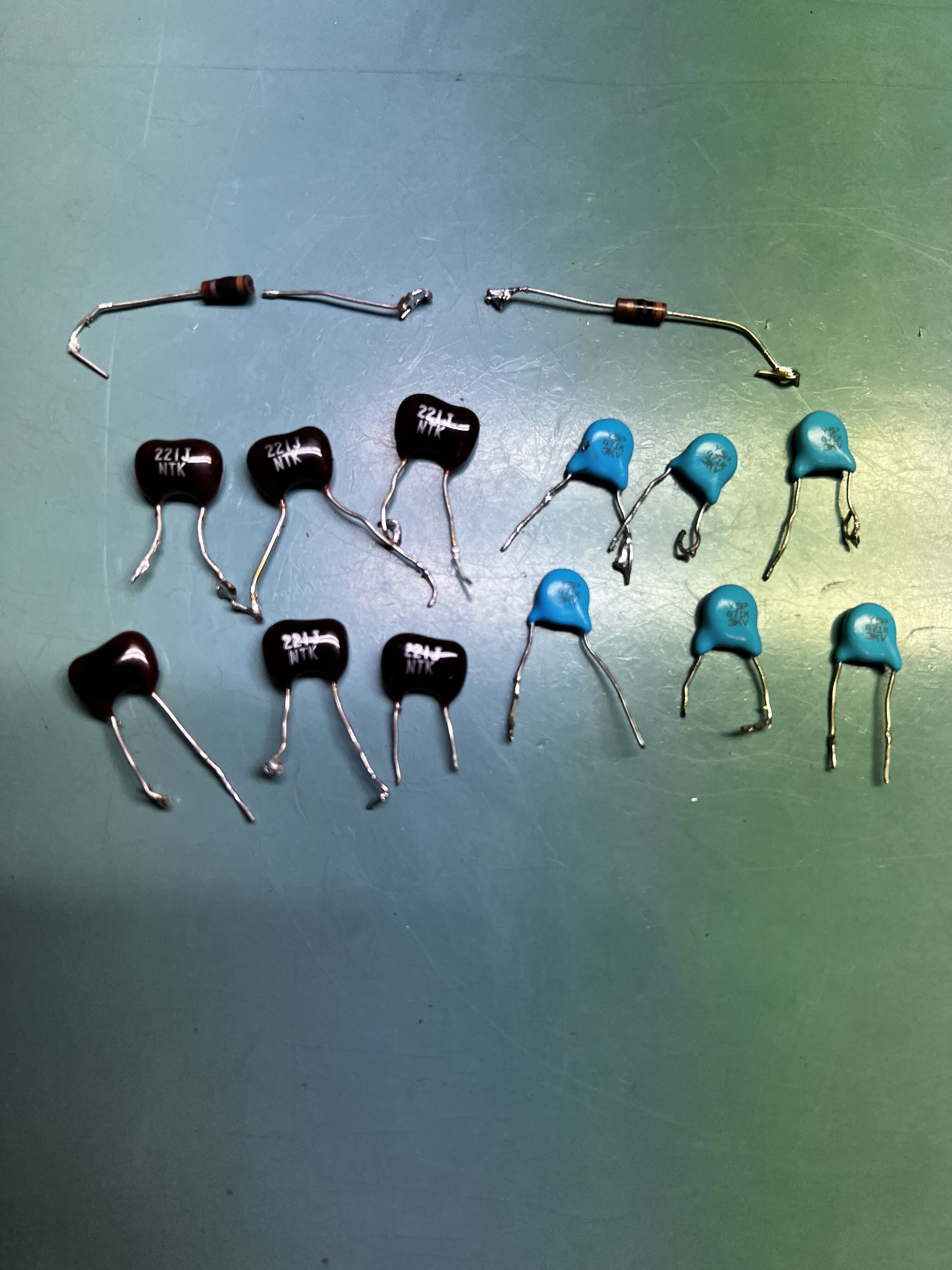

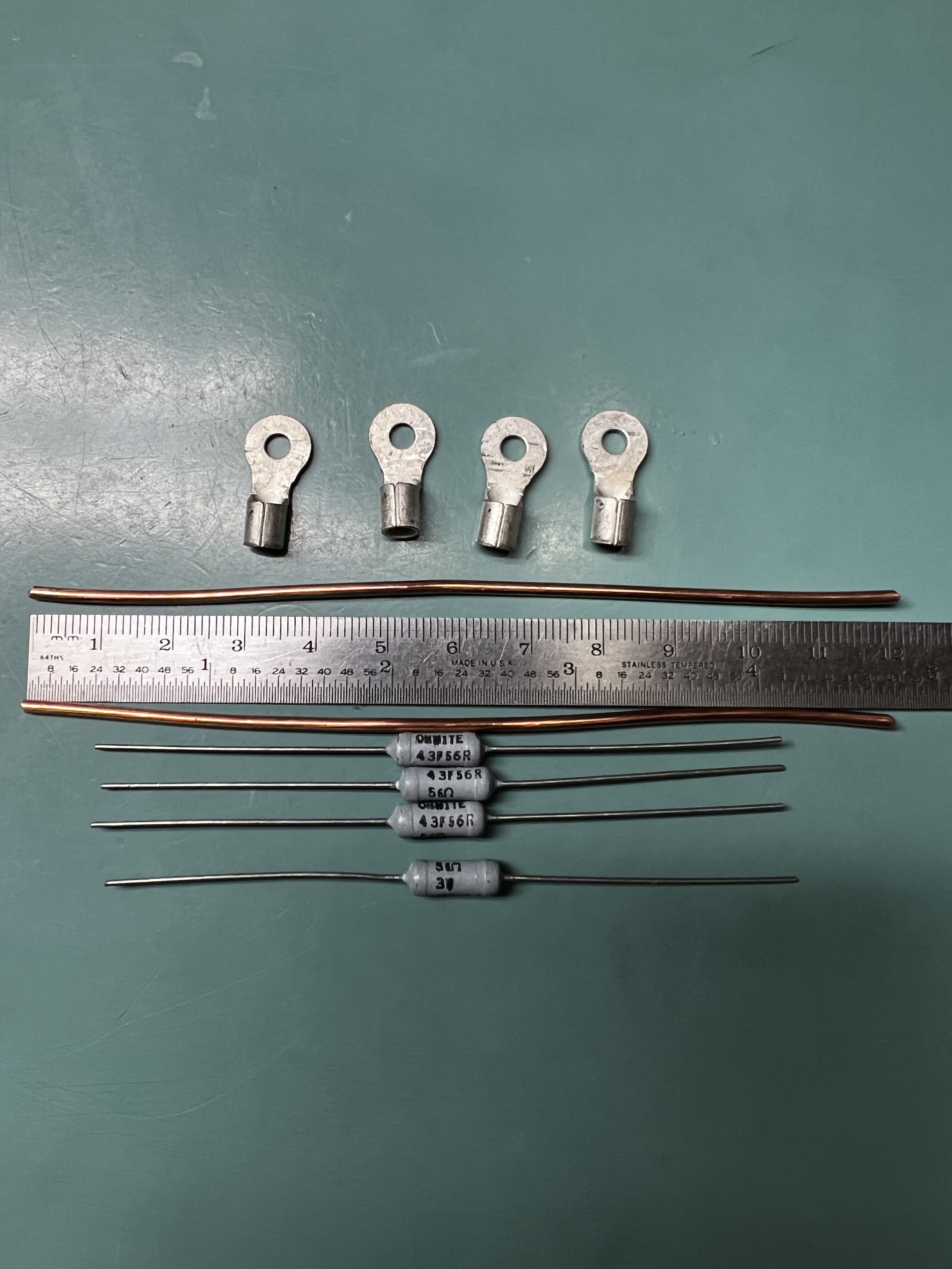

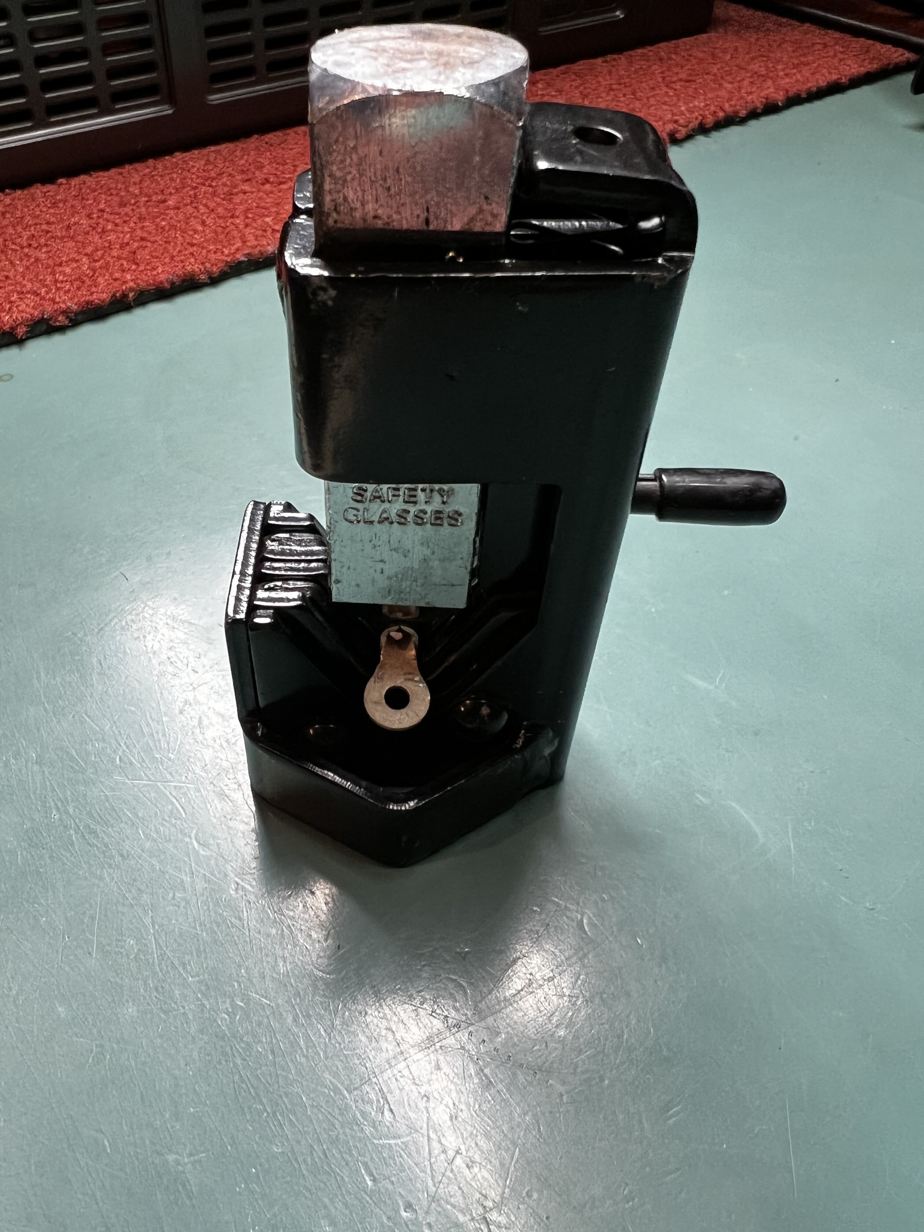

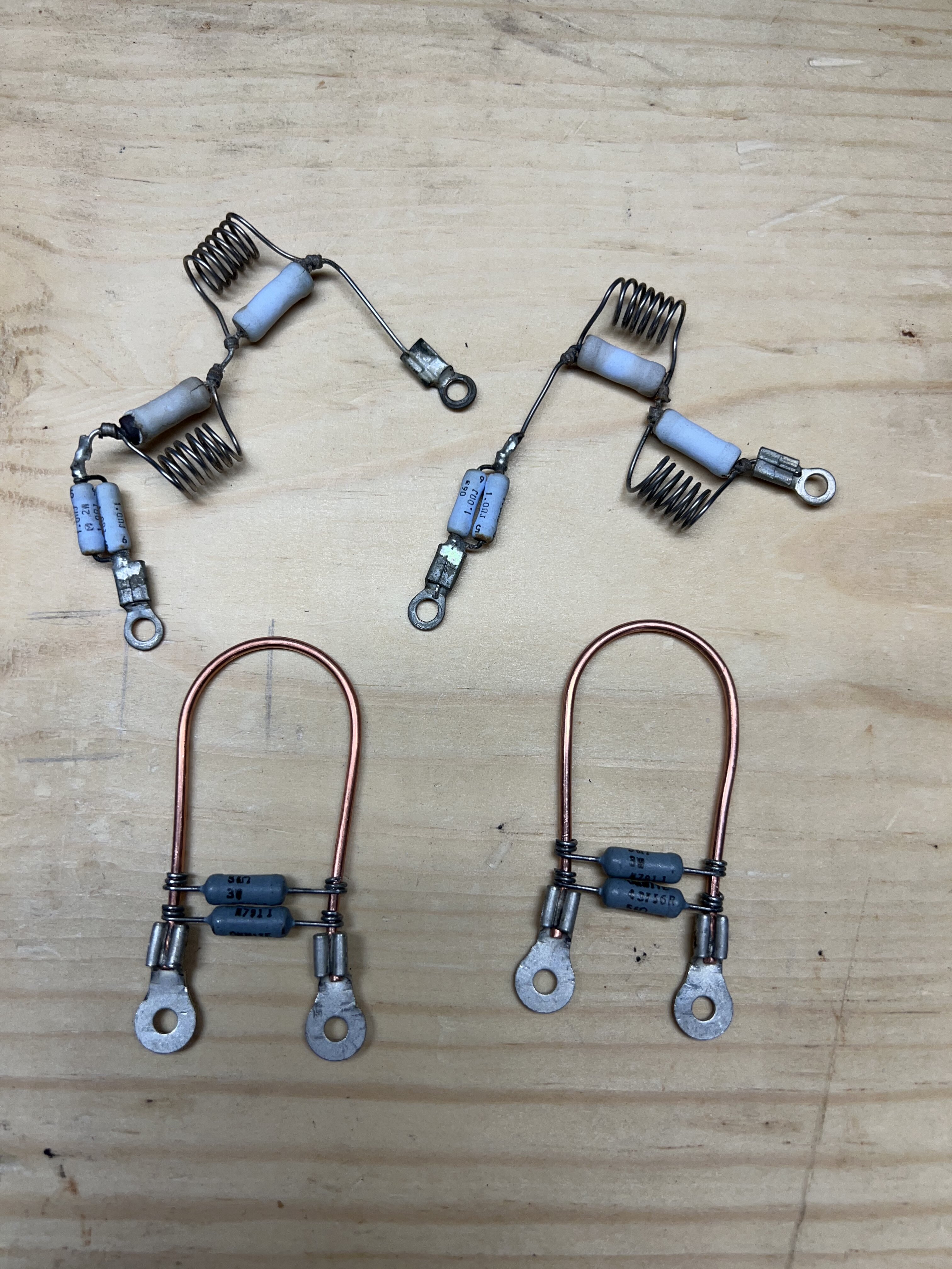

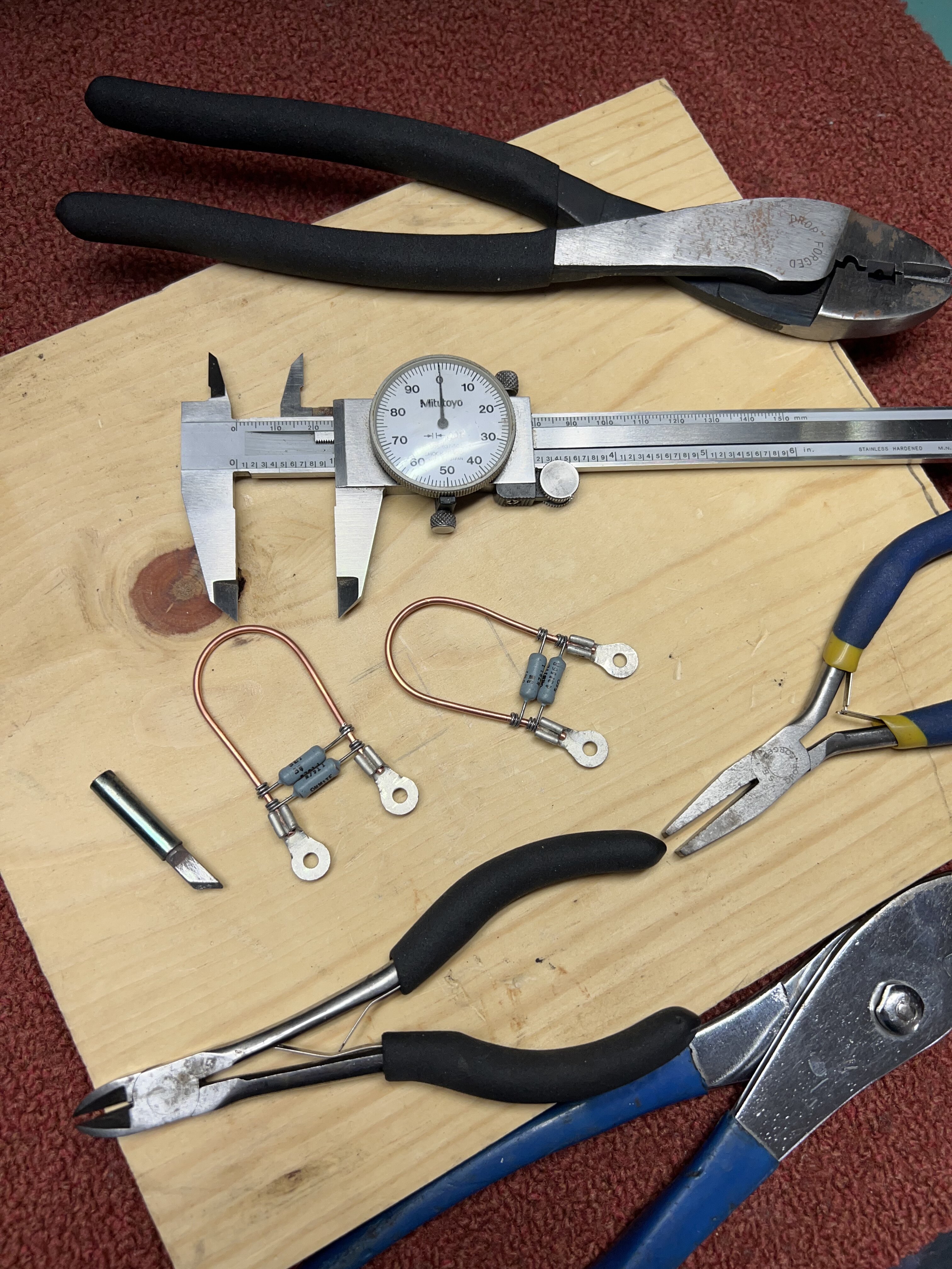

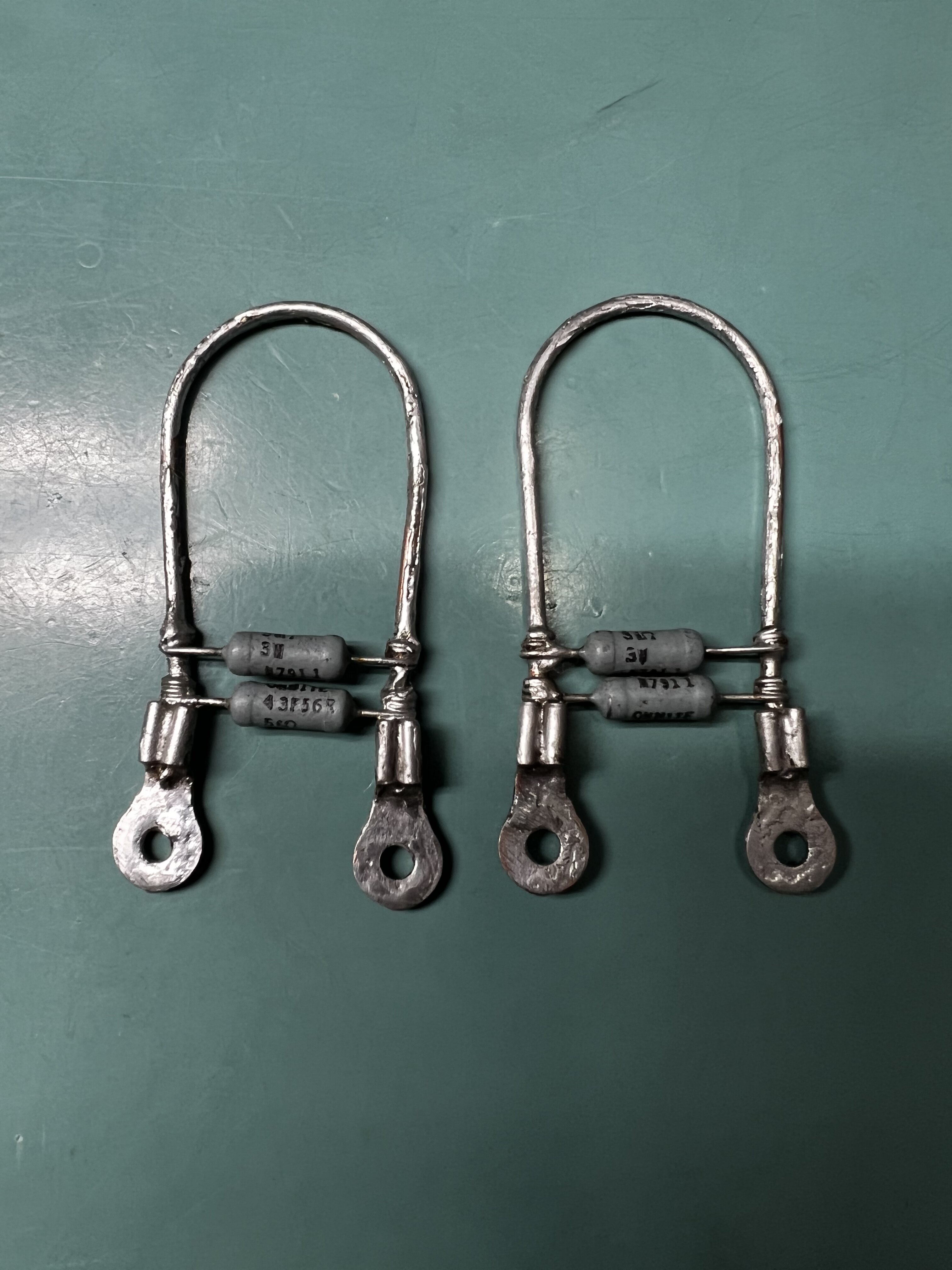

Getting ready to make The parasitic suppressors
Getting ready
Reactions: Shadetree Mechanic

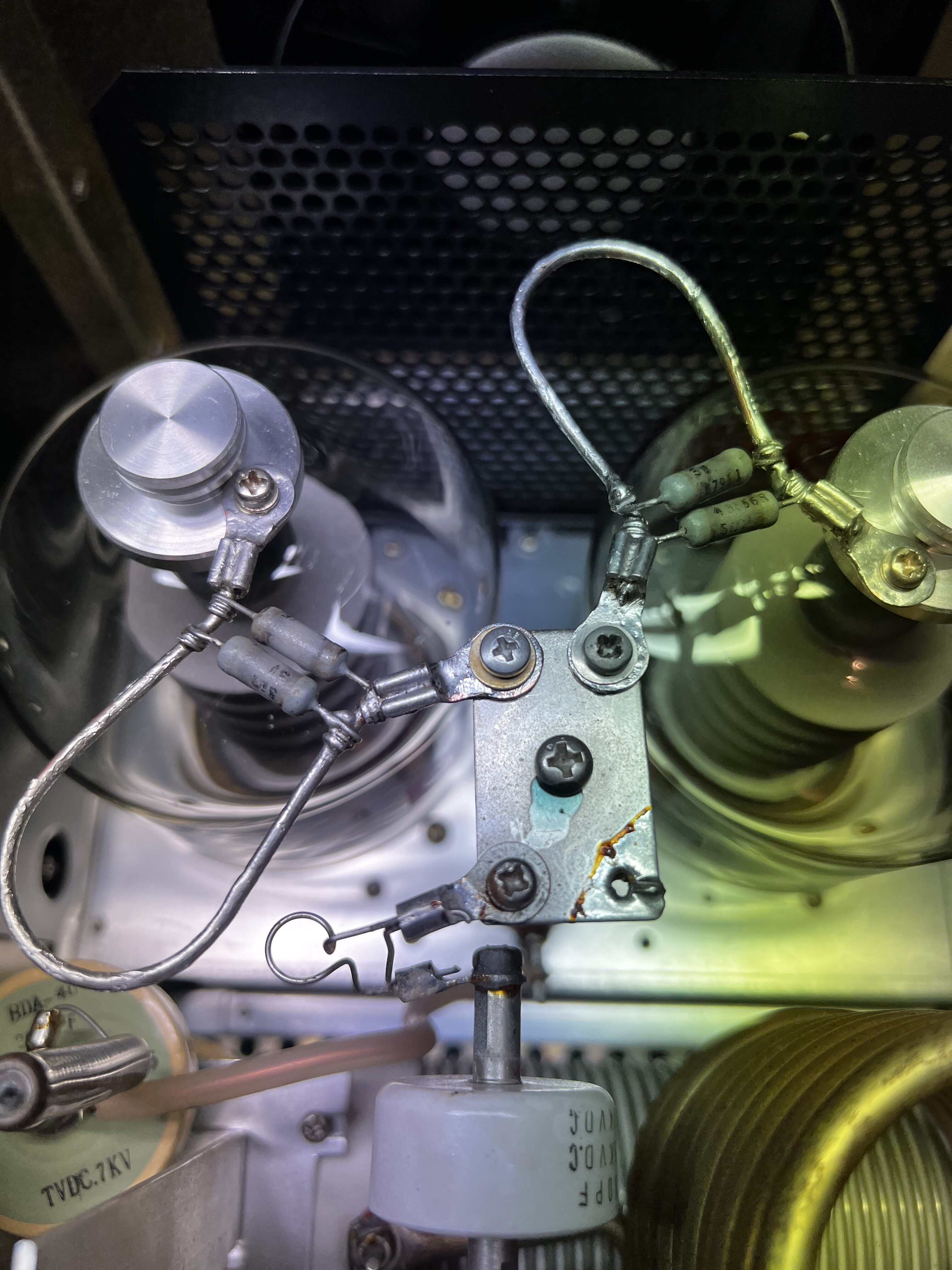

I was testing the AMPs on the dummy load with five watts only on CW and the parasitic suppressors on the tube anodes have burnt out again. Any clue as to what I should check or can do so fix this issue? The tubes are still functioning properly.
